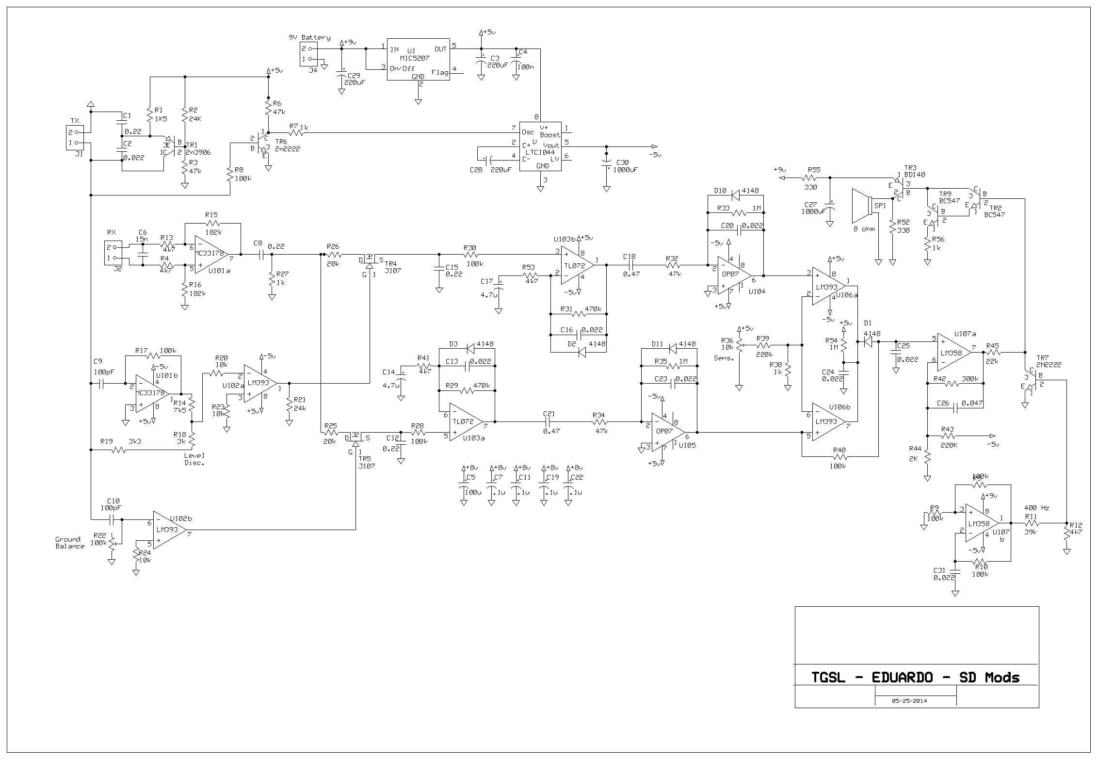

                              • My Bandito runs off a 9V battery. The TGSL is supposed to go deeper based on it's using
                                +8V and -7.5V from a 12V battery but mine doesn't seem to go deeper so I thought I'd
                                mod it to use one 9v battery. Some of the current draw is in the LDO 8V regulator so I'm
                                hoping to save some juice there. I also hope to remove some noise from the 4024 and
                                negative voltage generator. I found a MIC5207 laying around to make the plus 5 volts
                                and used a LCT1044 (similar to 7660) to make the negative voltages.
                                I stole the audio oscillator from the IDX by using the 1/2 LM358 available...
                                Here's a schematic of my current board;
