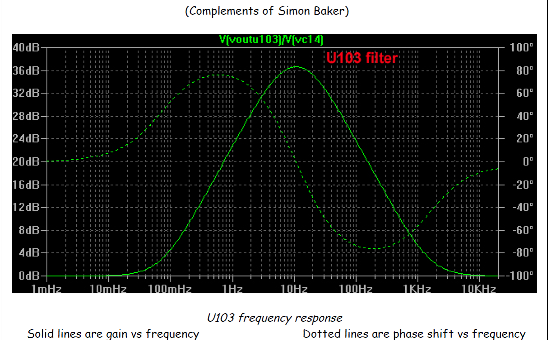

      • Hi Dave!
        There are differences between the two circuits without a doubt . I built two of each and noticed right away.
        The most important one is the overall frequency response, meaning the optimum sweep speed is different.
        When Eduardo first posted his schematic, Simonbaker ran a Spice simulation just to verify.
        Specifically, Eduardo’s version can potentially offer greater depths with a lower sweep speed. This is because U103a and 103b
        act as low pass filters with the gain and frequency response being controlled by R29 and R31 (which have their values doubled) and the values of C14 and C17 (which are larger).
        The screen shot below shows the “Ivconic” version, but for the Eduardo version, just imagine the frequency response curve being shifted to the left a few Hertz. This whole discussion is buried in the thread somewhere.
        If someone built one or the other, I would think that getting the most out of it is a matter of knowing the machine.

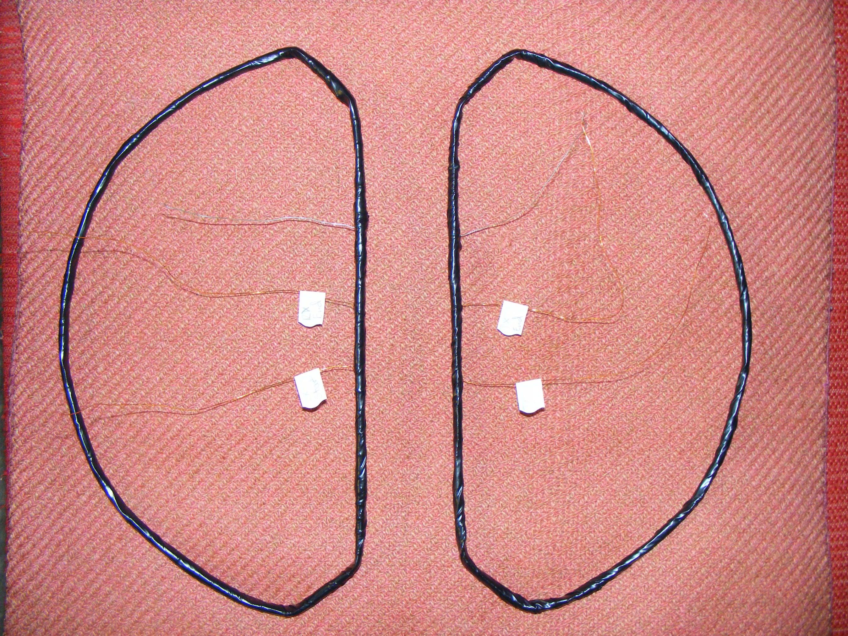

                • Dave, I ordered some graphite from your vendor. What brand and version / type yacht varnish did you go for.
                  Ive graphited plastic primer for my IDX worked well - albeit on three sides of the shell - recently added graphited paper ring to close the box. Working well if rather amateurish.
                  Ive got to pick a paint or varnish to do a concentric you see.
                  Don, I ordered 2 of these Im going to try placing them back to back..
                  8" diameter
                  I need a smaller coil you see that is good at getting rid of irno trash on small infested sites.
                  S
                    [ATTACH]24210[/ATTACH]
                    8" diameter
                    S
                    Hi
                    I don't think make really matters as originally was using Ron seal outside hard glaze but couldn't get anymore, but i do use Ronseal, if you find its running a bit thick just add a splash of turpentine which is proper ordinary paint thinners not the substitute type as Ive not tried it.
                    If you got any mix over after you have done your coils don't throw away , just put it in a sealed bottle with a splash of thinners and that will keep you going for your second coat after at least 24hrs which is all you should need.
                    Just remember that you wont get accurate resistance readings for at least 48hrs in well ventilated room.
                    8" coil works well in fact the coils I made for the TGSL which incl 12" DDs which were a bit unstable proberly due to seeing to much ground amongst other things for the TGSL to handle, there is very little difference between 10" and 8" far as depth here in uk soils beach maybe different, The 8" is as you say perfect for iron infested ground which we see plenty of here in fact is was the 8" coil I was using when finding the Gold ginney which was 45 degrees about 6" down which was remarkable because as you no or may not no there thin about the size of a 5 pence piece.
                    The Coil spec Ive been using have been same as the originals, which are 6.2mh/5.7mh using the 101 version with Ivonics preset mod on the TX which is good for final tweaking of nulling and EDU mods far as the 47k to 1megohms , cant remember the frequency of my machines as its been such along time ago.
                    All the best on your new permission hope its fruitful rewards, don't fall into the trap of to much discrimination with the TGSL, keep it turned on but backed right off and dig everything with 2 way passes even if its broken up signal on return sweep because otherwise you will loose the deeper stuff amongst all the iron deposits, better still get some pea sticks take a young lad with you and mark the dig gable spots with the sticks and let him do the digging while you carry on detecting, then his reward is when your knacked let him have ago.

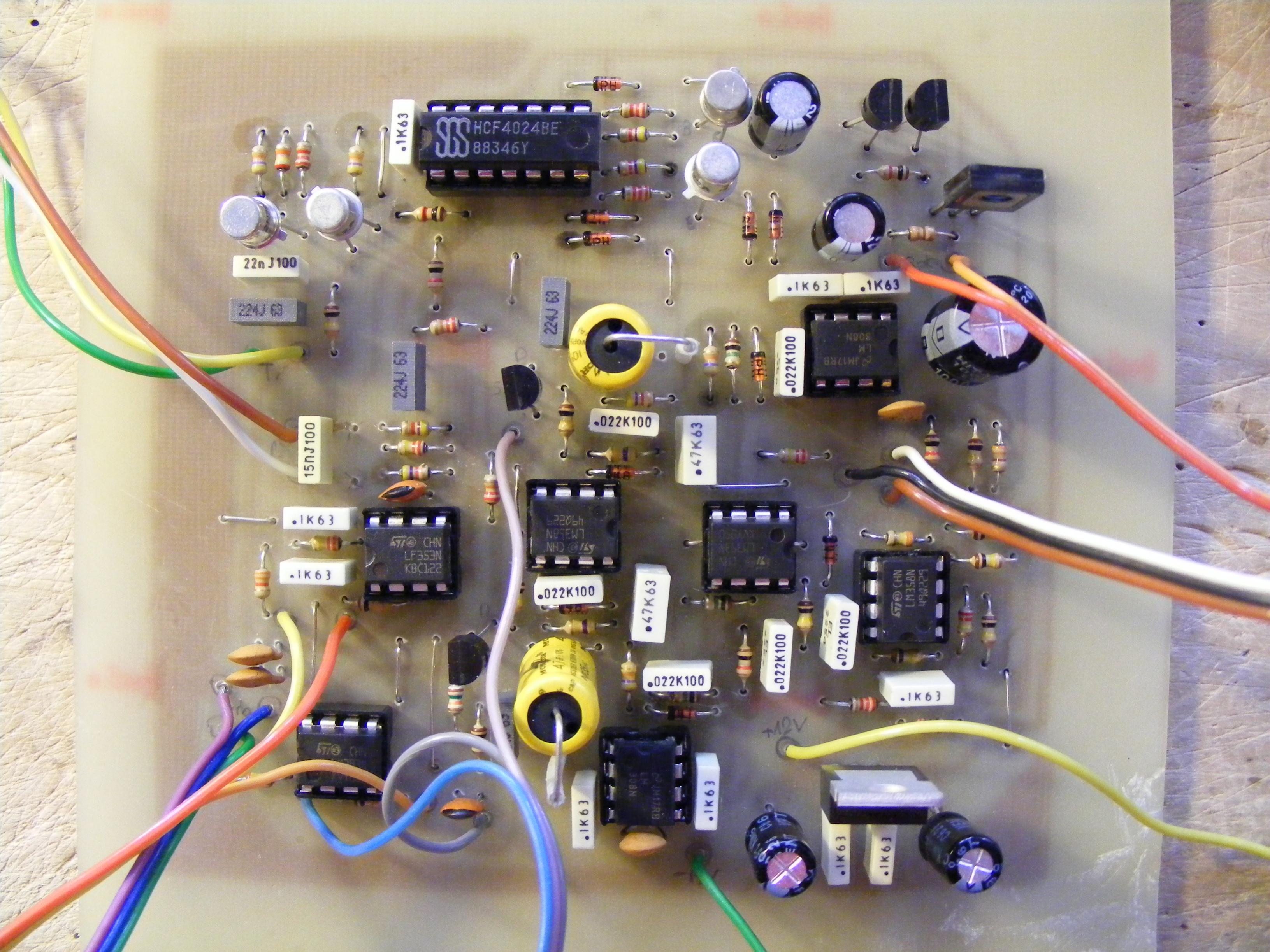

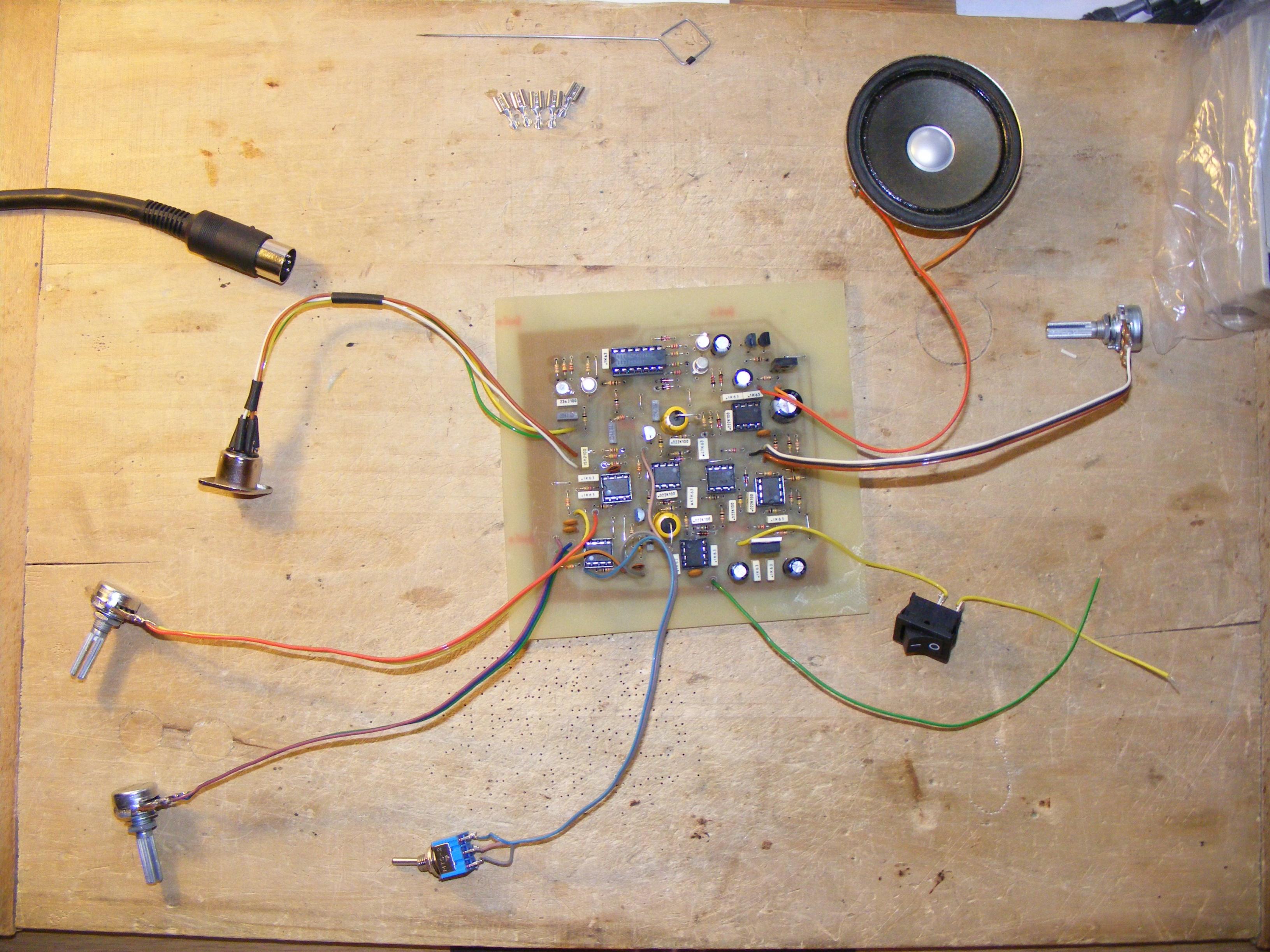

                          • Hi all!
                            I built the TGSL and there is a problem with it.When I touch the Ground balance or Disc level pot cable,have fail signal.Im paird the resistors and capacitors.
                            pls help (sorry for my bad english)
                            • Can you make a video to show us what is going on?
ID:	335910Click image for larger version
ID:	335911Click image for larger version
ID:	335912 here some pictures,soon i got the video.
