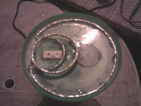

            i am just making omega coil for TGSL. TX is 21cm and rx 10.5mm. Wire is 0.25mm. I wounded 98 windings for TX and 167 wind. for RX. I founded those numbers exact to suit needed inductances: 6mH (TX) and 6.5mH (TX).
            Coil is not finished yet.Tomorrow i will apply f.cage (Al foil) and perform nulling. Later i will test it with TGSL to see performances....and of course report here...

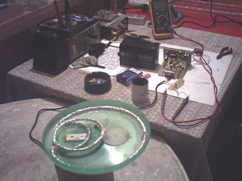

                    • OK, i got first,preliminary results;
                      first i have to say, nulling omega coil turned to be much
                      more difficult than DD coil???!
                      (Last time i made omega coil was for MD3007 and i didnt used
                      present method by measuring induced voltage in RX coil)
                      It need 1/10mm to drop to 0 volts or to jump to 20-30mV!!!??
                      After much effort somehow i managed to achieve excellent null.
                      At 200mV range it says 0.01...more than good!
                      OK, than i resoldered RX wires from miliviltmeter to TGSL.
                      WOW! What a stabillity!!! I dont beleive my eyes!!!
                      It is very,very stabile coil!!!! Superb over DD coil!!!
                      Discrimination is P E R F E C T !!! Perfec,perfect!!!!
                      Ferrite rod is absolutelly invisible for this coil even if i
                      lower GEB trimer much "down" from usuall value, usually trimmed
                      with DD coil.... Usually, when DD coil nulled well, there are some
                      mum "cracks" on ferrite rod with trimmer on 60%. I usually left that
                      way and later turns detector acts pretty well on soil.
                      But now, with this coil - not "cracks" at all! Trimmer at half - no
                      "cracks". Thin silver coin - yes, detected loud and clear!
                      Wow.
                      Ok, depth is lower than 27cm coil. 1 Euro coin detects very easy at 24cm
                      in air. 1.5cm nickel coin at 28cm.
                      Considering diammeter of this omega coil - 21cm, i think it is not
                      shallow comparing 27cm DD coil, not at all.
                      Next thing i'll do is to make 27cm Omega coil and than see real differences.
                      Bit now, i left out of wire, so this will wait for week or more.
                      But discrimination is really perfect. Large iron claws - absolutelly invisible
                      in disc mode.
                      What to say more? Need to finish it and than perform full test outdoor on the
                      real field.
                      Until than...
                      Regards Max!
