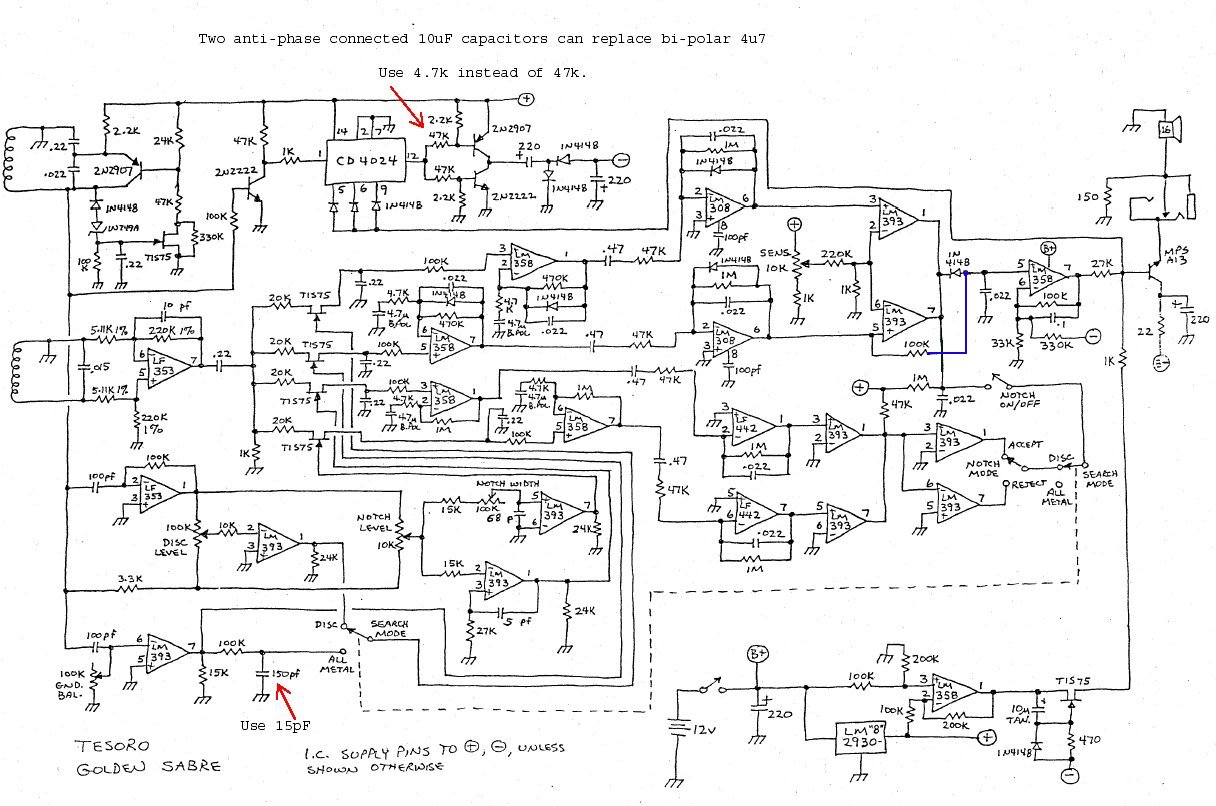

            • Hi Max.
              Are this coils connections ok?
              Nelson

                Hi Nelson,
                (used the zoom) yes they are! But I said to try reversing leads at rx... I mean that before you have to disconnect the lead connected to gnd wire and use the other with gnd, then the (now) free one alone to the circuit: swap the rx leads at coil level.
                Picture is right but doesn't say you nothing about start and finish of rx coil.
                Best regards,
                Max
                • So this is the right schematic ?
                  I think so!
                  Best regards,
                  Max

                    • Hi Max.
                      Ok, i think i found the problem with my coils. My connections to pcb were wrong. The leads that came from both shields of the coils, were connected not to GND on the board. In other words connections on the pcb were inverted for both coils. So yesterday i connected rigth and after that i tested my first coil that is not well made (3.4 mH and 4.2 mH; 16 ohms and 19 ohms, 22 cms diameter), but i got better results and gain btw 3 to 6 cms more.
                      So now i ll connect and null a copy of your 22 cms coil, that has good resistance and inductance values, to see what will be the results.
                      Nelson

                          Hi Nelson,
                          fine, so maybe was that the mistake on lead connections. The gain of depth is a good indicator that you're on the right way.
                          Keep testing... I know that sometimes could be a stress make lot of mods on coils, wound many etc but it's only way to get them work and really useful to make MD builder experience and skills. I think you'll get good results at the end.
                          Best regards,
                          Max

                                Yes, my connections were wrong (shame on me), and this means that my coils were tx and rx signal with the coil and of course the foil (WRONG). Now i m shure that the signal is tx and rx the rigth way, and the shield is really working has it was design (shielding).
                                I don´t know if i ll have the time to work today on golden sabre, but saturday for shure i ll. Weather for this weekend looks fine, so after i get the 22 cms coil working, i will go outside to make some field test.
                                ohh i forgot, when you place a coin close to one side of the coils, is it normal to detect it? i ask this because when i connected the coil the wrong way, all kinds of coins that where close to one side of the coil, were detected and this confirm my idea that the tx signal was radiated by the coil and also the shield.
                                Best regards and thanks to all for helpping me to get this nice machine working.
                                Nelson
                                Hi Nelson,
                                Best regards,
                                Max
