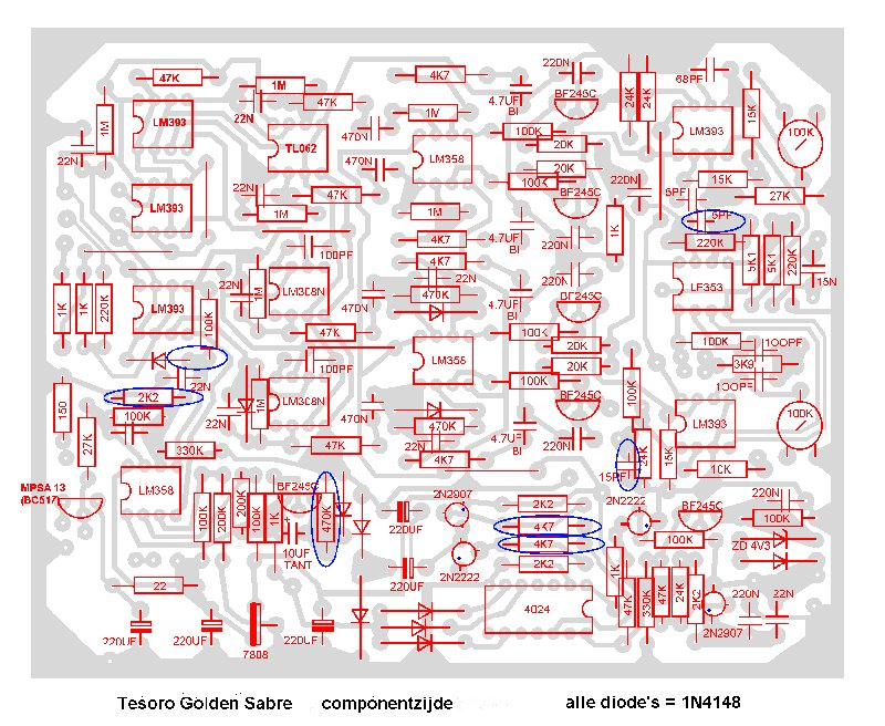

  • Hi all,

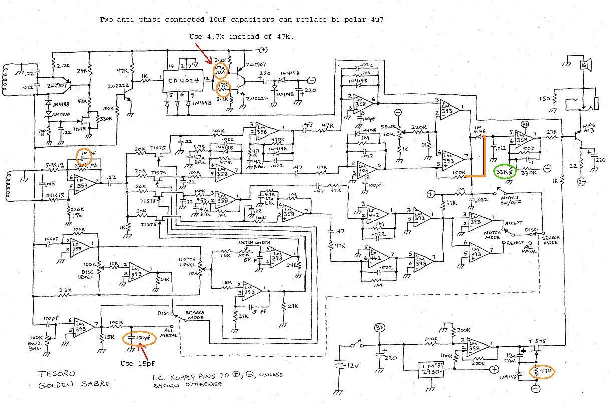

    found another difference from schematic to PCB !
    How many! Why ? Who knows ?... but it works good... so nevermind!
    Difference is:
    in schematic between pins 6 and 7 of LF353: cap =10pF
    in PCB same cap is instead =5pF
    Kind regards,
    Max
    Here is the map of misteries...

      Hi all,
      Difference is:
      Kind regards,
      Max

          Hi Nelson,
          I've done modifications of component list as indicated in an above post.
          But just for active devices and some spare:
          - 4xBF244B in middle section (sampler) instead of BF245C (changed pinout of to-92)
          - 2xBF245C in battery checker and osc section
          - 1xLF353 as preamp (but tested others)
          - used 2N3904/2N3906 instead of 2N2222/2N2907
          - 1xTLC2262 instead of TL062
          - 1xC517 (not BC, but it's the same stuff, pinout etc)
          - 1x8ohm speaker
          + 2xTL081 instead of LM308
          Just these of above, not resistors or caps or diodes. I followed the PCB labels, so mounted e.g. 5pF between pin 6 and 7 of 353, not 10pF as in schematic.
          Change e.g. of fets or bip.-transistors if not a big change really. About same thing. LF353 as preamp. as described, and just 3 IC mod (tlc2262 instead of tl062, 2xtl081).
          So don't worry. About the same.
          Best regards,
          Max

            • Hi,
              I think that there are just few relevant things in that differences I described in the schematic using green color.
              I think most important is that capacitor between pin6 and 6 of 353.
              If you change values of this you have different freq. response of preamp.
              I've mounted 5pF, like in PCB-chart, but I'm a bit puzzled and think that maybe correct values is 10pF for it. I'm not sure... of that, and also side effects could be really small for real.
              But I think it is in a really "hot spot".
              Also the 33k resistor that is 2K2 in PCB is not a real "error".
              What to say... maybe it was 10pF ! But my detector works fine with 5pF!
              So I'm not worried too much of this...
              I'll check it, anyway, in next days.
              Another funny thing is the 470ohm in schematic that become 470K in PCB,
              at battery checker.
              Best regards,
              Max
              PS: a big mistake was the 150pF cap ! But already corrected much time ago.

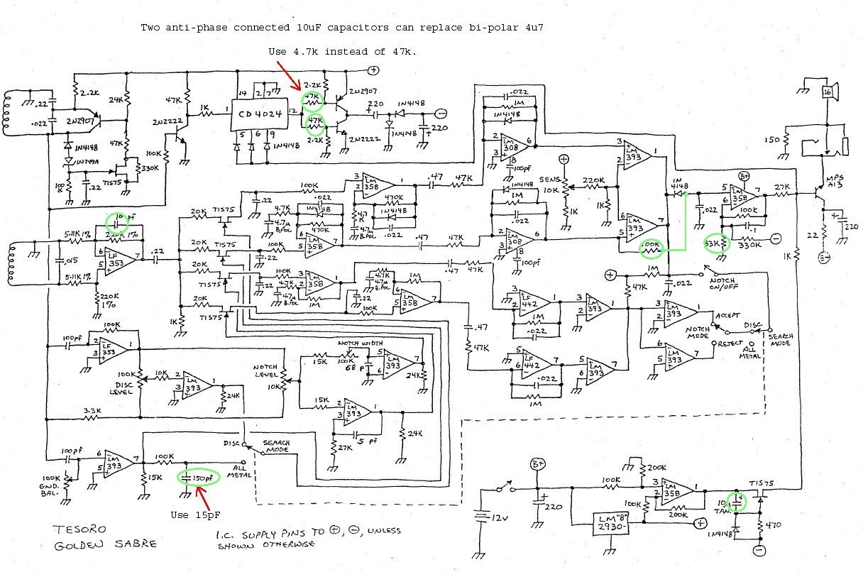

              • Hi,
                yo make things more clear, the differences you see:
                - red : what I consider real mistakes, that could affect circuit working (or part of it working as expected e.g. battery checker)
                - green : just a mod. for tuning and not really a mistake
                Some mistakes are in schematic only, like 150pF and resistor connection to diode, or 47K resistors... others are in PCB (e.g. 5pF instead of 10pF) but I've indicated in schematic to have a reference there.
                Best regards,
                Max

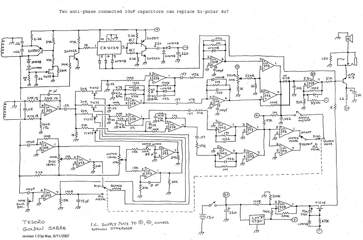

                      • REVISED FULL SCHEMATIC
                        I've changed the wrong values and revised full schematic, according also to the "GSabre light" values.
                        If someone will find any new error or mistake, please post here.
                        Kind regards,
                        Max

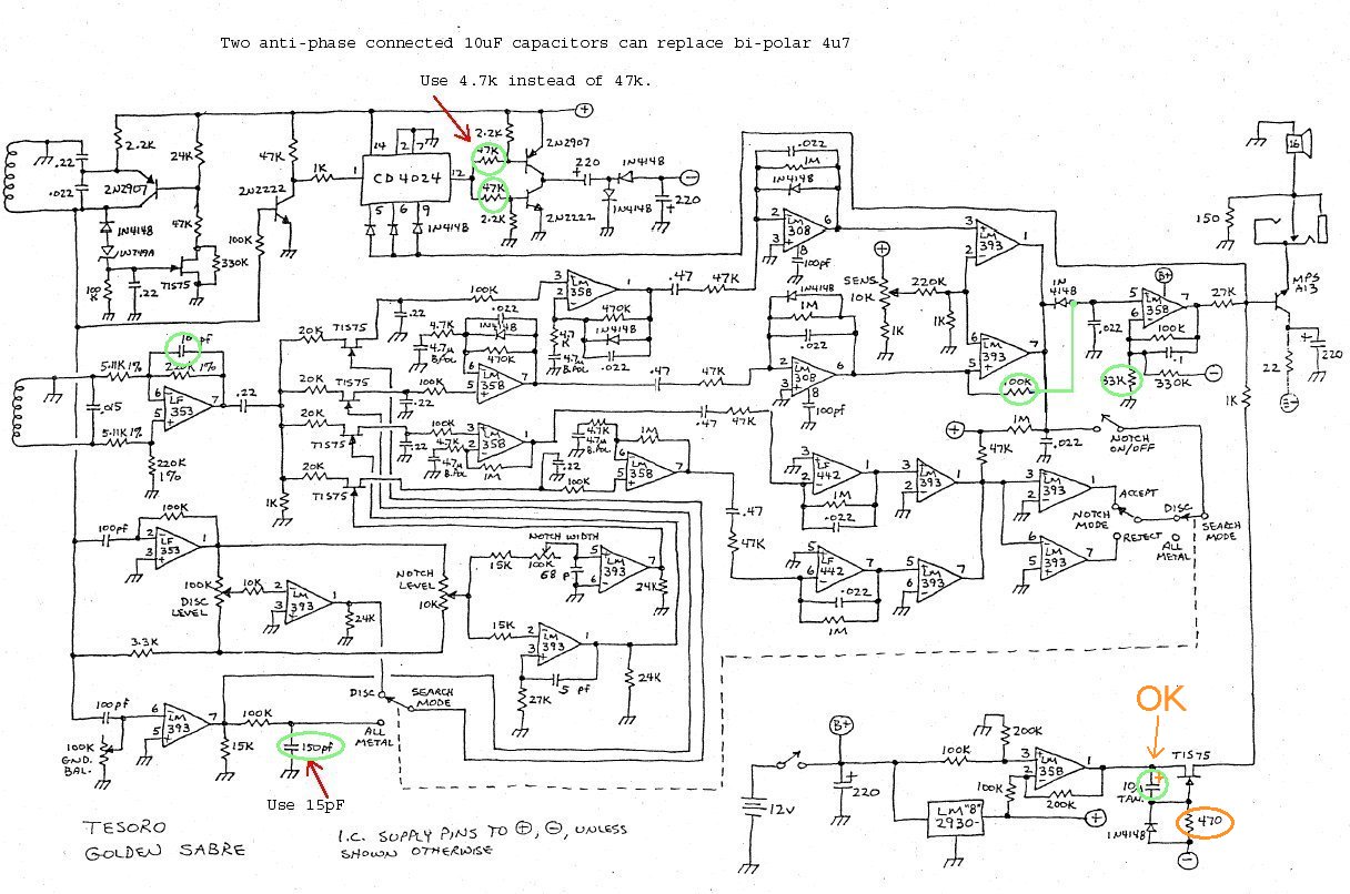

                        • About the 33K resistor and all the story
                          Hi all,
                          I've replaced the 2K2 resistor with the 33K that is indicated in schematics and lose some audio! (as expected)
                          Just small beeps when coin is near 26-27cm from center of coil... almost weak and unuseful... and one could miss much targets that way.
                          The gain reduction is not good if you want detect stuff at depth.
                          Then unsatisfied of result I've put a 1K resistor instead of that 33K... and wow it's singing BUT there is some small instability due the too high gain.
                          So I remounted the 2K2 as in the PCB drawing.
                          I think that the 1K is ideal if you can keep detector stable (somehow) and avoid bleeping.
                          The AD712 could save the day but I haven't ! And can't test.
                          I think that I gained 2cm with 1K instead of 2K2...
                          then mounted NE5532 instead of LF353 but lose some depth (1-2cms)!
                          With again LF353 too bleeping convinced me remount the 2K2, at least for now.
                          BTW changed also the 5pF cap with 10pF... and results are the same.
                          So no need to change it at preamp (LF353).
                          Best regards,
                          Max

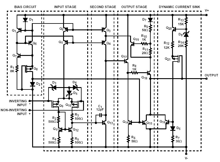

                          • Hi,
                            Max.
                            What you think about CA3240 insted of 353 or:LM358D ;LM2904 ;LM258N?
                            Plese help!
                            I will have 353 after 2 weeks!
                              Max.
                              What you think about CA3240 insted of 353 or:LM358D ;LM2904 ;LM258N ?
                              Plese help!
                              Hi tiktak,
                              I think positive of it (CA3240) cause seems good.
                              1.5TΩ mosfet inputs... seems fine. Problem is that you have to test in circuit to say that's better than TL072.
                              Other things for me aren't so good, btw 158/258/358 are about the same stuff.
                              LM2904 seems about a step above 358, no good here.
                              I get less bleeping with NE5532 but lose performances... (probably cause of input stages) so I think your CA3240 could be good alternative for 353.
                              Buy one and test.
                              Kind regards,
                              Max
                              PS:
                              Not too seem too techical but... from what I see seems good as inputs, very good (look at Q9, Q10 config).
                              I think would be nice instead of 353.
