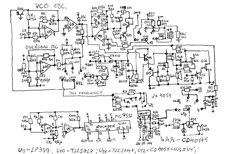

        • CZ5 VCO SECTION
          Hi ivconic,
          you mean this ?
          Seems possible to realize... but maybe 8038 is easier to do respect this.
          Note the rotative selector: different inputs for different audio purposes.
          Best regards,
          Max
          PS: do you see where there is D0, D1, D2 ? Audio stage is in syncro with sampler (MAX333) to avoid jitter... that way it get tones for successive operations in the VCO... kind of a mixer.

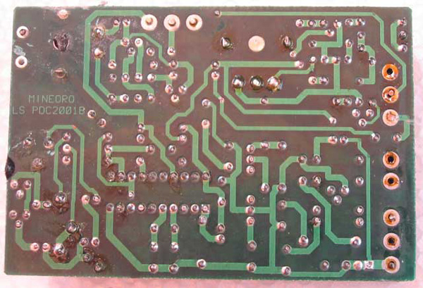

                  Nelson have you removed flux , right ?
                  Flux removal is mandatory in this kind of stuff.
                  • How do you remouve the flux MAX?
                    Its look like TGS have made you crazy like us.
                      Hi
                      are you Nihil ? Still playing with flux ?
                      I always remove flux, even if not required.
                      In any VLF detectors you have to do. And is always good practice.
                      Or you play with toys and LRLs ???
                      I use solvents, brush and also cotton (depends) for little things like GS.
                      I found that best to do is a bit more complicated (but extremely good for smd):
                      ultrasonic wash in solvents but taking care that upper side of circuit is not involved. Surface waves remove all residual flux... but problem is that once used you can't reuse same solvent, and you need much so it's not indicated in a single homemade pcb work like this.
                      Solvents are mostly: tert-butyl alcohol, isopropilic alcohol, acetone (but not so good for copper), trichloroethylene (more toxic of others).
                      All are good using ultrasonic waves... but if you treat also top layer you'll lose ic numbers... have some plastic melt
                      You have to use a suspend "bridge" to avoid immersion of board for more than 1mm in solvent.
                      For GSabre I've not used ultrasonic cleaning but just trichloroethylene some cotton and a tothbrush(outside) (and a Clint Eastwood's cigar , of course).
                      Best regards,
                      Max
                      PS: here is an example of bad flux removal (or no-flux-removal at all???)
                      another mineoro's masterpiece: ENJOY
