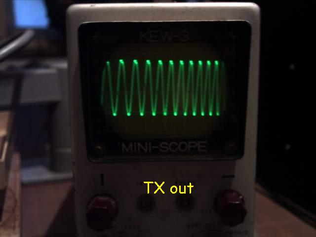

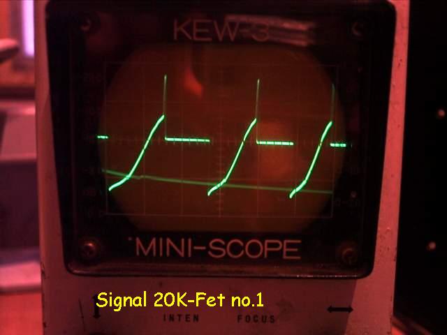

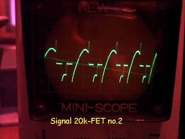

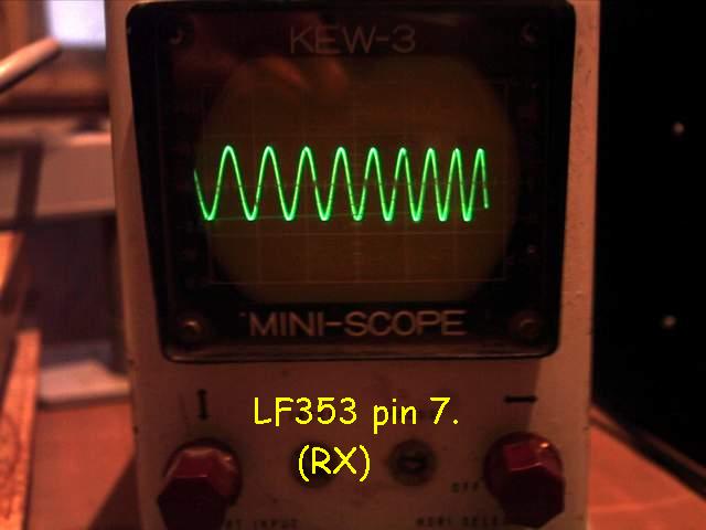

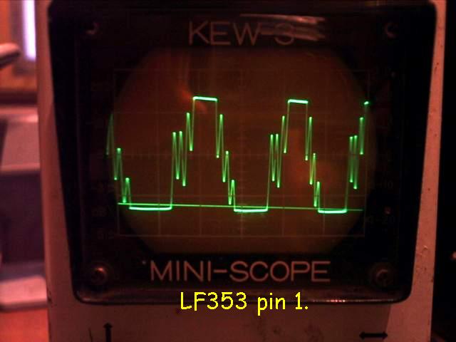

                            • So i listened Quiaozhi's suggestions...i played arround KOP's hysterezis....not even close! Same behavior...!
                              I decided to take shots from some oscilograms....Yes i know; my osci. is obsolete and funny...yet here are some shots...
                              Only thing is not clear to me is osci at 1.pin of LF353?????
                              • Max can you scope your LF353 pin 1. and post it here?
                                Something is "misty" here???
