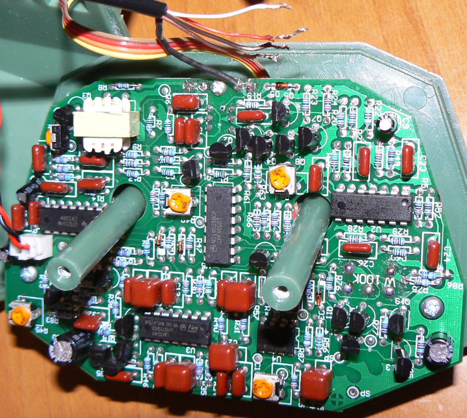

                        • Pretty "pictoresque" should be my next story. I will spit on some detectors here...but hey! That's life!
                          So story goes on...
                          This summer i had chance to fully test majority of cheaper metal detectors made in China. Except Black Knight, all others could be considered as object of one and the very same experience...so;
                          Coils are made in pretty well cosmetic manner. Looking nice and hi pro.
                          Yet all coils i have been seen are .....take a deep breath....without any Faraday Cage or simillar !!!???? Ha,ha,ha!!! What a spiiiit!
                          This HUGE drawback showed fully on real soil. Absolutelly unstabile and therefore unuseable totally in any descent work. Who ever told you different story, you may consider him as a fraud and liar!
                          So....next drawback is ..."machine" itself.
                          For example...MD3030 and MD3009 (not 3009a version) are sharing the very same "machine" inside.
                          Skim look on pcb gives FALSE impression that it is actually some Fisher project, pirated by pirates from China.
                          Ok...maybe those really intended to make real copy of Fisher...but they failed hardly!
                          Why?
                          Simply...many things very wrongly put togather there.
                          I have original 1266/65 8" coil in my workshop, so logically i connected it to both MD3030 and MD3009 and tested. The hell..working exactly the same as with original coil came with those toys.
                          I could NOT get any benefit using original, hi profile (f.cage included) coil made by Fisher!? What the hell? So it is not only about coil? What else? Of course machine itself...
                          What is the main drawback? (now i come to main point).
                          Same MD3030 and MD3009...with original coil and with Fisher coil...still can not remain silent on FERRITE ROD...while original 1265/66 is totally silent on same rod???
                          So....there are some trimmers inside MD3030 and 3009.
                          I assumed those ignorants didnt knew how to adjust those. So i adjusted and adjusted...and adjusted...and adjusted...and few days ago even used brand new scope....and all that without success!??
                          It is impossiblle to make it calm on ferrite rod, no matter what you do!?
                          No matter which mode..no matter pots positions...no matter trimm positions...always the same - screaming loud on ferrite rod...again and again..
                          So 2 days ago i used 5kg hammer and smashed 3009 pcb and with a huge pleasure toosed it through window of my workshop! What a pleasure! I can not describe here!
                          To make this simplier....very simple conclusion;
                          if achived to be calm on ferrite rod...later that detector is very calm and stabille on real soil...and if not than that detector is a crap,trash and should be hammered asap!
                          As explained...at first i suspected mostly unshielded coils...but later turned that both (coil and detector) are totally mismatched and presents HUGE vaste of money.
                          Only exception is Black Knight...very stabille, very calm and with so so detection and disc. But comparing with other trash came from China...Black Knight is a real "bijou".

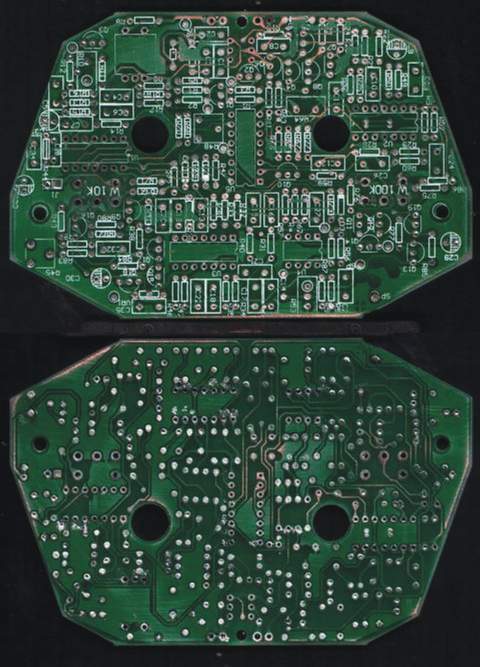

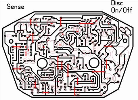

                          • It would be a shame to waste so so descent enclosure from MD3009...so i decided to use it and put another TGSL inside. Logically i had to respect original 3009 pcb dimensions and shape to suit enlosure. What a hard labour!?
                            So before scraped it and enjoyed with hammer, first i cleaned pcb form any component and scanned it in 1:1 so later i could import it in Sprint Layout and draw TGSL on it...Ha,ha,ha,ha!!! What a lunatic am i?
                            Anybody more crazy than me here? Seriously i have doubts!

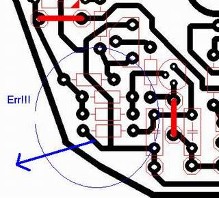

                            • Oh i forgot; only one error on this pcb!
                              Look that wrong connection at emiter resistor - should go to +8V not to ground and other from base to gnd not to +8V...
                              Everything else seems to be good...
                              Working in progress...will be ready tomorrow..
                              • TESORO GOLDEN SABRE
                                Hello Ivconic , I am looking forward to the new sprint lay-out and we will see if it matches this photo ???? Thank-You..............Eugene
