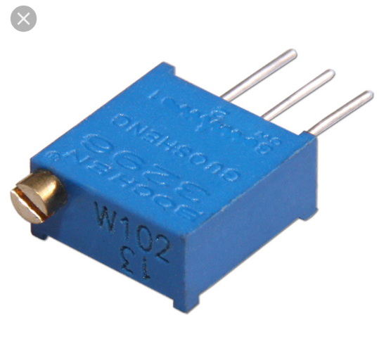

                      is this good for GB pot?????Click image for larger version

                      • Originally posted by mostafalesnar91 View Post
                        disc mode or all metal mode??????????
                        i tried with frrite correctly you can see it in this video
                        but when i move the loop, my device makes noise!!!!!!
                        Now I can't remember which mode I used to set GB pot.
                        It could have been in All Metal but switch to Disc to check it still responds to a silver coin.
                        is this good for GB pot?????[ATTACH]54851[/ATTACH]
                        Yes, a 10-15 turn pot will make adjustment easier. However it needs to be 100kOhm (104) not 1kOhm (102).

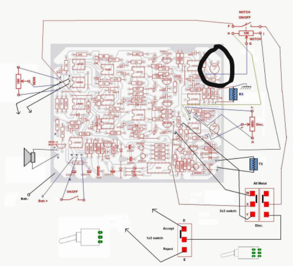

                          what is this pot doing???? Click image for larger version
Name:	۲۰۲۱-۰۴-۰۶ ۲۱.۴۷.۰.png
                              [ATTACH]54854[/ATTACH] what is this pot doing???? [ATTACH]54854[/ATTACH]
                              That is the GB pot.
