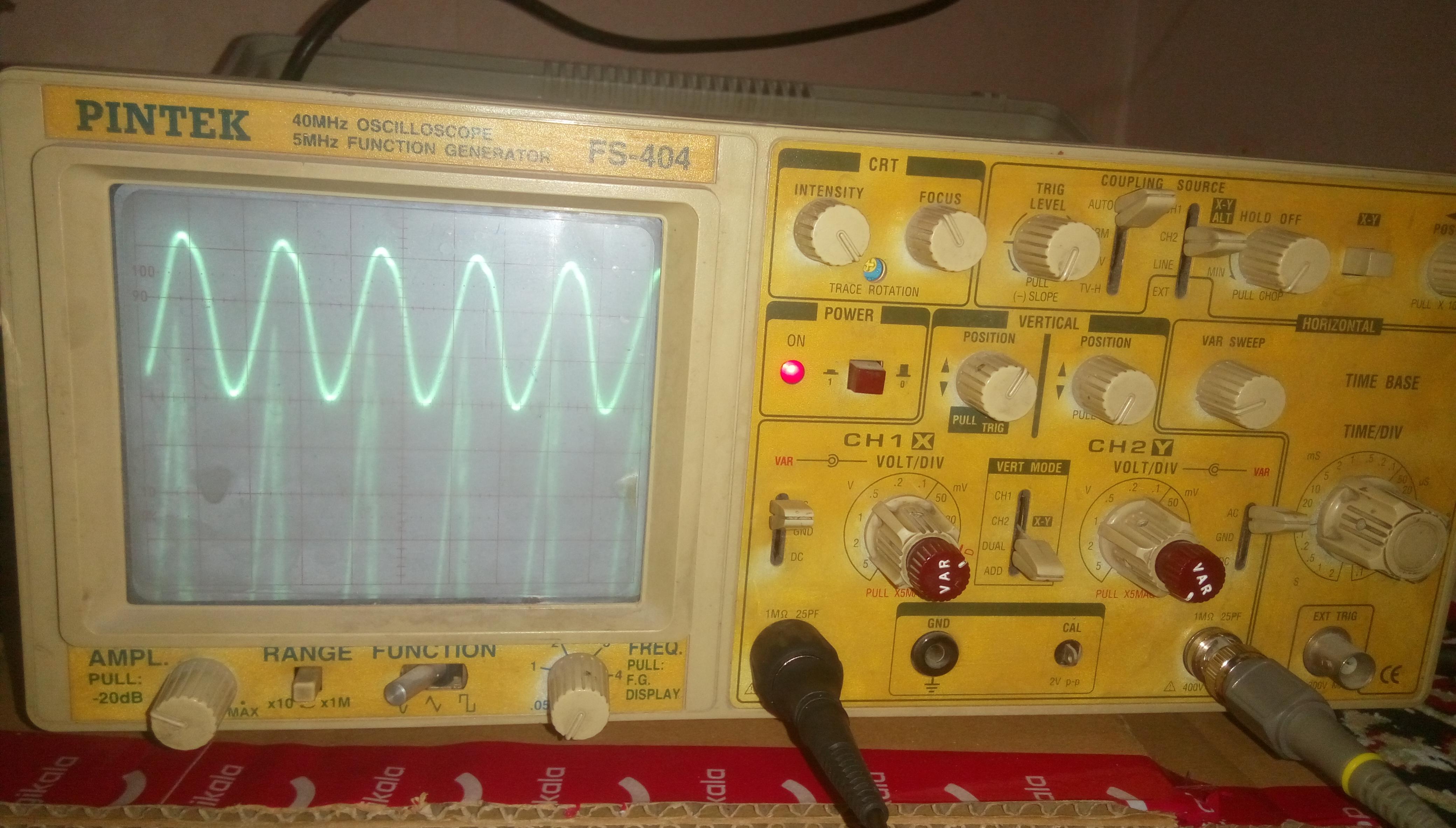

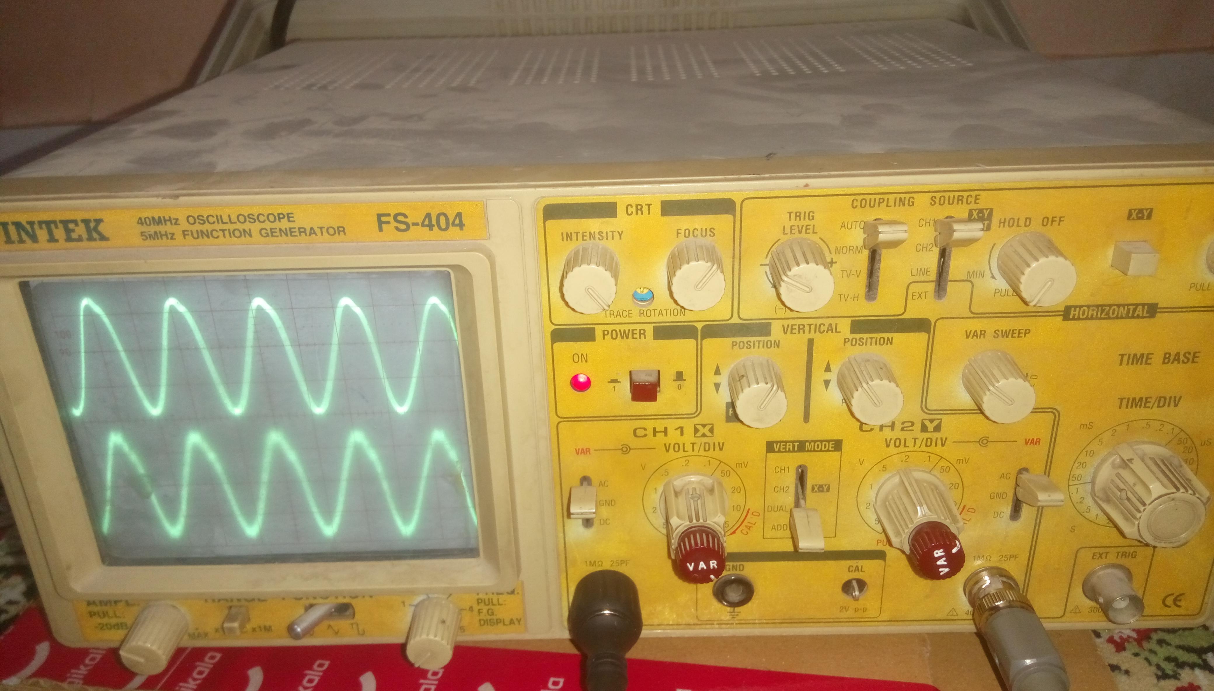

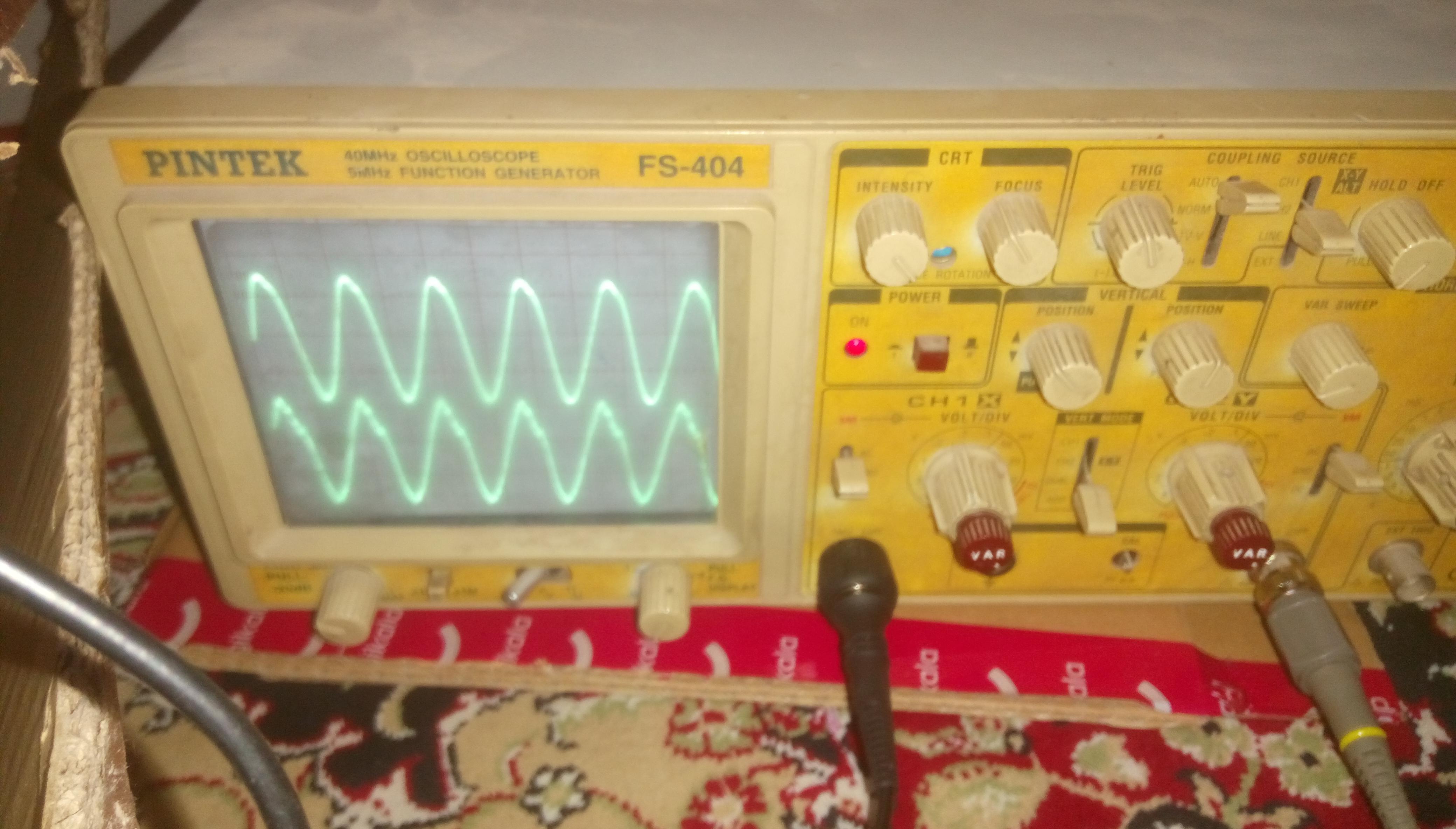

      • Hi, my rx return wavelength of the circuit is high at 10 millivolts, why???This is if the tx wavelength is set to exactly 16 volts!!!Does this problem depend on whether the gb is open or closed or how the loop is placed when balancing, whether it is horizontal or vertical????
        • yes, amigo in Persia. you just open a physics rule now. it the transformer unsymmetrical you get the voltage.
          write your university skill basic. what and where you learned.
          • Originally posted by kts315 View Post

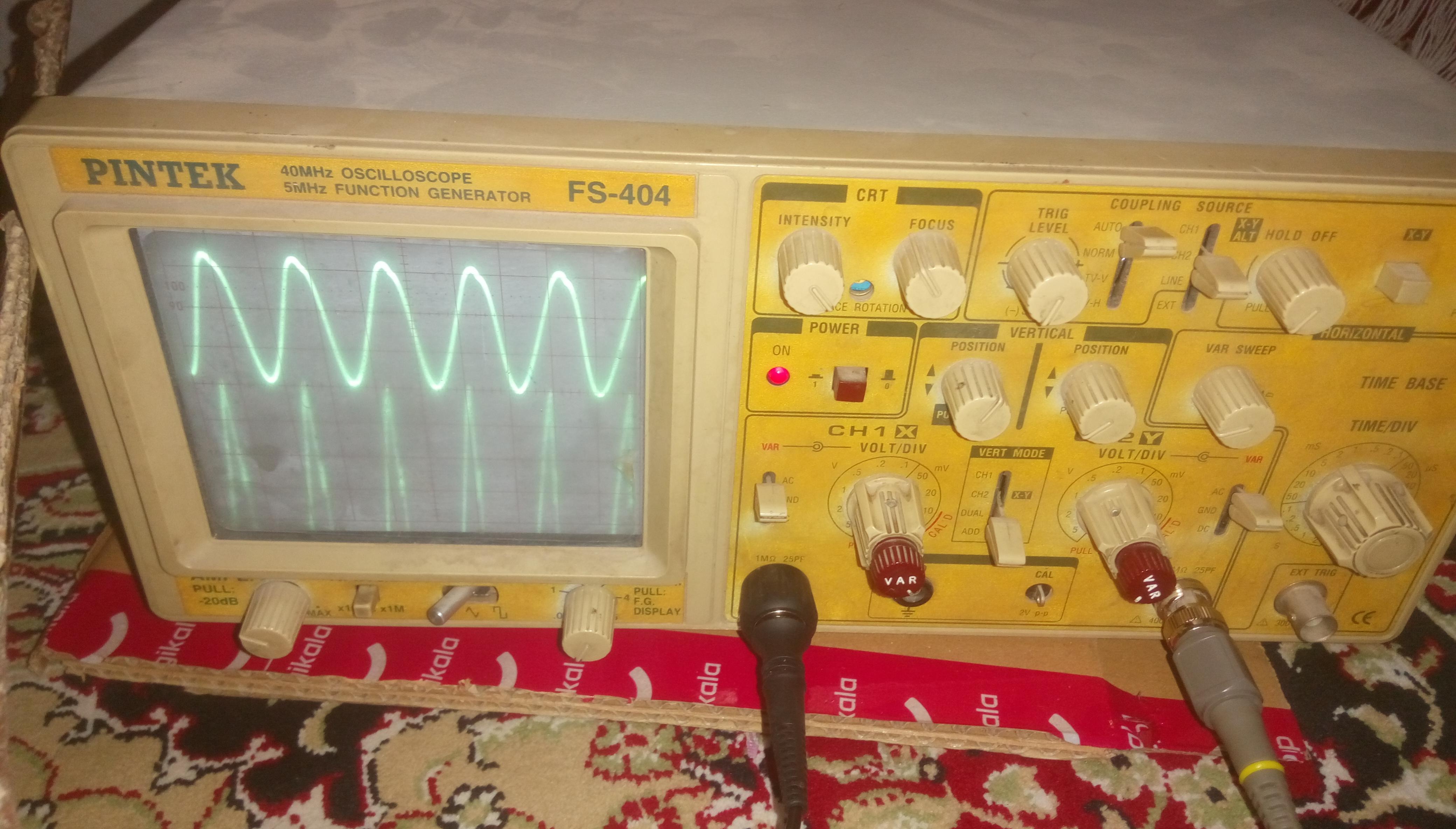

            mohandes kt315 Tx is very good but Rx is high!!
ID:	363525 on 10mv
            200mv Click image for larger version
ID:	363527Click image for larger version

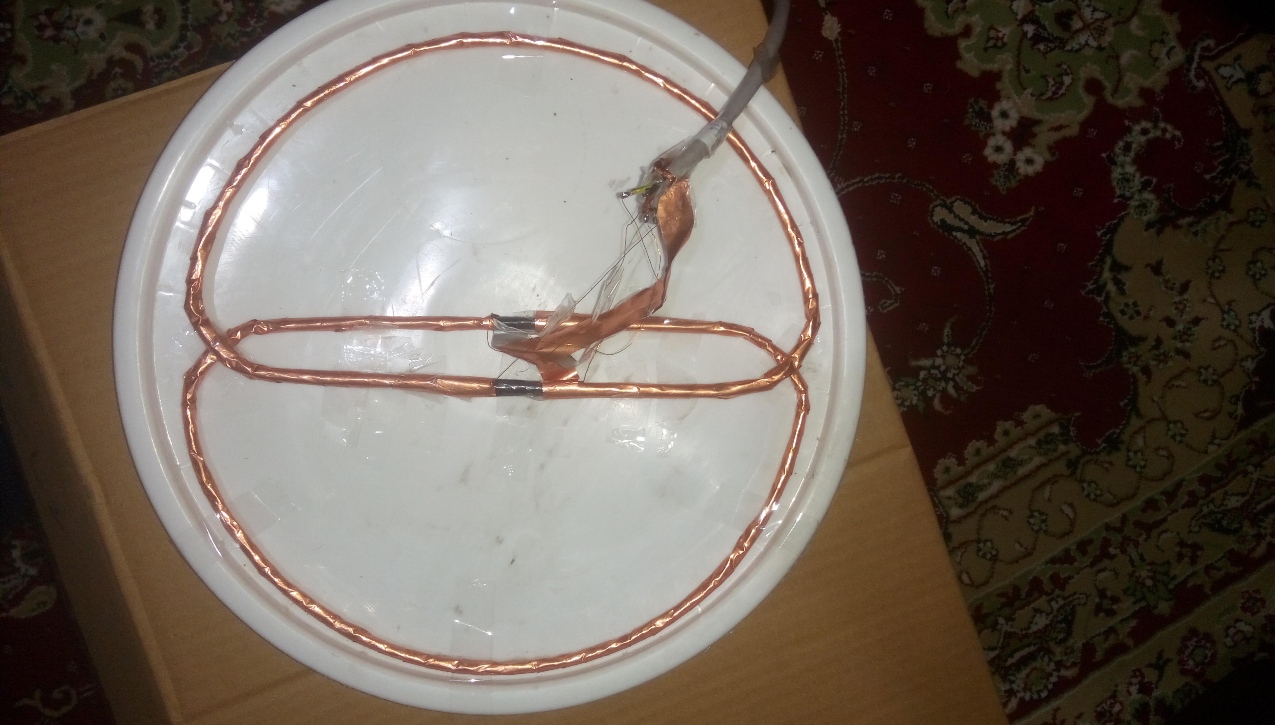

            • experiment with small piece of copper or closed copper wire ring.
              1 change the size of it
              2 change a place of it between windings
              • Make sure there is no metal at all near the coil, especially any other coils.
                If it is still high, then probably your coil null is at fault. It looks like mostly a reactive (X) null problem so you probably need to tweak the nulling.

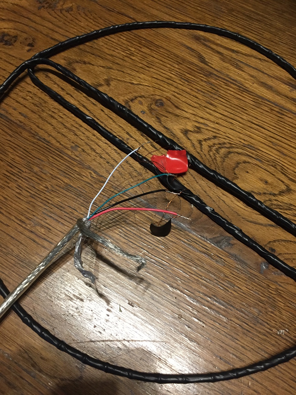

                  There must be a metal that has a high rx
                  The only metal is close to the connector loop
                  Do I have to delete it according to this picture?
                  Whether or not the loop is shielded is important when nulling

                    • You can null an unshielded coil, but then when you apply shielding usually the null will shift. The cable should have a minimal effect, you can test by moving it around.
                        This is a good trick for altering the R-null, but what I see looks like mostly an X-null problem. You could try moving a small piece of ferrite around the windings.

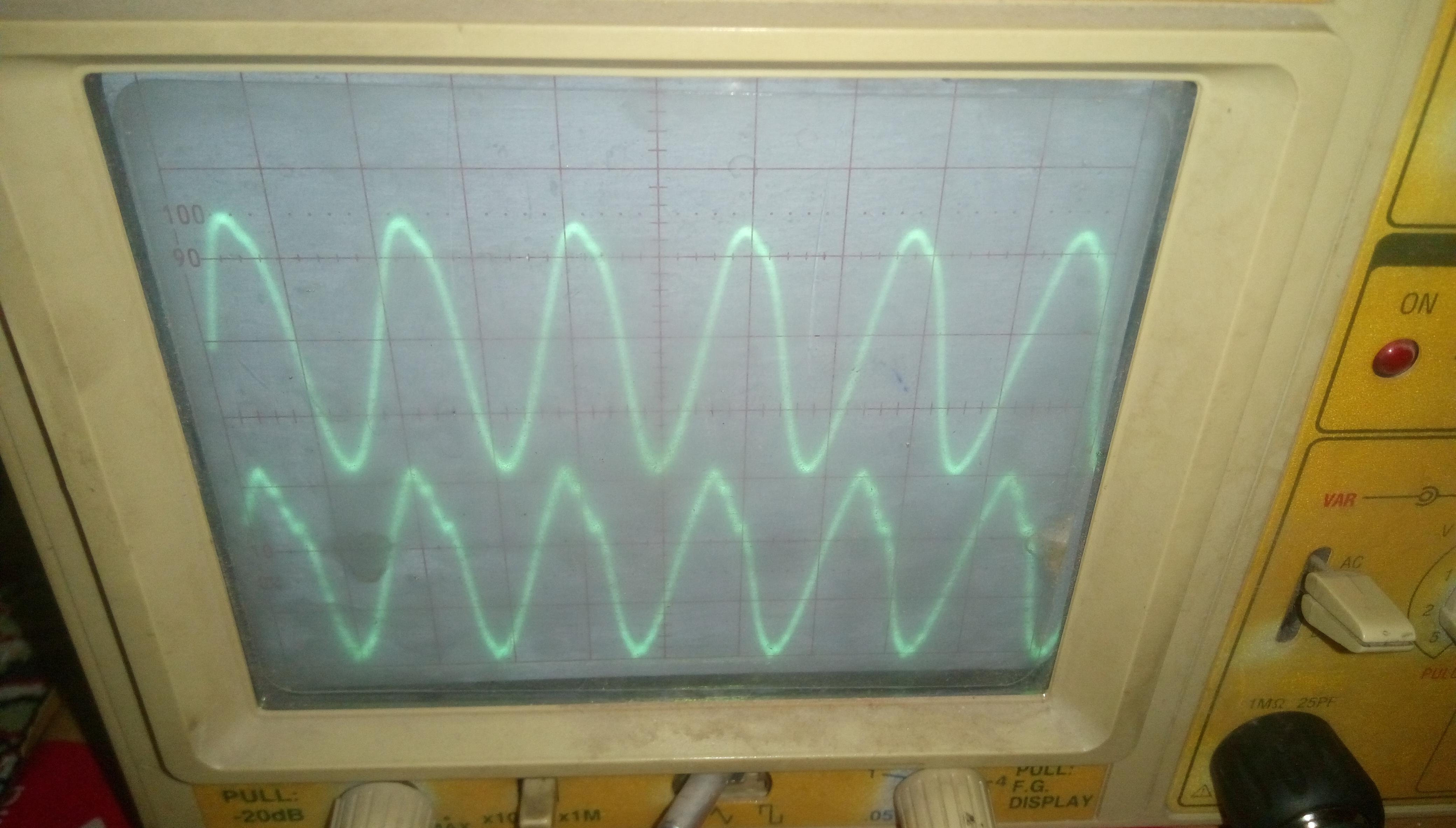

                        • your photo is sad for me. you put fat (cabel) shield on coil and wait good balance that impossible.
                          what to do. turn over the coil so the cable has to go down, on floor. pass the cable via a hole in table. i write just as example for understanding.
                          your cable to the coil must be sheerly, in a space, to be less influence of the metal on the balance.
                            I tried everything, but nothing changed. Up to 200 mv it can be seen correctly
                            10 mv is impossible

                            • foil shields if tx and rx are touched. it is mistake.

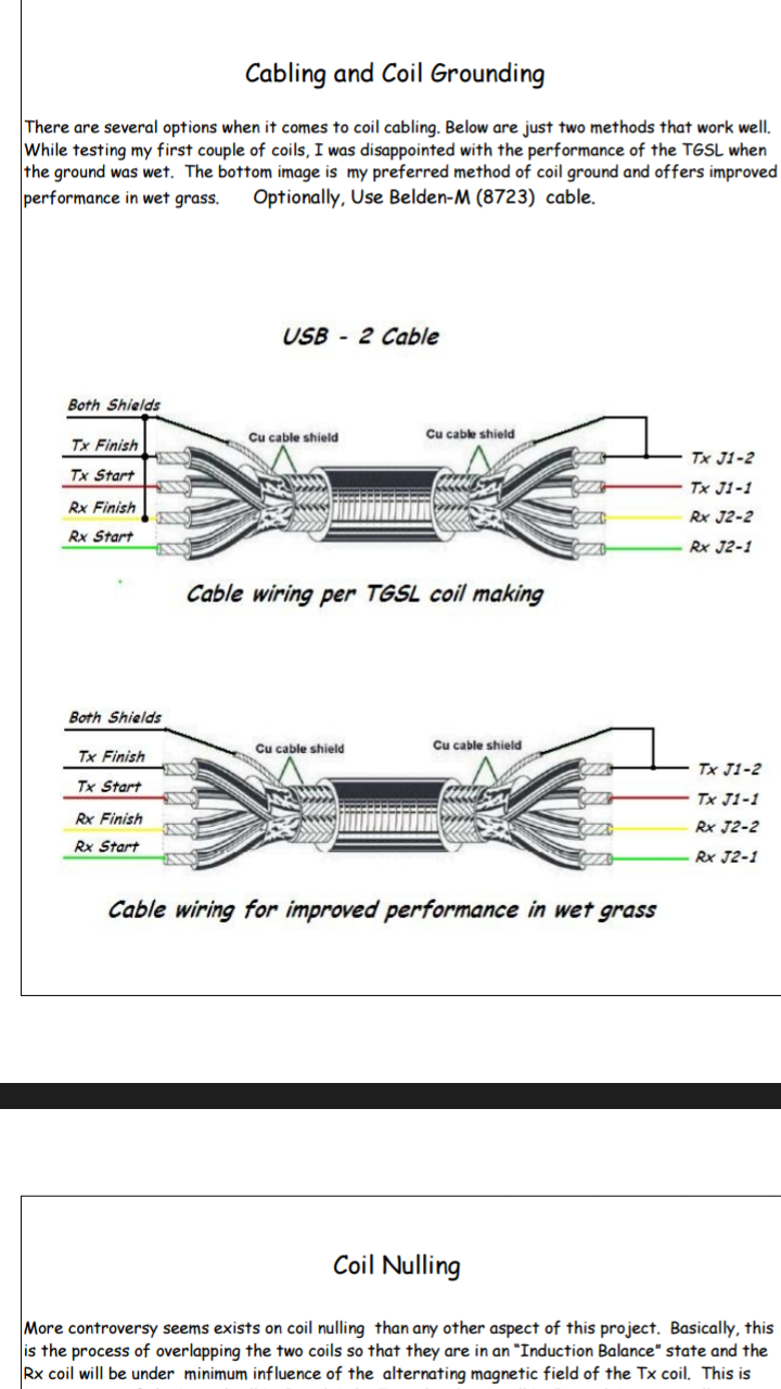

                                So this is also mistakeClick image for larger version
ID:	363534 because it says that both shields must be connected
