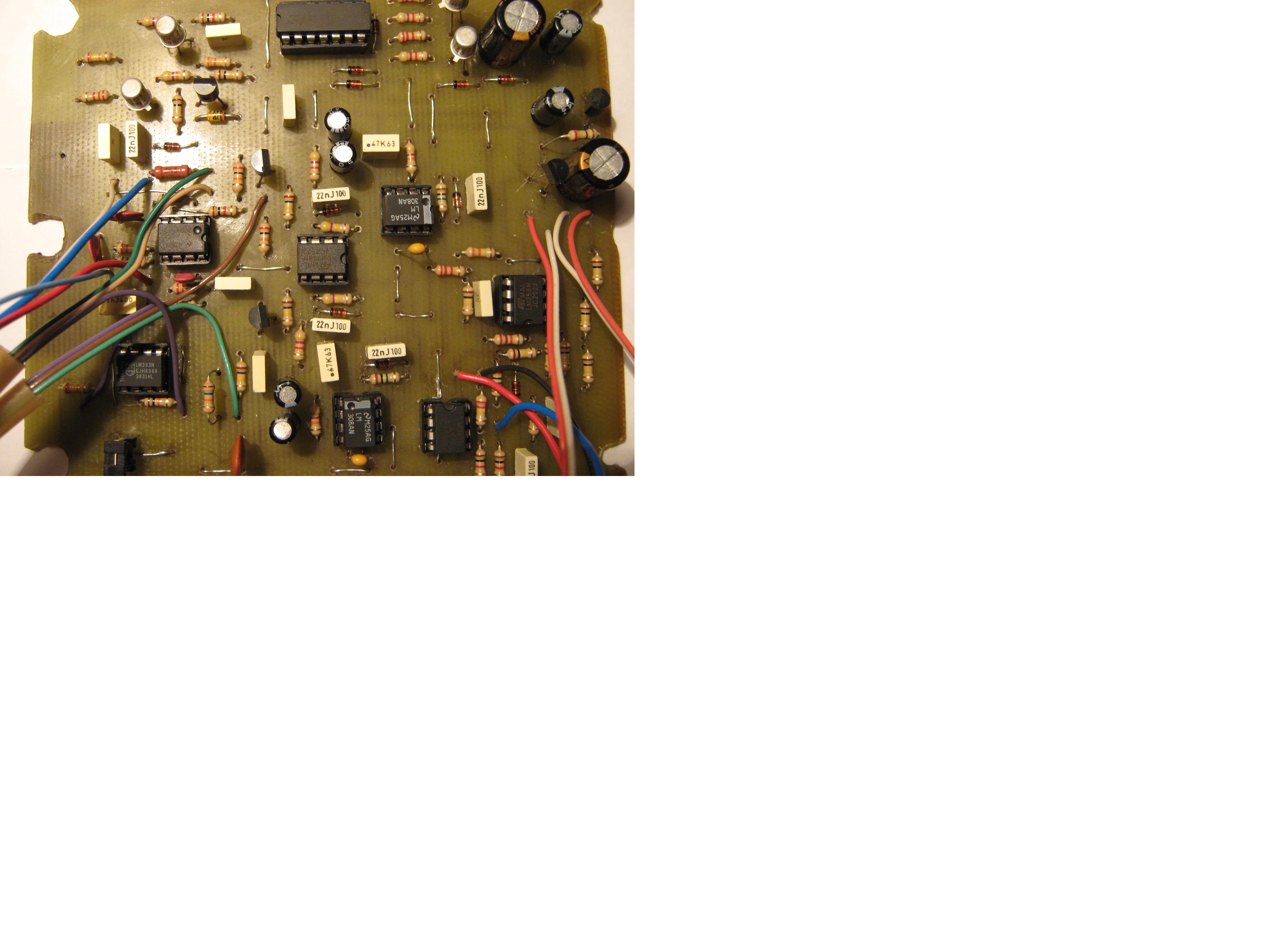

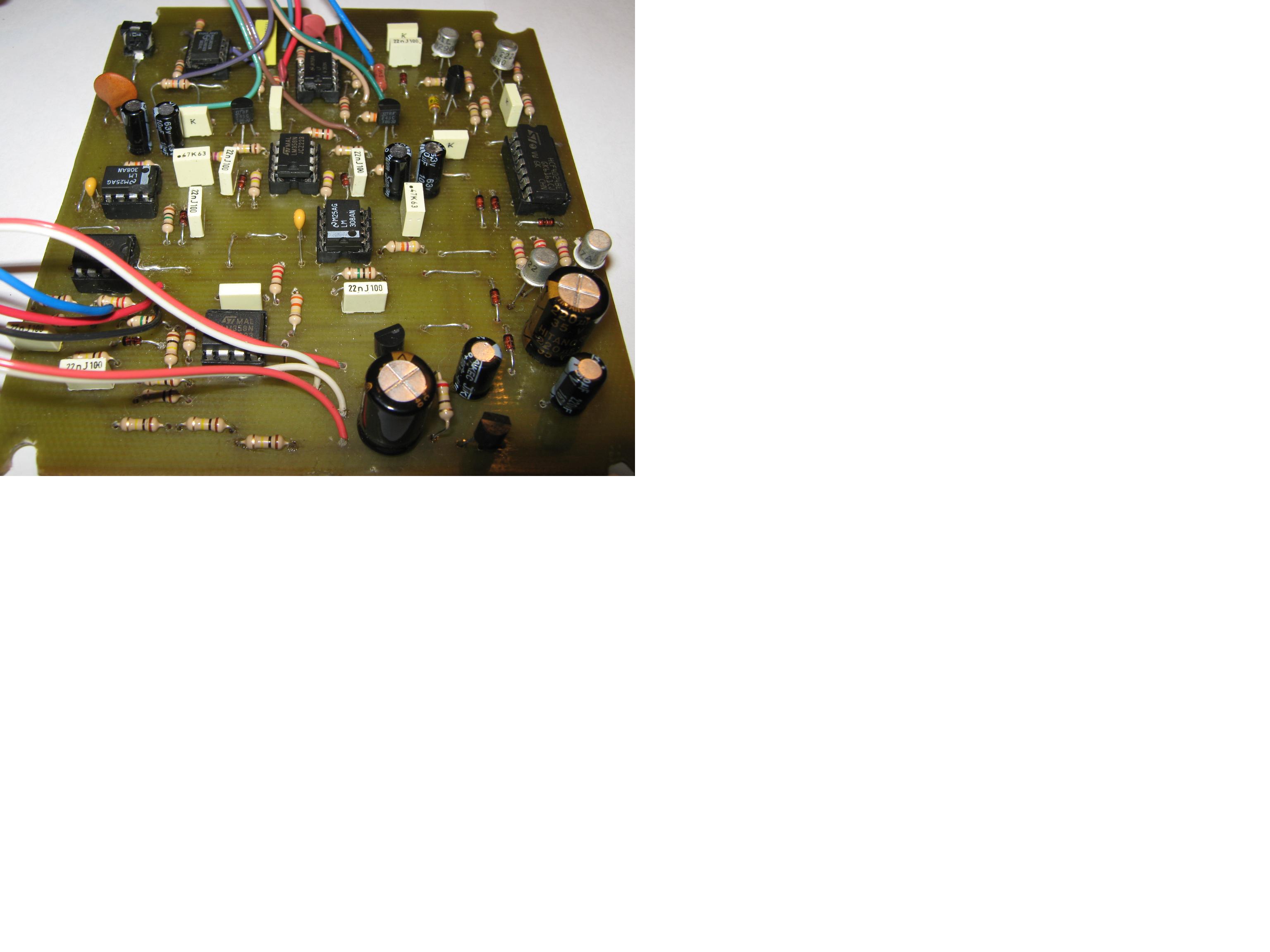

      • Hi,
        I now that its amateur so please dont laught.
        Next will be much better.

          Yeah sure, these are some of schematics..
            All that matters to me is if it works good and sturdy. Good job getting it done. Tell us air tests as soon as you can.

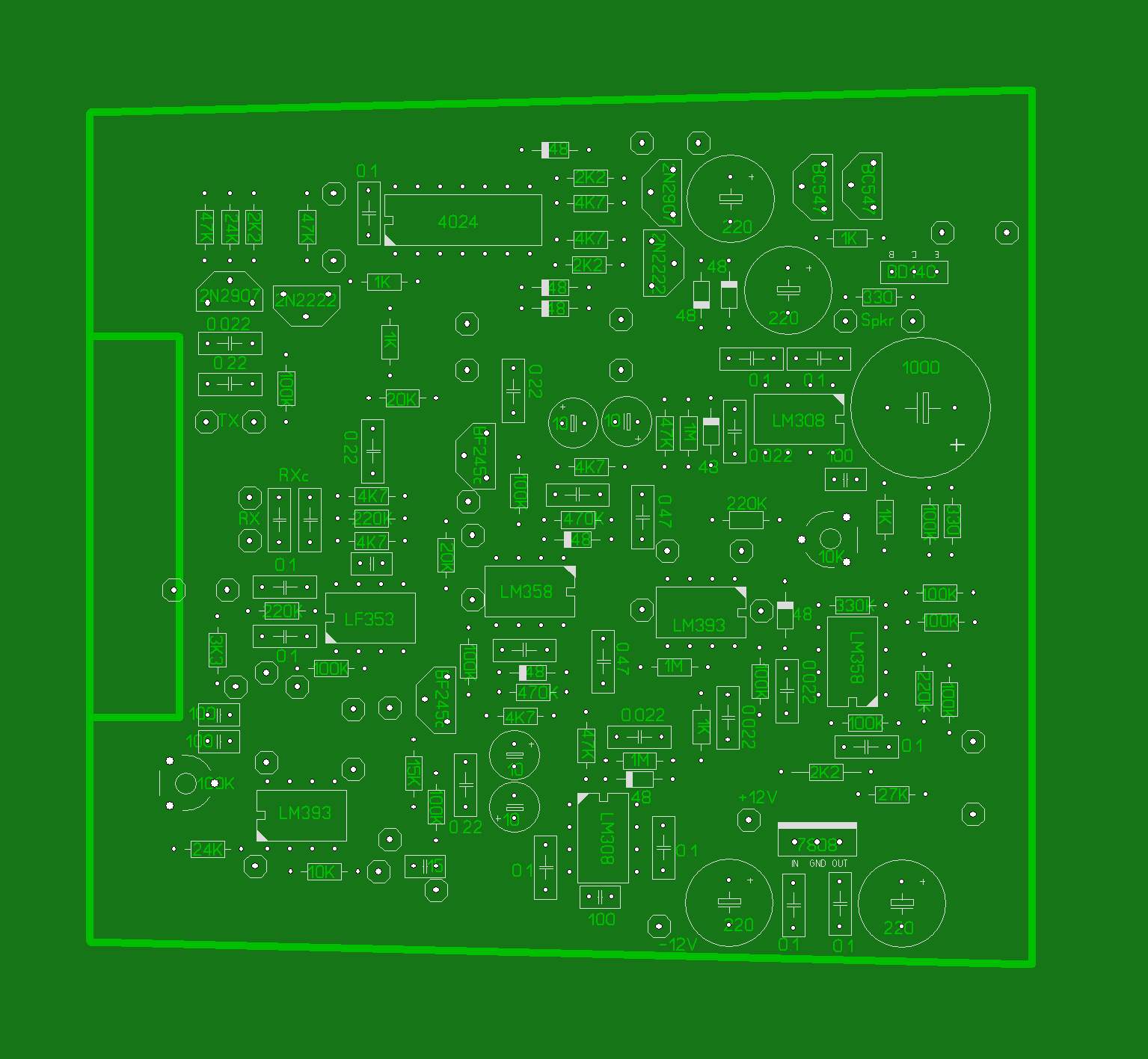

              • Hi Ivconic - I hope you don't mind my nit-picky questions - trying to help people like me less experienced making PCBs. I am fixing some labeling problems in schematic and will post back up as I offered. Just a few questions:
                About the "gsabrelight.sch" file in the exprsch.zip file:
                1. Is the second D5 that goes to ground necessary? (I think Eclipse asked about it before.)
                2. The transistor/jfet pin numbers are different from TO-92 package in the ExpressPCB component set. What package design do you base your pin numbers on?
                (Pin numbers are important if you link your ExpressSCH file to your ExpressPCB file.)
                Thanks,
                -SB

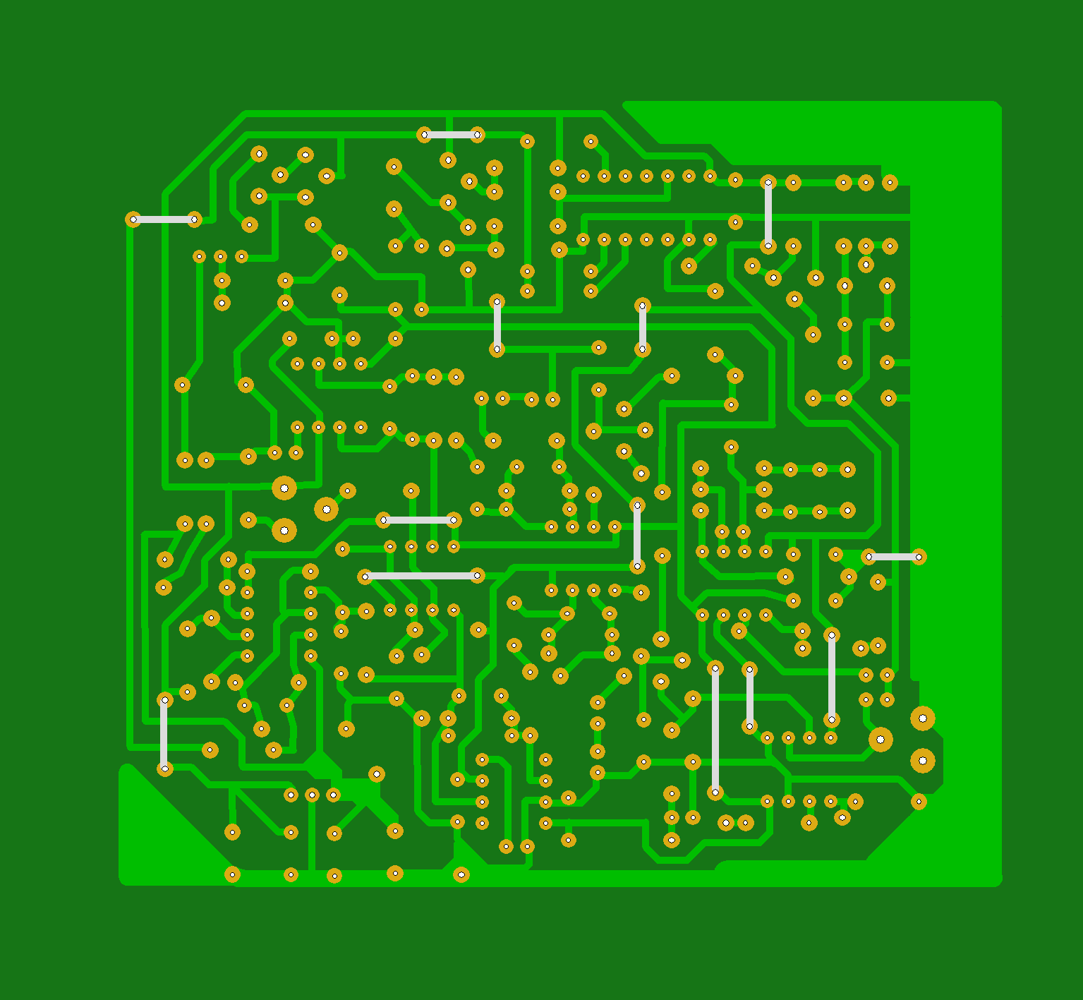

                  Values...
                  Hi Ivconic:
                  Thanks again for labeling the PCB layout. But is there a labeled ".lay" file, or did you label the image only? If ".lay" file, would you upload it?
                  Many thanks,
                  -SB
                    Thanks,
                    -SB
                    1. No it is not. Just a curiosity...and no harm from it. It is "smoothing" a bit those 3 transients. Hard to spot any difference without scope.
                    2. Ha,ha,ha...Sorry...i do not pay attention on tr.pin numbers while drawing schematic. I am very sloppy. Already told here those supposed to be my internal documents...in the past i was not planned to share and publish those anywere. Just a "working" documents...to have something to look in, while soldering components...sort of reminder. Also pcb part of Express software is not what i am using....so i dont mind.. In future i will pay attention on that.
                    Reason for being sloppy lays in fact that i like to experiment. For example: sometimes i will use 2N2907 and sometimes BC557 or simillar. Sometimes i will use J107 and sometimes BF245c...so i dont really mind on pin orientation at transistors..... that is the main reason...
                    • Labeled file...yes it exist. I didnt posted it here???? Ooops!
                      Here it is:
                        Of course, we understand! Better to make progress than fuss over every last detail!
                        In this case, since TGSL famous now , I'll change pin numbers for TO-92 as ExpressPCB uses it -- that way easier for anyone linking ExpressSch schematic to ExpressPCB.
                        -SB
