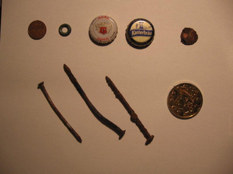

                Being a absolute rookie in Metal Detection I went to the beach
                for my first search ever with my home brewed TGS
                Just a small re-adjustment for GB ; the very wet sand near the coastline caused some alarms but it could also bin the loose bold inside ...
                One of employees from the travelling organisation told me nobody ever found anything on that beach ...
                What an insult for my TGS
                On the beach :
                Within a few sweeps I had a loud and clear signal only in the sand it was allmost impossible to see what I found , after a few minutes it turned out to be a very small iron ring between the tiny rocks , shells and stones .
                Who said nothing could be found on that beach ?
                I'm pretty sure I found some prove that the local pirates robbed their beer from across Europe.
                Also found the remains of their treasury : a couple of rusty nails and a highly heavyly oxidized 'red'golden coin .

                Well it wasn't that much of value but as an old Chinese expression says :

                  Good adventure -- I'd be very happy with such a collection, beats my typical day!
                  Hey, your machine works! Bravo.
                  -SB
                  • finds
                    thats great and the fact your finds were with your own hand made machine gives you that etc buzz, nice one
