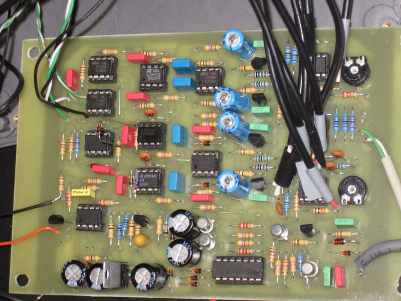

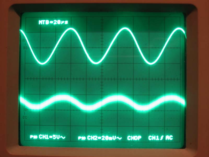

      Hi ,
      I've changed my ceramic caps into the polyester caps but the problem still remains : poor detection distance - max 15 cm on a 2 euro coin ...
      I've bought , as you mentioned , a 10 cm ferrite rod and it was totaly rejected : poor detection distance.
      Changed the BF245C into B type , no progess ( only Tx voltage dropped so changed it back ).
      Used LF353 , LM308 ( even tried TL 081 )2N2907 etc everything according
      original.

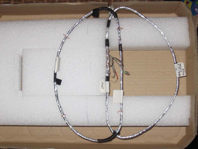

      Max suggested to make another set of DD 25cm coils : problem remains.
      The coils are for TX 6,08 mH / 21,7 ohm / 94 windings and for Rx 6,53 mH / 22,8 ohm / 101 windings of AWG 30.( L values according the multimeter and given the values they should be reasonably )
      The coils are constrained , shielded , with airgap , correct shielded cable used , ground Rx in search head , isolated in overlap points ...
      I've tried to gain the same images as shown on page 57 posted by Max and used these as a lead , I don't know where else to start.
      Used in Tx 4,7 nF // 15nF to reach 14,5 Khz and for Rx only 10nF.

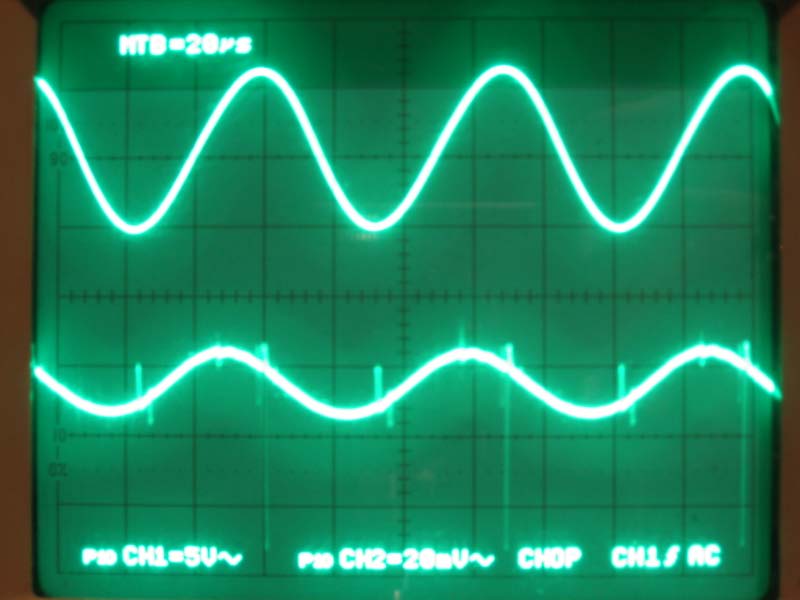

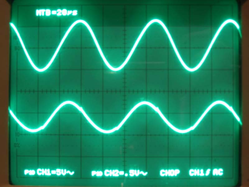

      scoop image attached of :
      - TX - nulling signal direct on Rx leads ( not connected to pcb)
      - Tx
      - Coils

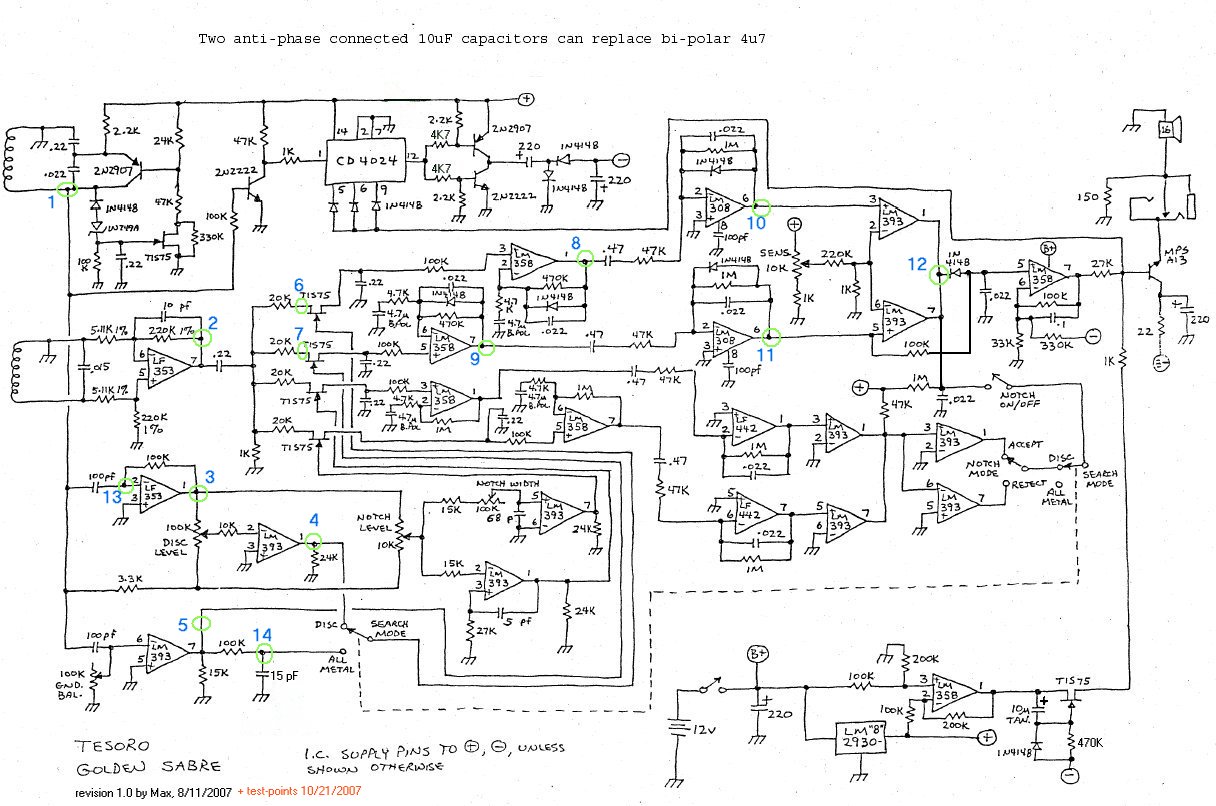

      - Testpoint Schematic for videos

      Nulling on TP2 (see testpoint image attached) :
      http://www.youtube.com/watch?v=SyQTNIxPSyI
      Nulling on pin6 input LF353 (coil connected to pcb to compare with firdt video):
      http://www.youtube.com/watch?v=AyK02Zk1PLY
      Nulling on TP4 ( the influence (?) of nulling on DISC LEVEL):
      http://www.youtube.com/watch?v=xg615rcykg8
      DISC potmeter from CounterWise to CounterClockWise on TP4 :
      http://www.youtube.com/watch?v=o8pYD7AQQhs
      Nulling on TP5 (the influence(?) of nulling on GroundBalance):
      http://www.youtube.com/watch?v=Pn--c863r1k
      GEB potmeter from CW to CCW :
      http://www.youtube.com/watch?v=RtPP2Qe67jk
      Nulling on TP6 switch in ALL METAL position:
      http://www.youtube.com/watch?v=u1VqMiKEhS0
      Nulling on TP6 switch in DISC position:
      http://www.youtube.com/watch?v=Urx633REO8s
      DISC potmeter from CW to CCW on TP 6 switch in DISC pos :
      http://www.youtube.com/watch?v=VILCDHE5kJg
      Nulling on TP7 ( the influence (?) of nulling on GEB ):
      http://www.youtube.com/watch?v=htUUla-vk-E
      GEB potmeter from CW to CCW on TP7:
      http://www.youtube.com/watch?v=Mkzde5mX-c4
      TP8 ferrite rod rejected :
      http://www.youtube.com/watch?v=PeE4AL4kKh4
      TP8 detecting 2 euro coin at max 15 cm :
      http://www.youtube.com/watch?v=gB1GnSdN3fs
      TP10 detecting 2 euro coin at max 15 cm , >20 cm no response :
      http://www.youtube.com/watch?v=sdTP34u3pM8
      Is there a possibility that when even the nulling seems fine , the sensitivity is poor ?
      So coil related problem)
      Anyone any suggestions what could relate to this problem of the poor detecting depth ( in air) ?
      I've payed most attention on detection in ALL METAL mode , didn't experiment much (yet) in other modes.
      Is this a example that nulling isn't only about residual voltage but perhaps most important the influence of the phase shift on serveral testpoints?
      When nulling on scoop 30mV is on MultiMeter 000.0 mV
      " " 80mV is on MultiMeter 1mV
      The residual voltage mentioned in serveral post ( 4 -12 mV depending on type MM) is pretty high with scoop measured direct on coil ?
      regards Dennis the Mennis

        • Originally posted by Dennis the Mennis View Post
          It is unlikely that the low sensitivity is caused by using ceramic capacitors throughout the design. Polyester caps would be preferred in the TX and RX circuits, but not essential. Ceramic caps are best for coupling, decoupling and filtering.If you change the TX and RX caps for polyester types, I doubt you will notice any difference.
          Hi Qiaozhi ,
          I guess you were right ...(?)
          Dennis the Mennis
          I'm not going to say, "told you so".
          Looking at the values for your coils and the tuning caps used, I have calculated your TX frequency to be 14.5KHz, which you have confirmed is correct. However, your RX circuit is tuned to 19.7KHz, which in my opinion is too high, as Tesoro circuits are usually off resonance by around 9%. In this case you should be using a calculated capacitor value of 15.5nF to tune the RX to 15.8KHz. I would suggest trying a 15nF cap instead of the 10nF and see if there is any improvement.
          • Darn, Qiaozhi. You beat me to it.
            LTspice shows almost 3x increase in received signal voltage by changing to 15n, with a 6.53mH receiver coil.
            Sorry about the wild goose chase, Dennis.

              • " ..Nulling on pin6 input LF353 (coil connected to pcb to compare with firdt video):
                http://www.youtube.com/watch?v=AyK02Zk1PLY ..
                I guess those "notches" (kind a distortion in sinus) are caused by bad quality of RX cap ?
                Because i usually have there perfect sinus without any distortions...
                I am using PP caps at TX and RX whenever i can find proper ones.

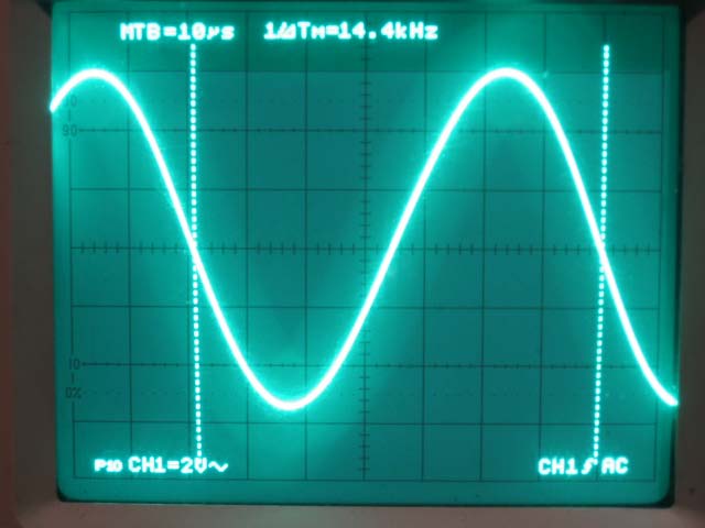

                • Off resonance:
                  TX = 6mH + 20nF = 14.53kHz
                  or.......... + 22nF = 13.85kHz
                  RX = 6.5mH + 15nF = 16.12kHz
                  1.59kHz or 2.27kHz off resonance....
                  • " ...Is there a possibility that when even the nulling seems fine , the sensitivity is poor ?..."
                    "Nulling seems fine" but you must understand that coils nulled well on one frequency are not nulled well on another (different) frequency. Residual voltage rised if frequency changed.
                    I think Qiaozhi already gave here good hint. Keep RX coil resonance within +1.8 - +2kHz than TX coil.
                    And use pp caps.

                      • Another thing;
                        am i wrong or i see TX amplitude there barely over 10vpp ?
                        That could be the cause of poor depths.
                        Usually amplitude is 15-16vpp at TGS/TGSL...
