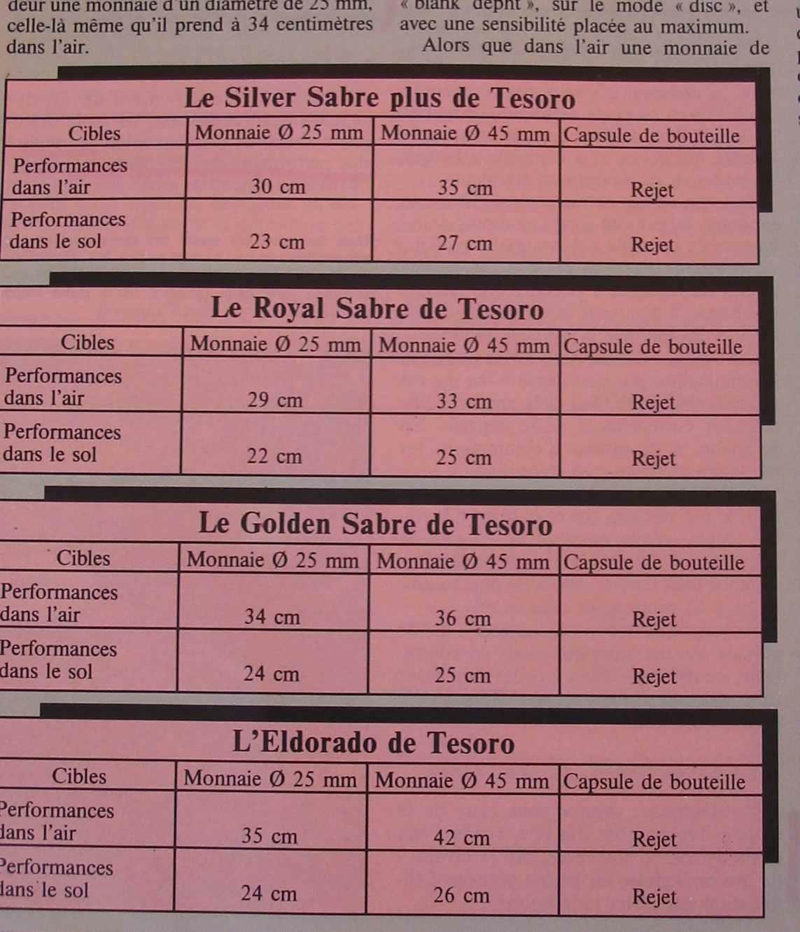

                      • Hello Ivconic and the forum here I post a photo from test in a french revue for analysis .
                        performance dans l'air : air test
                        performance dans le sol : soil test
                        Monnaie 25mm :coin 25 millimeter
                        Monnaie 45mm : coin 45mm
                        Capsule de bouteille: bottle cap

                          • Originally posted by Alexismex View Post
                            which are coils employed for testing devices!? That's an important factor.
                            Kind regards,
                            Max
                            • Ok Max i will check the revue
