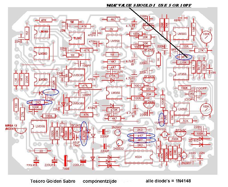

                          • Hi, i think i found my problem with coils for my TGS. I noticed that a 5 PF cap is on pcb, very close to RX stage. (See the drawing), btw pins 6 and 7 of LF353. But on the schematic there is a 10 PF cap. So can this change my RX frequency?
                            I m using a 5 PDF cap instead of the 10 PF cap show on the schematics.
                            Please give me a detail explanation, cause my best performance for TGS is on 19, 2 Khz.
                            Nelson

                            • Hi,
                              Nelson.
                              Unfortunatly I cant help you with detail exponation,you should ask Max or Ivconic for such.I am only entusisast!
                              But this 5pF cap is not your probleme!First this cap were 5pf and then the value were changed for better performance.But I havent notice any differance when changed this on my PCB.
                              I am afraid that your probleme is different.
                                Nelson
                                change about nothing... use one of the 2 values...
                                This isn't your problem.
                                Your coil is wrong if you get such higher frequency... as I told you before... maybe it's wire... or number of turns... or you made wrong tightening of wounds... leaving turns too open etc etc.
                                Also varnish tickness is important cause of the surface capacitance increase or decrease you can get.
                                I suggest you find sure 30AWG and made it again using provided data.
                                The bare wire will be exactly 0.25mm not other things (the varnished wire diameter goes from 0.27 to 0.28mm).
                                Wire is critical if you use Ivconics numbers on turns... so stay close as possible... otherwise you'll get another wrong coil.
                                Then nulling is most important phase in all this stuff... and require extra care... it's not easy thing... but you can do. Don't worry.
                                Kind regards,
