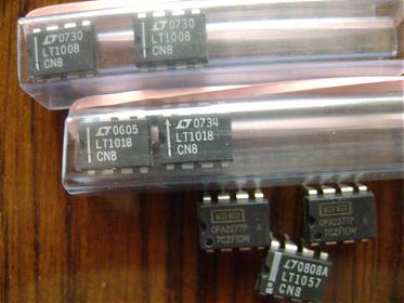

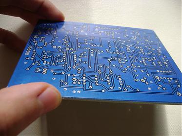

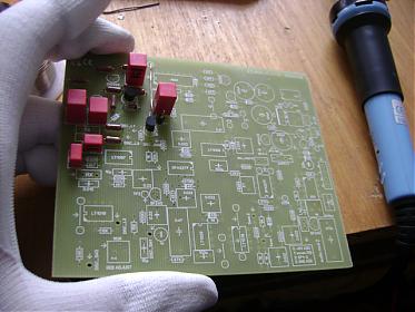

      • Don't want to spoil the discussion, though the page is already going to end..
        here are some images from today
        1. the sweet ICs im going to use 2. bottom layer with gnd plane 3.time to solder
          Those are most beautiful!
          I'm very interested in effect of ground plane, what you find.
          -SB

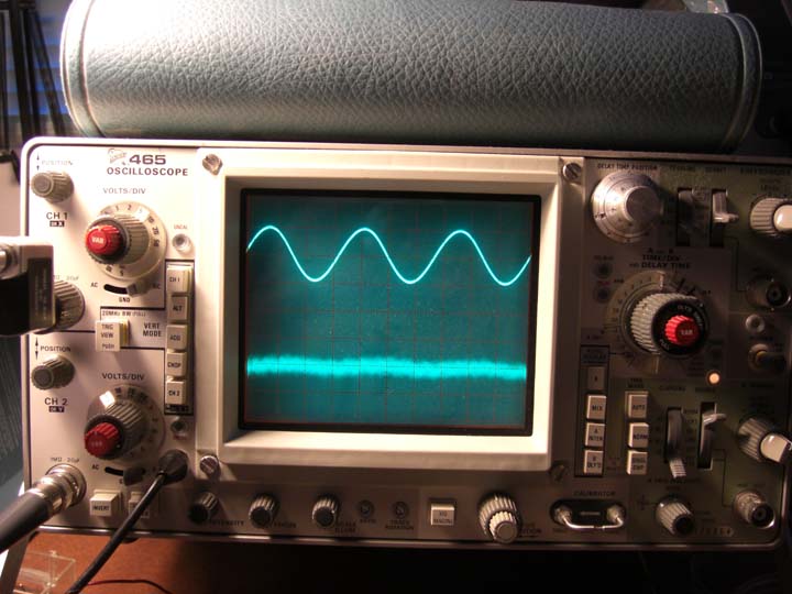

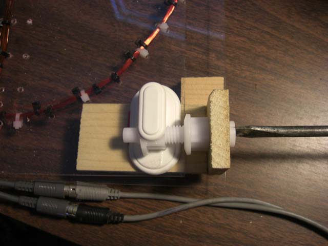

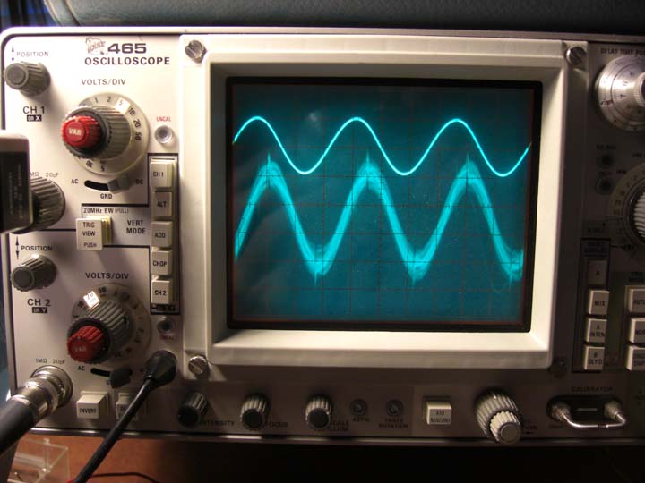

          • nulling and RX connections
            I saw Max advice on RX coil phasing and nulling, 200 deg, etc, but now I have some more confusion.

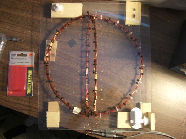

            I use my "nulling machine" for experiment (what, you never saw it yet? Here's a good laugh, see pictures).
            Using screw, I adjust my coil to get a good null (less than 2 mv signal, just noise left, see first oscilloscope picture. Top trace is TX signal at collector, 5v/div, bottom trace is RX coil by itself, 5mv/div. Coils are grounded together with shield wire.)
            Now I connect coil to circuit -- not sure which way, just pick one.

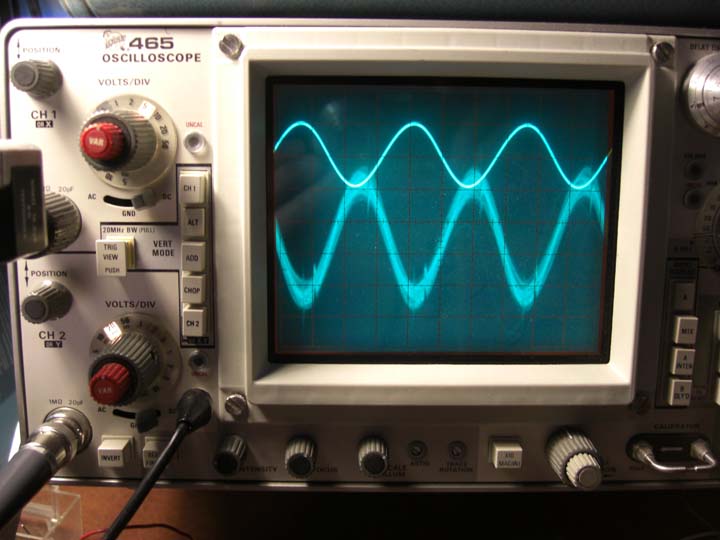

            Then I look like Max says at pin7 of LF353 and compare to TX signal. See next picture (top trace TX, bottom pin7 20 mv/div). Phase is less than 90 deg looks like.
            Now I adjust null of coil teeny, tiny, bit, just breath on it, go slightly to other side of null. See picture, phase completely shift, like turn upside down.
            You already know this -- when right at null center, very slight shift either side makes huge phase difference. That must be why someone says don't null exactly, go more to one side.
            So now I'm not sure which way to connect RX coil leads to circuit. I think we need total explanation starting at coils.
            First, which leads are shielded and connected together, based on direction of windings. Then, which pin on ciruit gets shielded lead. Then, using Max's advice for 200 deg phase shift, we can decide which side of null to adjust coil on.
            I think it's been said but in pieces; if someone could go start to finish it would be good reference.
            Thanks!
            -SB
            P.S. More pics next post...
            • More Pics
              Continued...
              Pic 1 - one side of null.
              Pic 2 - other side of null.
              Cheers!
              -SB
              • Eclipse i envy you on LT1008 !!!
                Ha,ha...if only i could find those in local shops! I am sure LT1008 would be much better there at TGSL than LM308!
                What a nice pcb!!! I envy also on that! You are the artist! Bravo!
                Most beautifull pcb i saw so far. Excell job! Bravo!
                And Simon... i envy you on "nulling machine" and scope !

                • Hi Simon,
                  you have an excellent nulling machine! Really intelligent solution.
                  I am using two component epoxy glue. If the nulling wasn't good, then ripping the coils off and trying again and again...
                  Aziz
                    Hi Simon,
                    Aziz
                    I'm like woman, need to change mind all the time, so do anything to avoid solder or glue!!!! (just kidding, old joke about women, shame on me)

                          this is the right side... if you're looking at output of preamp: there's something (I cannot read it well from picture) around 200°
                          That's where you're supposed to "null" the coil: be aware you'll probably cannot mantain that phase also at minimum voltage... you just need to keep voltage smallest as possible matching that phase... other phase will false disc and geb... and your device will be completely unreliable.
                          Kind regards,
                          Max

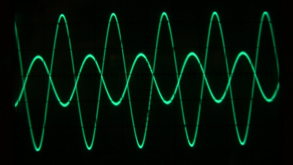

                          • for Simon
                            look at that: it's Qiaozhi's picture of signals at TX, RX (output of preamp) using an original coil (maybe it's an 8'' round ? I've tested an 8'' round an was exactly the same stuff too...I suppose they are about all the same... no matter of size or widescan...spider... etc).
                            I read about the same on my 9x8'', also... you'll get left shifts of RX signal nearing any metal, but no shift in pure mineral response (e.g. ferrite crystals)
                            Kind regards,
                            Max
                            • Hi,
                              simonbaker.
                              This is a nice idea for experimental nulling.But I dont see how you can fix the coil in its final position.You see my point.I also hate solder and desolder again but......This are not even shielded.Plus I think that the both windings should be sealed with epoxy at once.And thats the trick.Keeping good null in same time.
                              I had some average experiance with sealing step buy step.Several layers.
                              So the windings should be fixed reliable and then sealed at once with epoxy.This way you have net and resistable construction.
