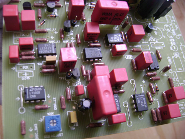

    I ordered the board in a local manifacturing company (pcb with solder mask and print screen -20$), hand made won't be that good for the purpose.
    Parts are ordered from Mouser & Digikey.
    In local shop I can't even find potentiometers what to say about the LM308, good caps, etc, not to mention the quality is low (some of them are dead on arrival).... real loosers Im done buying components from the shops here.

                  Dirceu, nice pcb.
                  One thing might cause you a problem; 1000uF footprint. It supposed to be 1000uf/25V. You should place there larger footprint....maybe? Maybe not, depends of capacitors you can find in your local shops.
                  Hi! IVCONIC
                  Yes. 1000uF/25V. No problems with components here.In local shops I find several sizes for these components.

                                Almost ready, tomorrow - big day
                                Gawd that is gorgeous! I think you should make a separate thread with the whole story of building your detector, experiments, waveforms, pictures of components, why you chose each, field tests - don't forget schematic, pcb files -- so we can drool! Really nice!
