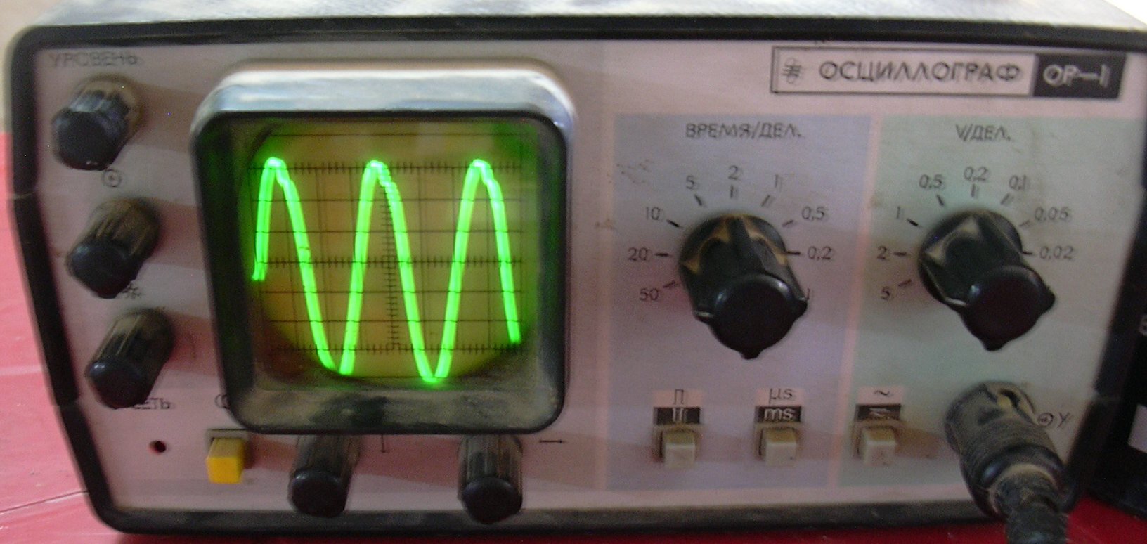

    all LM358 LM393 LF353 voltage are -v6.1 pin4 and 7.9 on pin8 so what is the problem please TX gives nice sinewave coil i test with Gift pack is ok

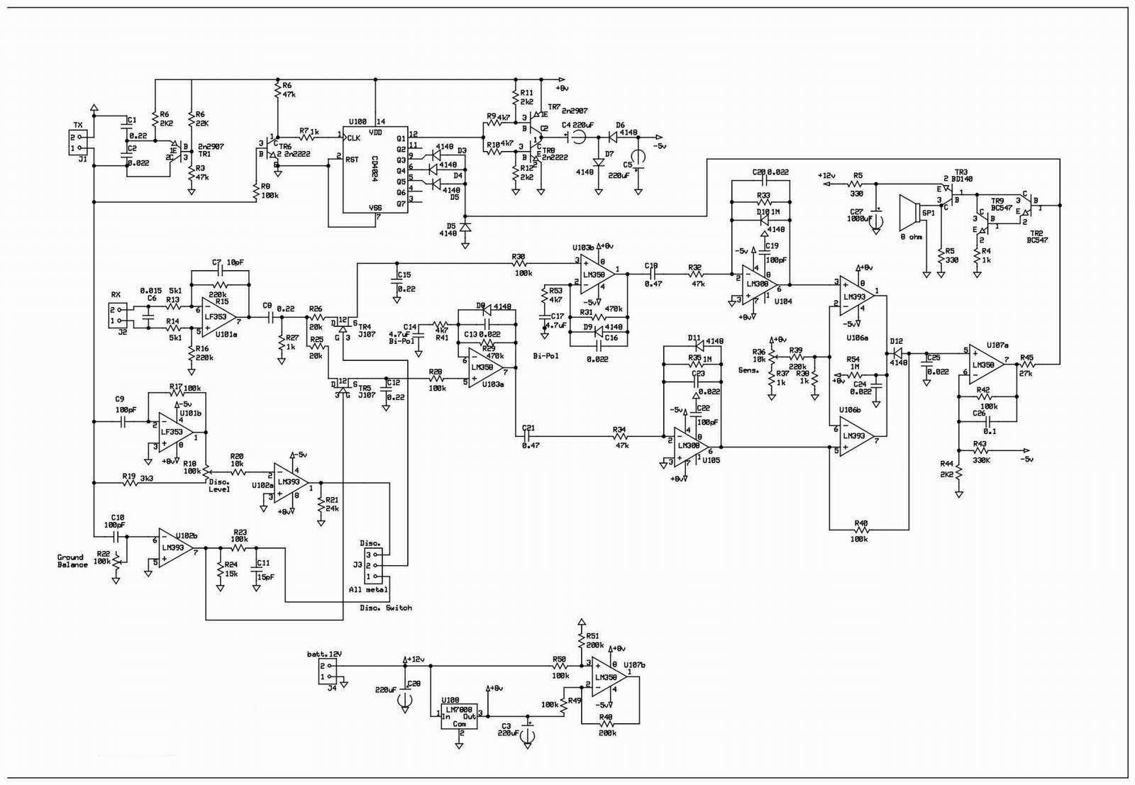

      What "diode by LM393" ???
      Here is schematic again. Please post here what diode, write diode designator or draw circle on that diode!
      Is it D12?

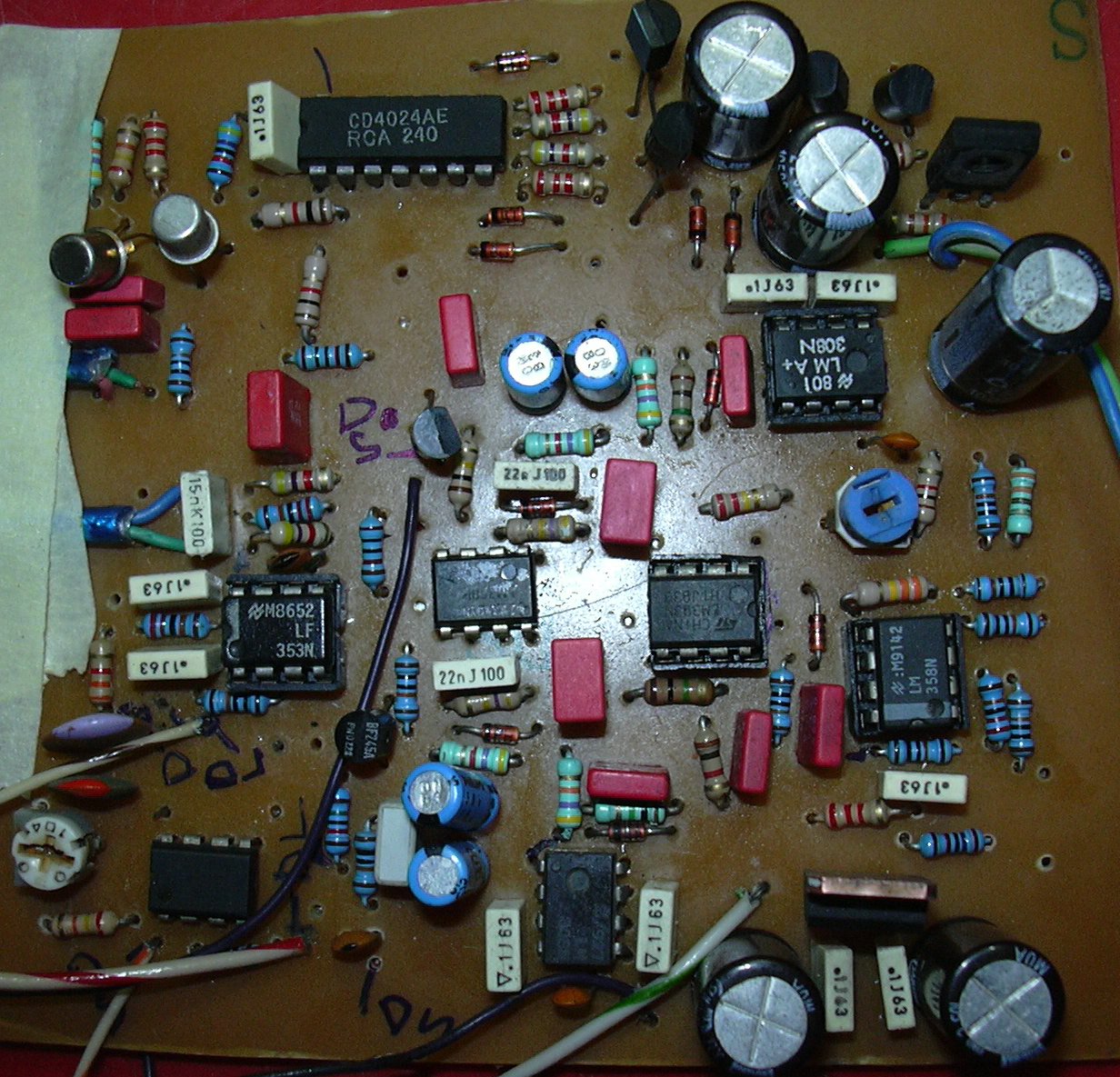

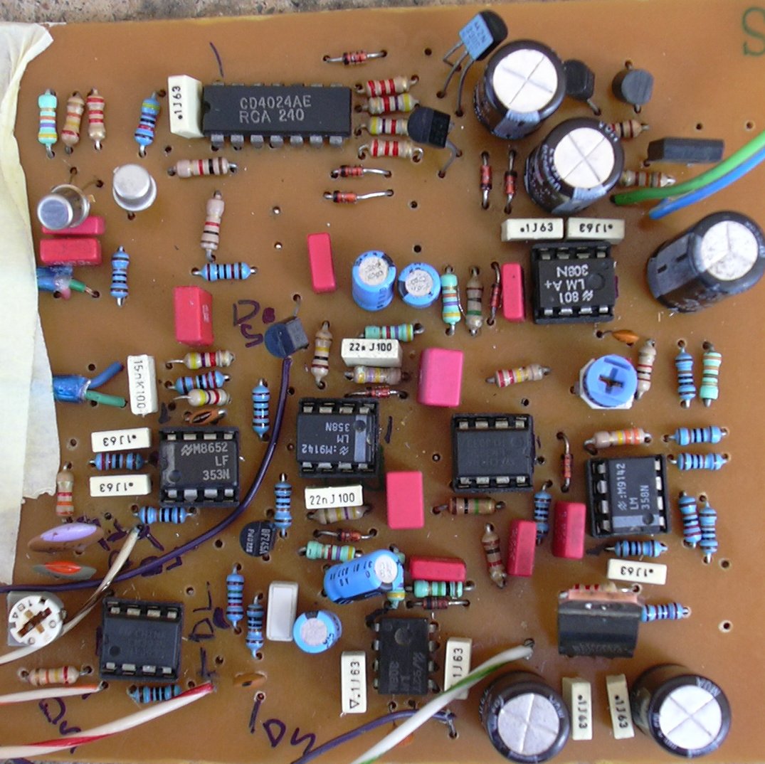

              • TGSL photo
                Dear Ivco
                here is my TGSL last V
                • metaldetector107

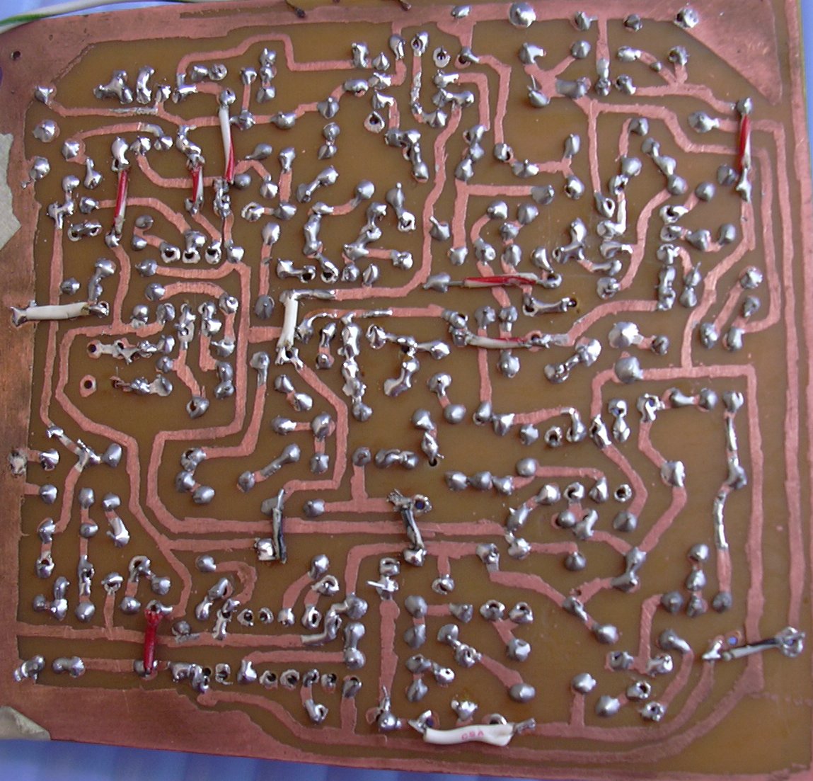

                  Just a quick observation, Where are the jumpers? (as this looks like a one sided PCB)
                  Also photo of other side (solder) may also be helpful...

                    Can you measure voltages at each input of u106 (pins 2, 3, 5, 6)?
                    Also voltages at inputs of u107a (pins 5, 6)?
                    Also output of u107a (pin 7)?
                    Thanks,
                    -SB
                    • last TGSL
                      Last TGSL pcb bothsides with oscil
                      • Originally posted by metaldetector107 View Post

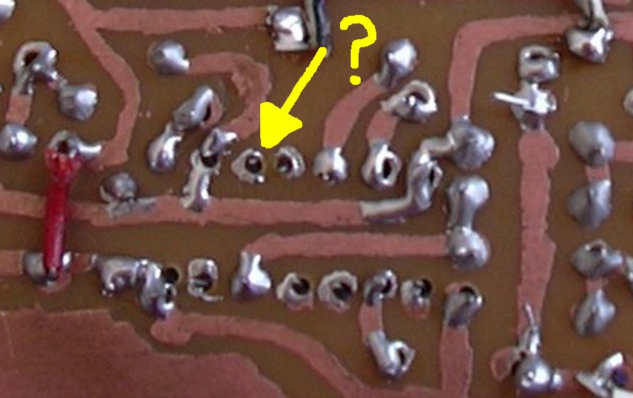

                        I don't mean this in a horrible way, but .... you do really need to practice your soldering. No wonder you have so many problems. For instance, have a look at the attached picture. Does this look like a non-connection to you?
                        Personally, I would suggest examining your PCB solder joints with an eye glass, and re-soldering the ones that look suspect.
                        • I agree. Sorry, but your pcb is horrible! I wanted to void any remarks on that, but is better to say - better for you. Also i do not want to offend you or hurt your feelings, but it is real wonder how it is working after all?
                          Jumpers must go on other side, soldered as they are now may short some traces (if not already).
                          Quiaozhi is right - you must recheck all soldering points again. Each one. Also you must recheck all the traces and eventuall breaks in those.
                          Behavior you explained leads me only to suspect diode(s) at 4024 outputs or mailfunctioning of chopper stage (negative voltage generation). But you already said those are ok and that you also measured proper negative voltage...so...i am confused, dont have idea what else should you check.
                          Most probably you have something unconnected or shorted there , on your pcb.
                          Do recheck everything. Use any method you can.
                          • Actually those failed solders are for unusued pins,
                            but metaldetector107 put a light on the other side of the PCB and look from the copper side for shorts an micro cuts !
                            We can see you put a lot of efforts in making this detector,if you continue i´m sure you will suceed.

                                I think the advice is good to check the solder joints. Some places look almost like "solder bridges", where solder touches the wrong copper trace.
                                You can check if you have mistakenly short-circuited two traces together by using an ohm meter to see if there is zero resistance between traces that should be separate.
                                Because you said your detector always gives tone, I asked for voltages on u106 LM393 chip. If the "+" inputs are both greater than the "-" inputs, it will give tone. The "-" inputs should be a very small positive voltage, very near to zero.
