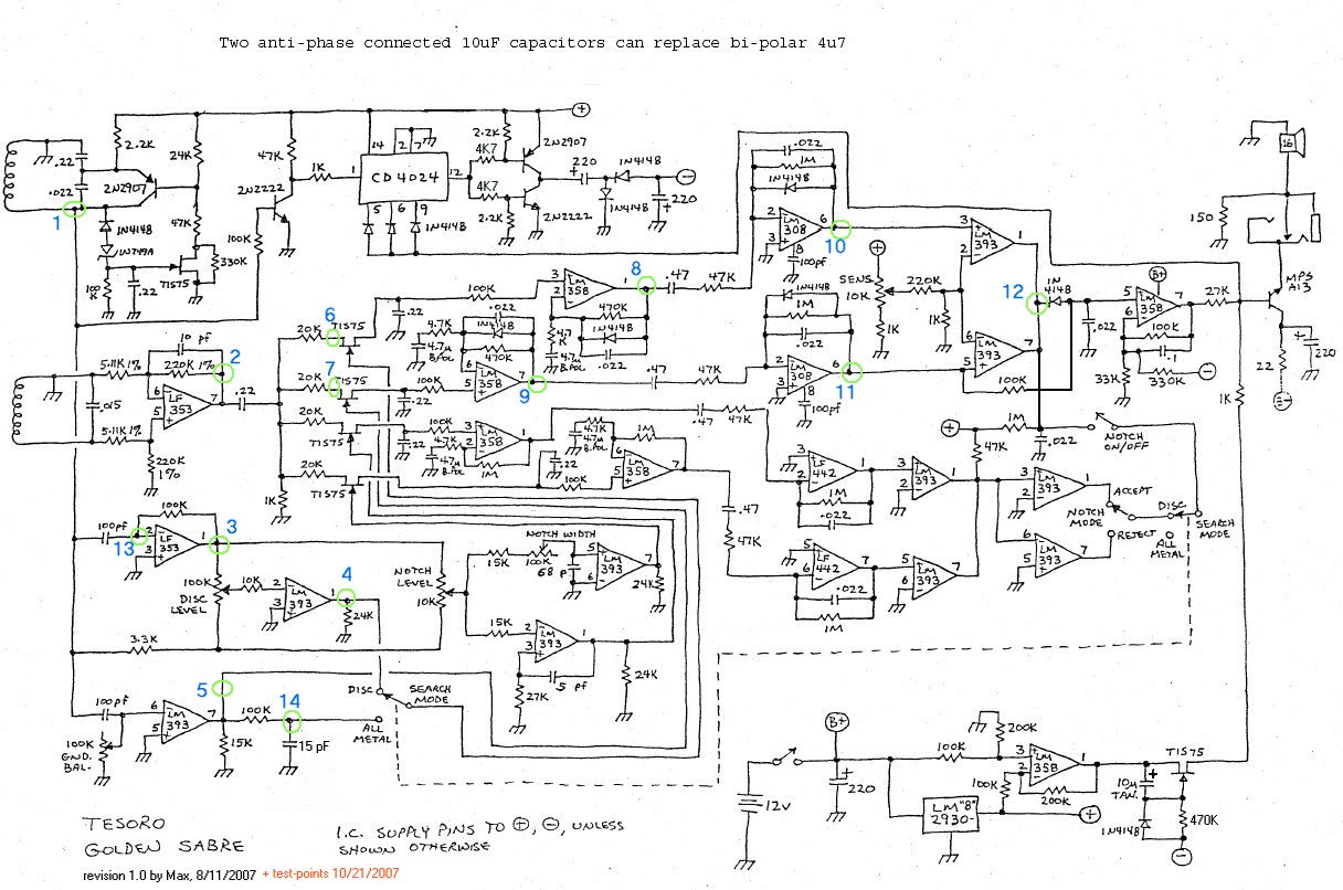

          1.ICs are fitted with socets!I think that this is not the probleme because I use same way on my first device!
          2.I draw my PCBs on hand and they are not 100% the same.This could be the reason.But my first device PCB is hand drawn too.But they are the same.
          I will check all again and will post here.
          • Hi
            HI,
            Also my TX frequency is 28,5 kHZ for both devices.
            How can I reach 14 kHz buy adding or taking off some windings?
            Max please look the numbers from my previous post and tell me are this the numbers for 255 DD.
            Thanks.
            I use 100 w 0,25mm wire.
              HI,
              How can I reach 14 kHz by adding or taking off some windings?
              By adding between 3/5 - 4/5 existing windings, if your measurement was correct and you measure basis frequency and not only some parasite frequency.
              • Might be the frequency 14.25kHz, only you measured second harmonic?
                If you respected datas i posted earlier (255x137 and wire 0.25...107w and 102w...or simillar) than it is almost impossible to achieve 28.5kHz frequency! Impossible!
                Which type of frequencymeter you are using?

                  Hi Ivconic,
                  I agree.
                  This project is not one that should be attempted lightly. There are mainy gotchas along the way that will inevitably lead to huge frustration, both for the person building the detector, and for the other forum members.
                  tiktak - The TX frequency you have determined is probably a measurement error. As Ivconic has noted, this is the second harmonic, which looks suspicious. Have a look at the TX waveform with a scope and directly measure the period from there.
                  If your comparators are in sockets, then that's most likely the cause of the instability, regardless of whether you claim to have had this working previously. It is bad practice to use sockets for comparators if the input signal hovers around the switching level, especially when there's no hysteresis. Do you have access to an oscilloscope? If not, then you will probably never be able to really fix this problem.

                        as previously noted your reading of frequency is sure wrong: second harmonic
                        Probably you have 14.25Khz but your meter cannot read it cause of e.g. bad sens at lower frequency (that's a bit suspicius cause often the lowest sens is at higher freq... but probably signal is distorted too).
                        Where did you measure frequency ? Which point ?
                        If you used collector of osc transistor you will read the frequency right way I think cause there are many volts there... if instead you read it at output of rx preamp (note that frequency is the same of TX cause it's air-core transformer) you could have troubles with low quality frequency-meter.
                        Try to read at collector of transistor... just there coil is connected to osc part on pcb: you will read it good if not distorted much.
                        If , in case you read at preamp good on previous detector, and now you read it bad... look : it could depend on nulling... more severe nulling to zero means less voltage peak to peak at output of preamp... thus resulting in unreadable or wrong reading on low quality frequency-meter.
                        Good numbers are 100 for tx and 105 for rx coil, wire 30awg (0.25mm bare wire).
                        I will look also at line regulation for 8 volts there: if you notice lower voltage try to investigate if there's something that need too much current and become hot there or if your supply goes down on voltage / protection cause of hi current absorbtion: notice also that some kind of speakers make it goes (when all ok) well over 150mA consumption when sound; on no sound you will get something about 30-45mA depending on stuff you use as components.

                          • Hi,
                            Ok.
                            So its mistake?
                            I remember that we discus the price of some good 2 chanel osciloscopes here?What were the number?
                            Max which transistor did you mean?2N2222 or 2N2907?
                            Because you told me to try measure from TX lead.

                                I meant test-point #1 , collector of PNP transistor at oscillator.
                                Look at picture.
                                Kind regards,
                                Max
