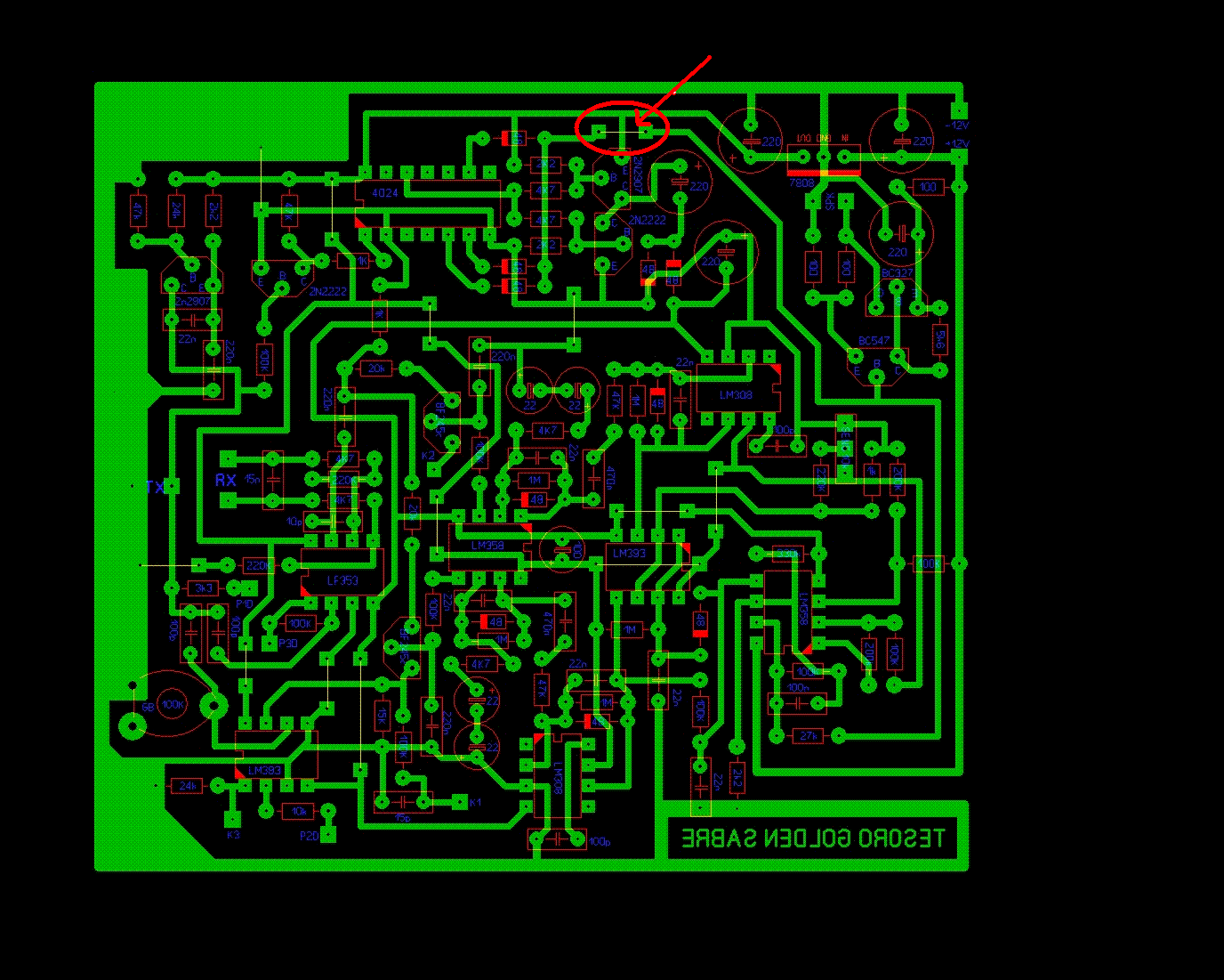

  • just built tgsl .got constant tone
    i have a constant tone i've nulled the coils at the lowest volume? it happens in the garden as well.when i lift the jumper circled (signal from 4024 ) in edwardo's pcb it stops and i have nothing at all. any ideas ?

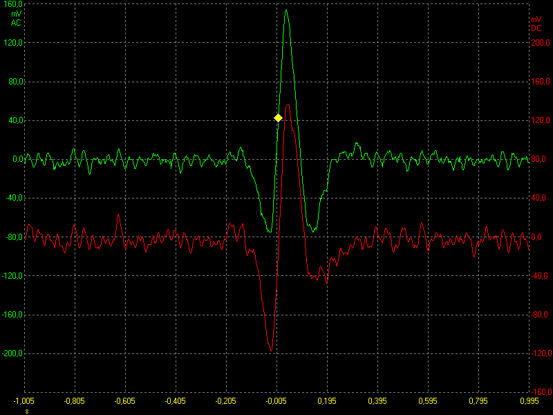

                  • Dicrimination made visible
                    Hi habitbraker -
                    Normally you don't center DISC sync pulse on zero crossing of null signal.
                    DISC sync pulse is typically centered on zero crossing of target signal you want to reject. However, we normally never see the target signals, they are too small! We just trust they are there and that they have a certain phase relative to the TX signal.
                    Yes, they are very , very small .

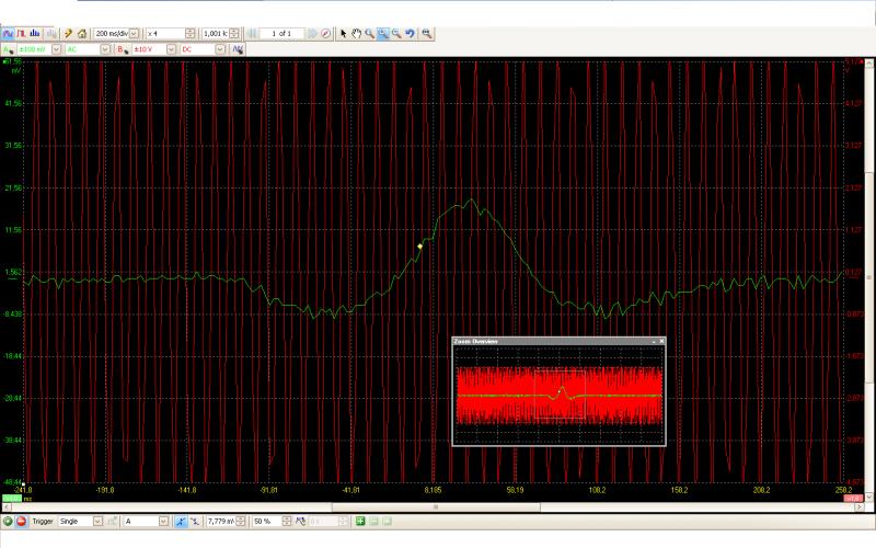

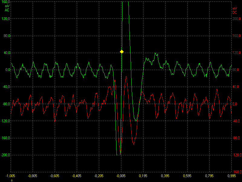

                    This graph is made on C12 direct output of the FET vs the TX signal, but I had to drag the coin over the coils to see this respons :
Name:	1 Target signal source TR4.jpg
                    I think it is (almost) impossible to see phase relative to the Tx , can't see which one triggers the target signal .
                    Someone any idea for this : I can ad a mathimatical channel to the scope ( for example A + sqr B ) ?

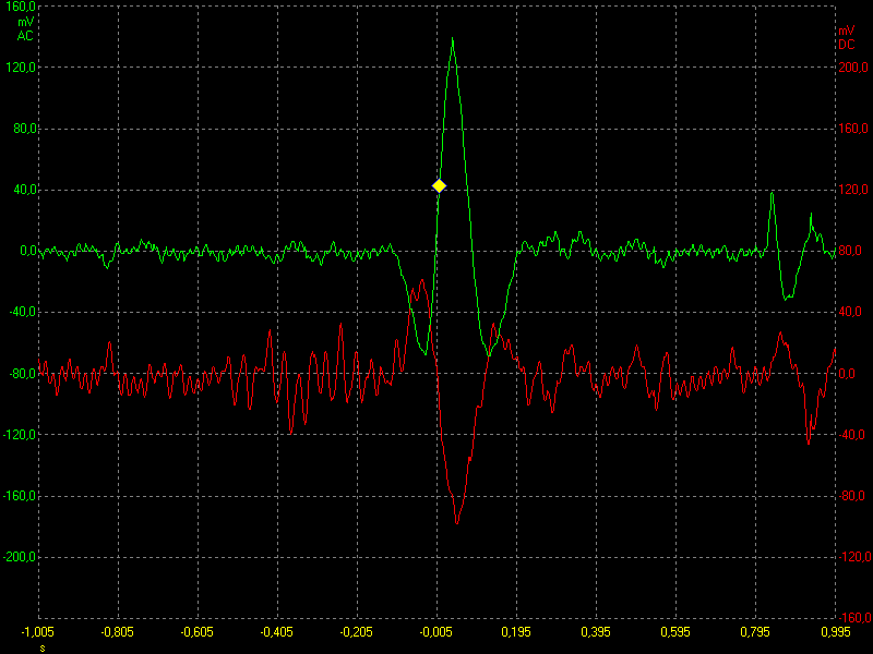

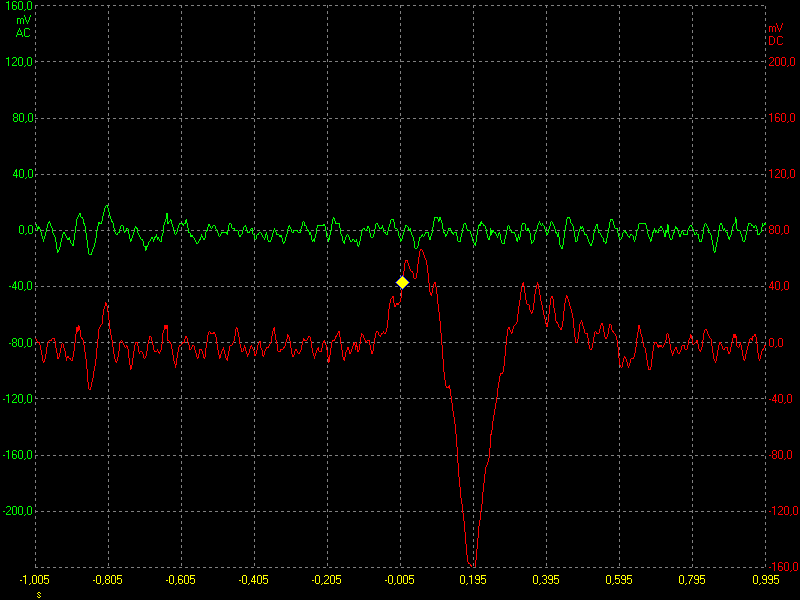

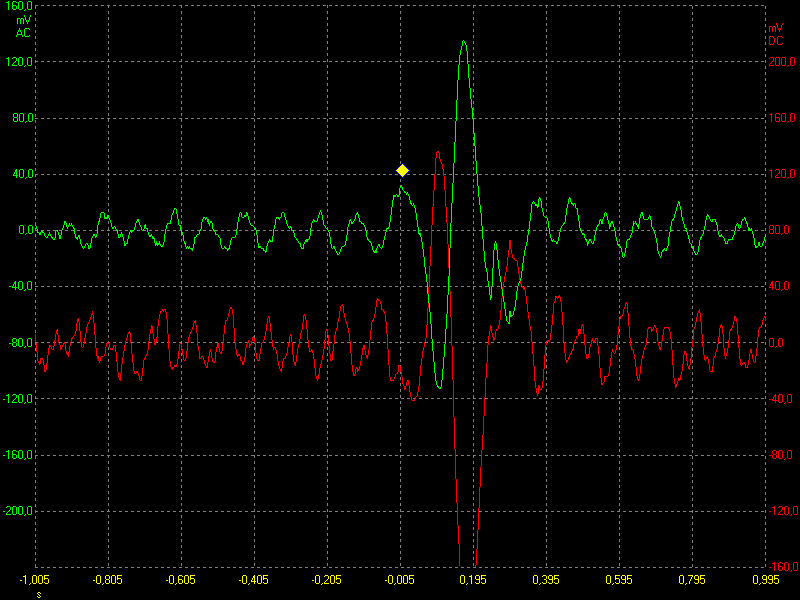

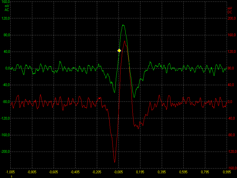

                    This next graphs show the results on the outputs of the LM308's
                    ( Green = U105 GB channel and Red = U104 DISC channel)
                    The phase of the target signals is completely independent of the null signal phase. You can change your null signal phase by balancing your coils, but it does not affect the target signal phases.
                    So if iron has phase1 and aluminum has phase2, we use DISC pot to center the sync pulse over the iron signal zero crossing. Then iron will have zero response and other metals with greater phase shift will make positive pulse.
                    Detection on piece of Al foil in AM mode :
Name:	3 AL foil AM mode.png
                    If we use DISC pot to center the sync pulse over the aluminum signal zero crossing, then metals with phase less than aluminum will make a negative response, and metals with phase greater than aluminum will make a positive response.
                    A nickel Disced out / rejected or 'nulled'
Name:	5 nickel disc mode rejected.png

                    Iron discriminated out :
Name:	8 iron screwdriver rejected disc mode.png

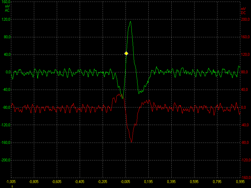

                    Detection of an 1 Eurocoin in AM mode :
Name:	2 eurocoin AM mode.png

                    Ferrite slug / bar 10 cm with GB pot set correctly in am mode
Name:	4 ferriet slug AM mode.png

                    Just a small graphical support for anyone's interrest
                    kind regards ,
                    Danny
