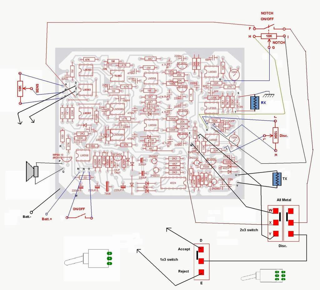

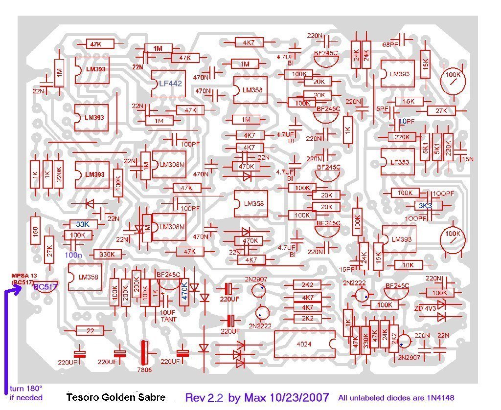

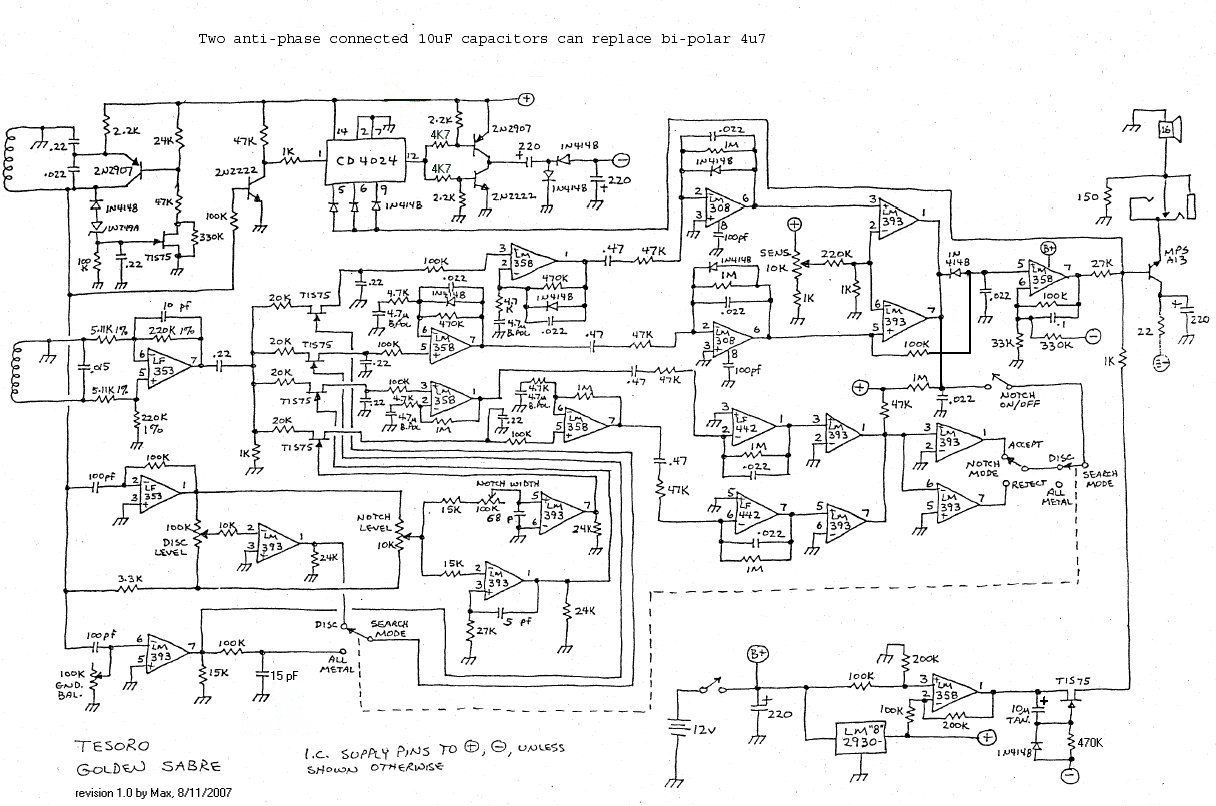

                      • TGS files for people who need them
                        I'm reposting the corrected files for people who asked me and that have troubles finding all stuff in this now very big thread.
                        About coil there are a lot of pictures on the thread by me, Ivconic and others so it's impossible reposting everything: I just repost data about large DD coil (10'' diameter).
                        WIRE diameter 30AWG = 0.25mm
                        TX TURNS = 100
                        RX TURNS = 105
                        TX RESISTANCE = (about) RX RESISTANCE about 22-23OHM
                        TX INDUCTANCE = (about) 5.7mH
                        RX INDUCTANCE = (about) 6.2mH
                        D Halve geom is about 255mm radius and 137mm height at middle, so 2 halves make a round coil of about 10'' or a bit more.
                        Both coils need shields with gaps (from 5mm to 1cm)
                        Kind regards,
                        Max
