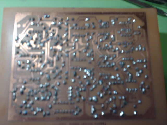

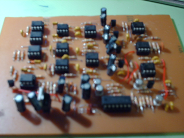

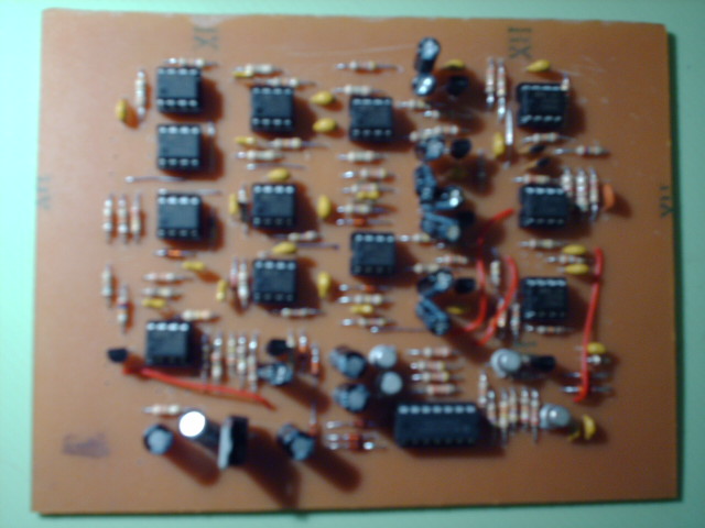

                  • Hi Ivconic.
                    Today i finish tesoro golden sabre pcb with all components on it.
                    Just need to know how to connect swithches and potenciometers. can you draw it on the pcb to get a clearly idea?.
                    For 4.7uF caps i took two 10 uF electrolitics caps and solder the negative lead to each other. Then i place the positive leads on the board, but the value measure with my L/C meter II B, show 2 uF. Is this a problem?
                    For coil i ll make the same that you post.
                    Nelson

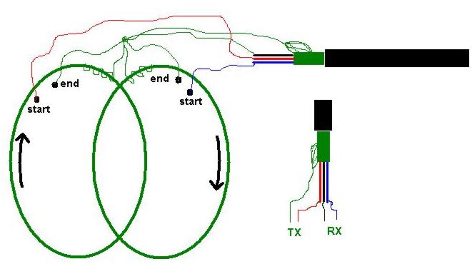

                    • Hi Ivconic. About the coil, is this configuration ok?
                      Nelson

                        ? Should read 5uF...or close?
                        Maybe you used bad capacitors?
                        Coil seems to be proper wired...it should work fine!
                        regards!

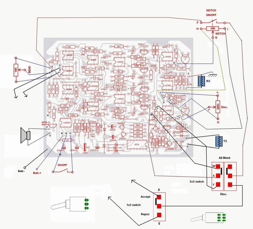

                          • I'll try to prepare for tomorrow, if you are not in hurry...Dont have it prepared....I dont understand? It is so easy and clear..? Just obey schematic and trace pcb....For testing purposes you may omit "notch" and all arround it...Only disc./all metal switch is needed....Sens.pot and ON/Off switch...for disc and gnd may use trimmers while testing...
                            OK anyway i'll draw pic tomorrow...

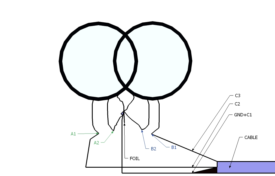

                            Here is more details about coil...
                              O.K. I did it now...Maybe a bit sloppy, but important is that you understand
                              how to connect those.
                              I guess there must be some other way to connect those, depends of what kind
                              of switches you may find...I connected it like this, since i had those
                              switches.
                              Switch On/Off may remain single, not attached on any pot, or can be in same
                              housing with Sense pot....never mind...
                              I wouldnt suggest you to use pot. for GEB, just leave it as trimmer.Adjust it
                              well on the ground, not to produce false signals while fast swinging over gnd.
                              Or you may use some hot rock instead real ground....or ferrite...
                              Do not forget those jumpers...What else...?
                              • Ivconic, many thanks for nice job you have done to help us with little knolegment of electronics.
                                Everything now is clear and tomorrow i ll connect those pots and swithces. I will also made the coil.
                                Excellent job and best regards.
                                Take care
                                Nelson
