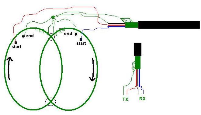

                • could be the reason for this that I use 10kB marked potenciometers for sens and notch?
                  Or I should search the problem in coil?
                  I have conected as on the picture posted buy IVCONIC.
                  The ends of the two coils are conected to shields of both coils and from there buy shield and one cable they goes in to the ground marked point for RX coil and Tx coil.And the start of the two windings are conected to other two points for TX and RX?
                  I cant understand why?But according to the picture this is the way!
                  How did you conect this?

                      I mean I conect for TX start of the TX winding and the other from the point where I have put together both coil ends and both shields!And for TX the start of the RX winding and again the point where the two shields and both windings ends meet!
                      • Hi
                        I conect like this!
                        Did you leave the two windings to tuch each other in circled areas?

                            I conect like this!
                            touch ??? you mean shields ??? NO.
                            Shields must be insulated each to the other... only connection you need is by shield wires ONLY. If you create a closed path between shields you get into troubles...
                            Best regards,
                            Max

                              • Hi
                                Then how?
                                And in what kind of troubles?Have I burned anything allready?
                                Please corect this picture!?!?
