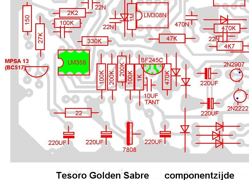

        When I have removed this LM358 no sound at all and also not working?
        What shell I try next?
          -Remove TR10, reconnect U107 (lm358 )... test.
          -Then also measure voltages +V and -V and report.

            • The + is around 5.7V I use two paralel 9v batteries!
              How to measure the negativ rail?I have here only cheep multimeter like on one of the ivconics picture of making DD coil!
              I have made DD 28cm with 0,30mm 115 TX ; 127 RX
              But when I remouve this LM58 I should cut batt check right?And the md should work?
                no when remove last lm358 you lose also U107a that serves to drive output stage so your detector can't work.
                I ask you do that to insulate fault... then you have to reconnect it.
                Measure negative rail putting your multimeter's +lead to gnd and -lead to -V rail.

                • Also 5.7 volts on +V rail is low... ? you would have 8volts !
                  One moment... 2x9volt batteries parallel ???
                  You are using too low voltage....
                  You give 9volts to circuit but lm7808 have a DROPOUT of about 3volts... that's not good! You need at least 12volt source...

                  • Sorry for boring questions but you mean this 358 and this transistor?
                        yes they are: TR10 is the bf245 related to batt-checker.

                          • hi
                            I have remouved this transistor and switch on no sound.switch off put 358 on place and switch on still that nasty sound~!
                              ok now we know that battery-checker is not involved.
                              So resolder TR10 in place (bf245).
                              OK. Possible fault is in signal path. You must check PCB following schematic from RX coil pads ahead till you find mistake.
                              Long work... I know, but only way to know what's wrong.
                              Check connections, check diodes orientations, check capacitor terminals of polarized ones orientations, check for short-circuits due to soldering ...
                              Problem is that your last op. amp is in saturation and something before it cause that problem. So your detector keep screaming... cause output stage is always in saturation.
