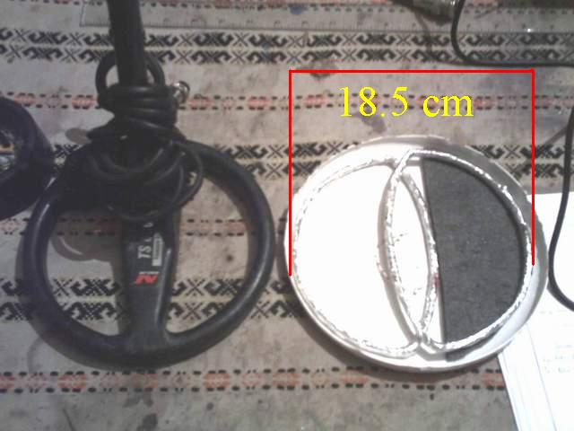

                  TS 800...Ts...ts..ts !!!
                  FINALLY !!! (capitals...ts,ts,ts...must be a crackpot?)
                  Finally i made coil,i always wanted to make!
                  But first i'll name conditions for "dream coil";
                  - It has to be small, smallest as could be!
                  - It has to be round, due comfort in movements,
                  - It has to be very sensitive on small (very small) items,
                  - It has to be deep....and I MEAN DEEP !
                  Only one coil i met so far fullfilling those requirements;
                  it was Minelab TS 800 coil (18cm)
                  1cm coin (i usually use for testing coils) it can detect at 22cm
                  in the air and 18cm in the ground!
                  So......
                  I made Golden Sabre and it showed pretty good performances with
                  two "casual" coils i made fast - "on the fly", last few days...
                  Yesterday i took TS 800 coil and redraw its shapes on plain paper...
                  And i done some calculations and made BEST coil so far...!!!
                  It is double D coil.....here is datas so you can make, test and
                  check my claims:
                  RX = 178 turns, 0.25mm wire (0.28mm with varnish), 23,6 ohms
                  TX = 165 turns, 0.25mm wire (0.28mm with varnish), 21,4 ohms
                  How can i explain former...? Huh? Here is photo of it. Diammeter of
                  whole coil (both DD shapes put togather,tuned and nulled) is 18.5cm...
                  so try to imagine how to make former...
                  I used Al foil for both coils as Faraday cage. Over foil i wounded
                  few windings with plain, naked (without varnish) wire to make good
                  conntact with foil. Over all i wraped simple adhesive tape to
                  consolidate, brace all...and that is all!
                  The rest, about nulling....you already know, i do not need to repeat here.
                  Coil performances are ....WOW !
                  Same coin it detecting over 30cm in the air!!!!! Much better than TS 800!!!
                  Cigarretes package at 45cm, cola can over 52cm.....
                  For coin:
                  Up to 25cm audio tone is loud,sharp and stiff!!! Over 25cm audio tone is
                  decaying step by step and a bit over 30cm it ends....WOW !!!
                  (up to 25cm constant flux, over 25cm it decreases....read bellow)
                  Promising....promising!
                  I'll have to wait until tomorow to test it on the ground. Few more steps left
                  to finish it; put in some suitable case,glue it...wait until drain...get dry...
                  I think i discovered "big secret" about coils...somehow...!?
                  Problem about depth is not closely related only to size of a coil. Much more
                  important thing is flux, magnetic flux! Density of magnetic field that TX
                  part producing...
                  It is not immaterial relation between size of a coil and wire gauge used in it!
                  How can i explain?
                  The higher density of magnetic field coil is producing - the better!
                  If choosing proper wire gauge than no need for much power on TX. Simple 2N2907
                  can do the job just fine. BC557 also.
                  Unlike in Anker detector and simillars, you dont need extra powerfull TX to gain
                  some depth! No not at all! Even oposite, powerfull TX is more like to "choke"
                  RX input and than another problem occurs - hums,false signals,interferences....
                  Totally unusable on the ground, especially on highly mineralized ones!
                  At the end, frequency is playing huge role when deciding about coil size and wire
                  gauge....I had luck (must admit) with this Golden Sabre, due its 14kHz frequency!
                  In the past i had a lot of "pains" and troubles trying to make Classic 3 go deeper
                  with small coils....no wonder!
                  So at the end conclusion;
                  "Larger" flux could be gained if preciselly chosen wire gauge and coil diammeter.
                  How to do that?
                  I dont know!
                  I dont have a clue!
                  I just had luck, this time!
                  Heh,heh,heh...!
                  Best regards!

                        Nothing is perfect! I spend few days on real field testing G.Sabre....Not so satisfied as i expected to be!
                        Problem is mostly in coils, although device have weak audio too, so i am not sure where exactly is problem. It would be much more easier if i have original coil....
                        Detection is deep in the air, but in ground it decreases, mostly cose audio is very weak so it is great chance to miss coin...It need to walk very slow with very slow motions not to miss item in the ground. But some fields need faster examinations...
                        I am not so sure in coils i made. Already showed excellent performances in the air and on my test field? But on the REAL field ...?? Huh!
                        For example if coin is at 25cm depth; until 10cm audio is loud and clear (no chance to miss it), but over 10cm audio decreases fast up to 25cm....At the end i have situation to doubt in signal; is it ground hum or detection?
                        I lost some nervs and smashed small coil!!! Heh,heh.....**** it! I'll make another!
                        One more thing bugs me; is it right to use same wire gauge for TX and RX???
                        So far i never saw coil like that, i mean original coil...? It is always thinner wire for RX and thicker for TX...?
                        Inductances and resistances are close...so i can not picture in my head how to gain those with same wire gauge and make proper coil???
                        All coils i made are workable....but in real conditions very average....Sheesh!
                        Is it because of coils or audio???

                            About coil : my DD seems fine and I use for both tx and rx 0.30 wire - same turns. Can detect
                            1 eur at 30cm in ground.
