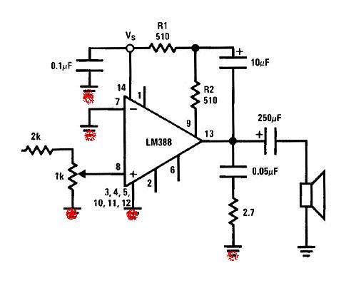

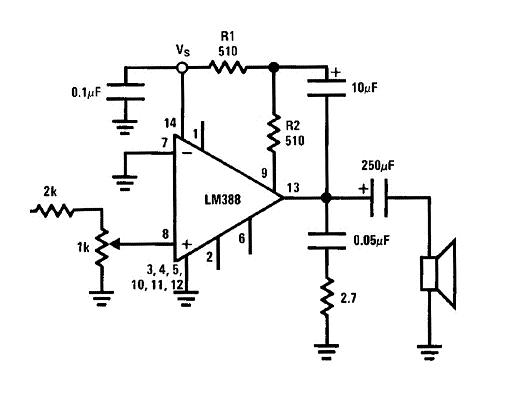

          • amplifiers..
            Hello Max and others..
            do not know about TBA820's but I'm very much satisfied with old lm388 - it works perfect. I connected it after C517 with 2k resistor it does just what's wanted: amplifies for 8ohm impendance speakers. Input resistor is really needed (or the amp. input is overloaded) maybe also lower gain transistor in place of C517 would be OK.
            Higher consumption could be a problem for someone (10-15ma) but personally I do not use 9v batteries for long time now.

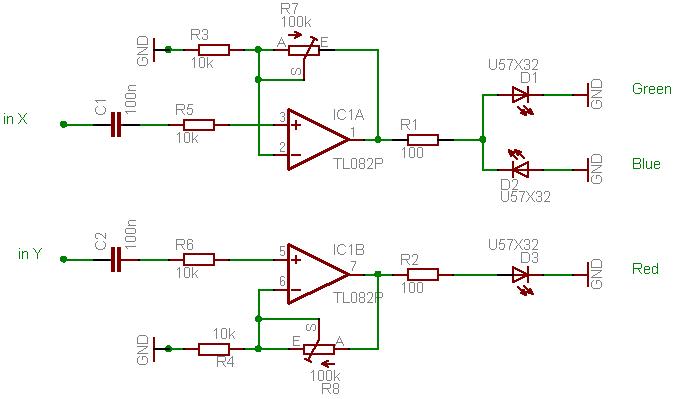

            • VCO
              Originally Posted by Max
              About tones... I think the way one could wire such a mod. is related to the 2 channel informations:
              watching at voltages of the 2 lm308 outputs is the key to get multiple tones.
              One could also use outputs of comparators near the sens pot.
              When iron is present channel output voltages are in oppositions, thus giving zero effect on output. When coloured metal is present, instead, channels have similar behaviour.
              That way is possible making a multitone information.
              Problem is that if you vary disc pot setting you'll vary also audio response, and that's no good, confusing the user. So a real mod. must be place disc pot as trimpot with minimum setting, then leave the user just ear the sound difference to disc stuff, not moving the pot (as in original GSabre design).
              Max very good idea to take audio input at 308 outputs. To avoid disc. pot problem it could be possible to add one channel only for multitone sound or use simply notch channell.
              For further buffer I found following shematic interesting (posted by rumenisat on md4u.ru-forum) It's purpose is: colour metal identification with RGB LED - kind of a VDI. It could be used also for trigger of two audio oscillators with mixer to produce audio multitone ID.

                              • Originally posted by Leto View Post
                                Hi Leto,
                                thanks for schematic. I've made with TBA820M and if connected like your (voltage splitter after c517) works really good, loud audio.
                                My problem was at first attempt cause I connected before c517... and there are voltages and impedance problems there.
                                TBA820M uses only 4mA when no sound... then consumption increase cause of sound to much more... it gives about 2W power on 8ohm.
                                The VID mod is really interesting, could be used to make a real useful multitone id.
                                I'll test it soon.
                                Thanks again,
                                Max
