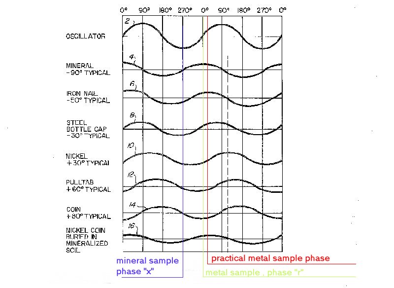

    Hi Max,
    I am pleased that you have independently confirmed that all the phase-shifts are to the left. Otherwise this was going to get complicated to explain.
    As far as the GEB channel is concerned, only metal targets cause a phase-shift. As these shifts are always to the left, a positive signal is generated that causes an audible beep in the headphones. That's why sampling at the zero-crossing is necessary. The ground (if not mineralized) only causes a change in amplitude, but no phase-shift. Hence there is no audible beep when the coil is lowered to the ground.
    For the DISC channel, the discrimination relies soley on amplitude changes - increase for non-ferrous and decrease for ferrous.

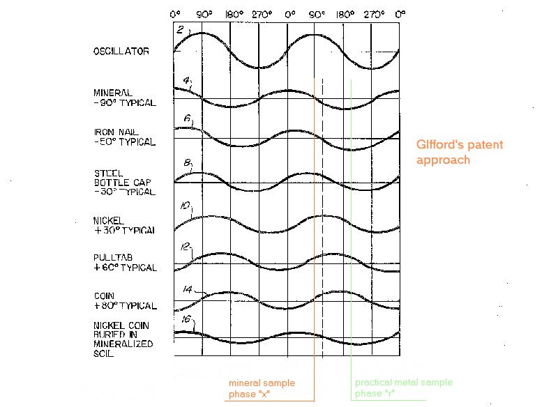

    The confusing thing about the diagram in the Gifford patent is that the phase readings are taken relative to the TX signal, and this is why you end up with positive and negative phase values.
    I've made a little mod to diagram... and this is what I think could be related to a real situation following your last posts.
    Please let me know what do you think about, if is correct or not.

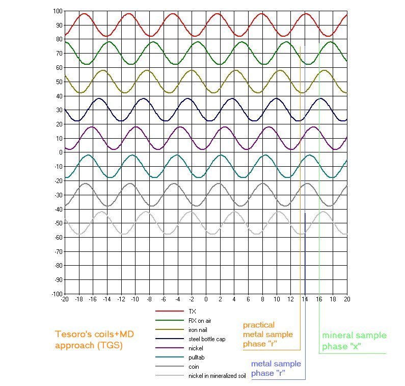

    The sample for geb is where RX goes from negative to positive: since ground itself doesn't give phase shift (or that cause one rotate knob to compensate phase related to minerals in soil in mineralized ground) we have no phase shift if bobbing the coil up-down for say 20cm from soil level , so the peak-peak amplitude rise due to to bobbing coil up-down is made of a positive and negative components of equal amplitude, thus resulting in no change in amplitude at geb channel cause of moving coil up-down during e.g. a sweep cycle.
    This, virtually, eliminate any ground influence on amplitude of signal at geb channel; when a metal is near coil the effect will be always the same, rise or fall in amplitude due to phase shift (in diagram is fall but nevermind cause the negative half-wave slide to right due to metal presence).
    About disc channel, instead, we can find a pi/2 (90°) shift for ideal sampling of a quadrature demodulator; in practical terms usually the sample is delayed a bit more and then a better "separation" of target composition is realized.
    Since we are (on disc channel) sampling near the positive peak of wave and rx signal slide to right when metals are present, there will be positive readings for relative phase shifts under 90° or a bit more degrees, then after we'll see negative readings of amplitude for larger phase shifts.
    This way, in that diagram, we'll end up with a positive reading for e.g. iron and a negative reading for the "coin".
    Now, actually, what happens in Tesoro coils is the opposite we see in drawing, cause RX shift happens to the left respect TX reference but apart this the system works exactly like explained. Then e.g. inverting amplifiers will convert negative rise into a positive rise etc giving right signs to voltages.
    I miss something along the road ?

        • Hi Qiaozhi,
          I don't know if it is right... maybe you could say that.... but I tryed to make a diagram of tesoro's coil response to targets like in original patent but considering left phase shift as happens on it and we see on the screen.
          I've added also points where I think sampling is done...
          Maybe this could make more easy to figure out device working...
          Do you think it is right or I made a big mess ?

              Hi Max,
              I don't think this is quite correct.
              The Gifford patent can be a bit confusing, especially when you start building your own detectors, and the results don't appear to match.
              I think the main problem is that the Gifford patent shows the phase-shifts associated with an under-nulled coil, whereas the Tesoro coils are over-nulled. (See my previous reply to zzy.) This means that all the phase-shifts are to the right, and the metal sampling point is on the negative-going zero-crossing, not the positive-going, as for the Tesoro. You should also note that the MINERAL signal is actually the RX signal in it's ground balanced position (i.e. no metal present) and this has been assumed to have a starting phase-shift (relative to the TX) of -90 degrees. For the Tesoro coils, this phase-shift is something like +30 degrees.

                sorry if this story is going long time... but I'd like to understand which are correct diagrams for both the patent and the tesoro mds like TGS and this stuff is bocoming really confusing now.
                Please look at corrections. Do you think are right this way ?

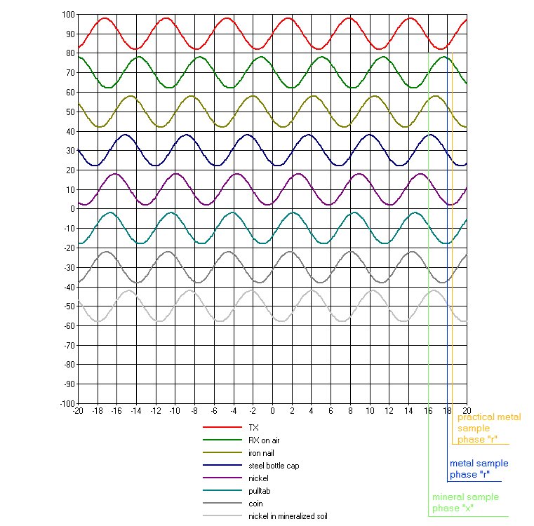

                  • Hi,
                    I've checked bandidoII and TGS switching stuff...
                    and it's this way like in first picture.
                    The fact you read negative amplitude for non-ferrous is not a problem cause there are 2 inverting amplifiers along channels in the chain... so , at the end, the result is the same as Qiaozhi wrote: non-ferrous will give rise of amplitude on disc channel before comparator, non-ferrous will give fall in amplitude in disc channel before comparator. Both ferrous and non-ferrous items will rise the amplitude of geb channel before comparator.
                    The combined effect is that the non-ferrous are detected and ferrous are masked out by opposition of signals in the 2 channels.
                    GEB sample intercepts the positive edge zero-crossing of RX; disc instead intercept the positive peak of RX signal.
                    Qiaozhi... what do you think ? Is correct now ? (I hope so...)

                            Hi Max,
                            Your description is correct, but I'm not entirely sure about the diagram. I'll try to create something if I get some time.
                              Hi Max,
                              thanks. I've used a small math program to make drawings of waves.
                              It's name is "advanced grapher" (something hi-shool tool I think), it's a shareware software you can find here:
