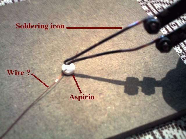

      I think all missunderstanding is about wire gauge?!
      When i said 0.25mm i always think on 0.28mm with varnish.
      How to measure wire gauge without jitters?
      Varnish can be easilly lysed by acetisalycylum acid.
      Where to find acid? Remember Aspirin from Bayer?
      Tablet is protected with very thin acid "film".
      What you have to do is to lay wire on tablet and heat both
      with soldering iron until melted a bit.
      After second or two, you will notice how wire become
      "silver", due tin which coated it.
      Last step is to use smallest grain sanding paper possible,
      to sand wire good and carefully.
      When wire is clean and shiny you can measure it accuratelly!
      No jitters at all. Than you can be sure what gauge is that!
      That is my method. I always perform measures like that.
      All my claims, datas on wire gauge are based on measurements
      as described...
      P.S.
      It will be much easier if you obtain liquid acid and "wash"
      wire in it to dissolve varnish.
      When i dont have Aspirin, i use lighter to "burn" varnish, but
      this method can give you some jitter...

              • Excellent medicine for varnish remover, ha ha ha .
                But anyway i tried this and it works great, thanks Ivconic.
                About wire, no dubs, it is 0.25 mm and 0.28 mm vith varnish. I got it from the wire factory and is label 30AWG. I also measure with and without varnish with digital instrumentation, and it´s ok.

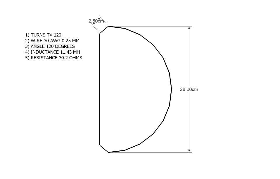

                      • Hi Ivconic. Well this really looks like a joke, today i took my GS to a local park and after 30 minutes i got losts of coins with it. Also it shows me that GS is really a good machine, solid sound on coins and good discrimination too, same has you. I also compared with my ACE 250 and i must recognize that golden sabre is much much better. So the circuir is really working has a champ.
                        The only think that still keep me busy, is a good coil, to allow me to get coins and others stuff deeper.
                        I am really confused now, don´t know if i finish the 28 cms coil with 11.43 mH for TX, 120 turns, 0.25 mm wire, 30.2 ohms of resistance and same form has you did or i should take less turns to reach the correct impedance (19 to 22 ohms).
                        Here i m posting a sketch of my coil details. I also check resistance with another multimeter that shows 31.6 ohms, so the problem is still on the coil.
                        Anyone that can help i ll really apreciate that.
                        Best regards
                        Nelson

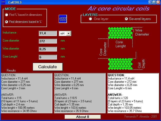

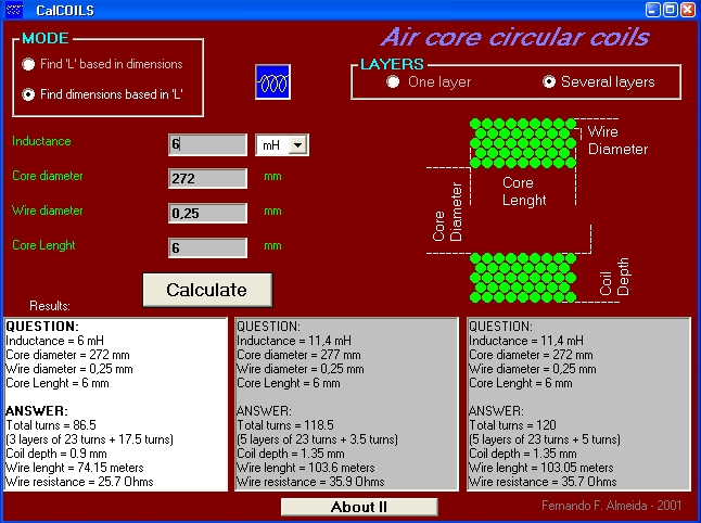

                        • Hi again. I also have calculated two coils for TX. One with 11.4 mH, that is the one i have with 120 turns on a 28 cms form. The other is for 6 mH and turns is around 86 for same form dimension.
                          This shows me that my measurements are correct, but still don´t know where is the problem. See my previus post that show my coil form and dimensions. Are this correct?
                          See the simulation below.
                          Nelson

                                Hi Nelson,
                                you are doing a good work on your coils. Let me say that I think you'll gain great experience and skills making your coils. Same thing happened to me.
                                As ivconic stated many times... inductance matching is not so important if you know what are you doing... just you need to match the tx operating frequency as expected (but also this point you could even change, then making minor changes e.g. on some caps in the circuit) and get a good nulling on rx. Both tx, rx matching expected resistance values within 10% tollerance.
                                And all your coils will rock.
                                To answer your question:
                                I always noticed that adding shield increase inductance. Adding foil you get a increase of inductance, of course. Also with aluminium/mylar I use is the same... but I get less added inductance that way (al film is really thin).
                                You have to remember leaving always the gap in the shield and have two different (insulated) shields for both coils. Then just use two bare wires to connect to gnd point at cable inside the coil housing. Remember, do not create closed electrical paths between the two shields, this would affect performance, so insulate each other using e.g. tape or paper.
                                Another trick to avoid too capacitive or inductive added effects is to space the shield from the wound. It's described on BBSailor article on fast monocoil for PI, but principle is always good if you need less cap. or ind. disturbance on shielded coils. Use polyethilene spirals for this... but in VLF just you don't need that stuff I think. I never used in VLF, but only PI coils.
