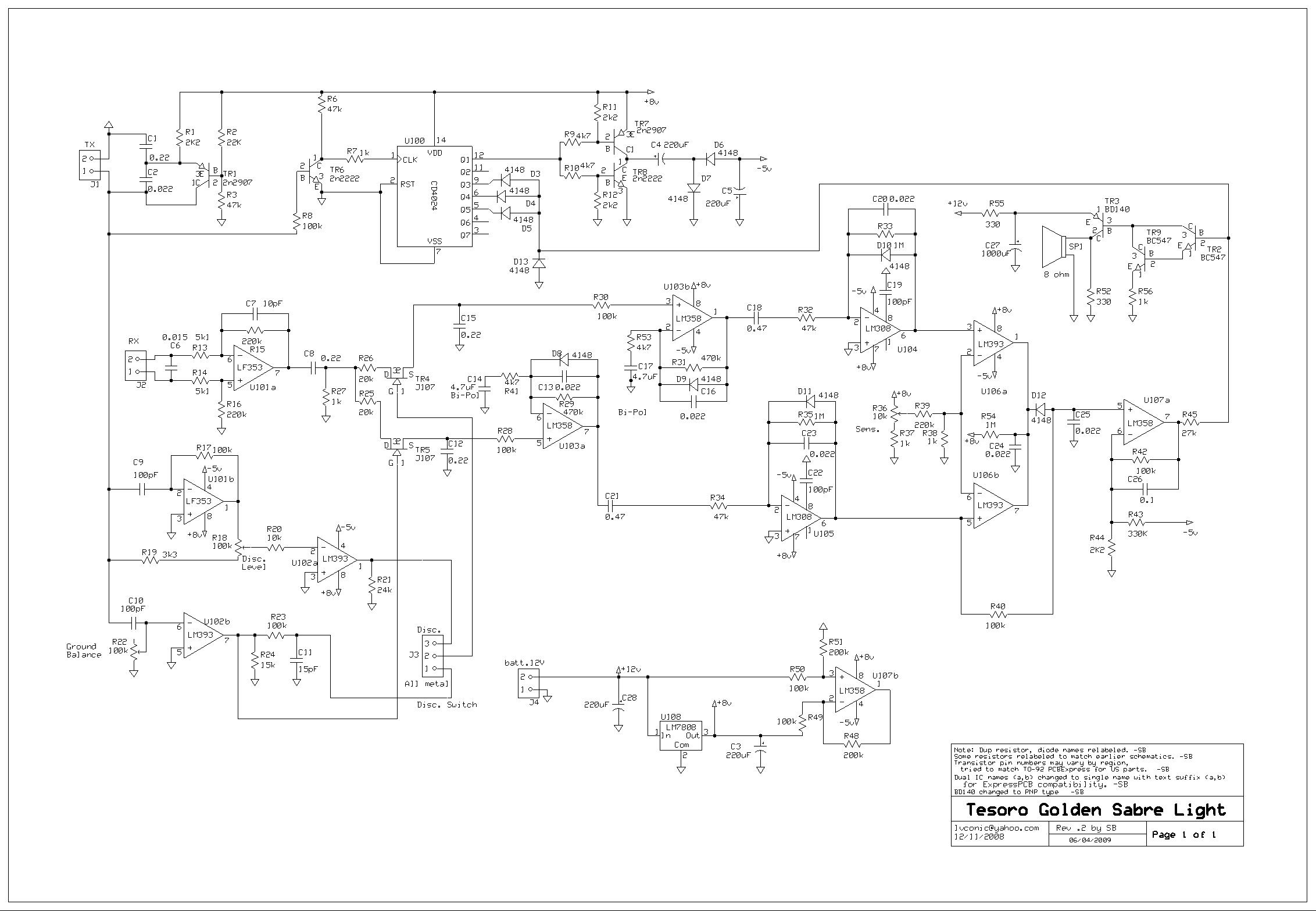

      Hi Ivconic -
      Referring to your "TGSL Final" schematic audio amplifier section:
      1. Did you try using an MPSA13 or other Darlington in place of the two BC547 transistors? Or is there a good reason to have the two BC547?
      2. Why is emitter of TR3 (BD140) connected to +V, instead of collector? The circuit seems very unusual, how did you decide on it?
      -SB

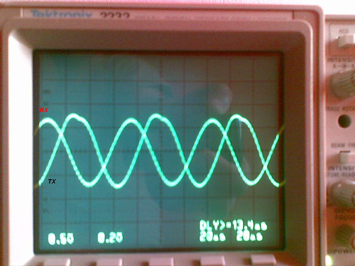

        Then use tx signal to trigger the scope (channel1) and get rx signal at output of preamp (on channel2): you'll spot the phase between tx and rx signal when no metal near... that's interesting measuring phase angle to know if your coil is made properly and you can disc the correct way...

          • Referring to your "TGSL Final" schematic audio amplifier section:
            -SB
            Sorry i missed that question!
            1. No i havent tried MPSA13 or any simillar there.
            2. Ha,ha,ha,ha! Guys from Cscope decided that much more before me!

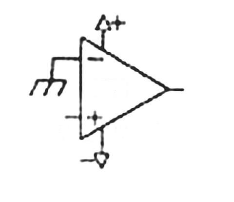

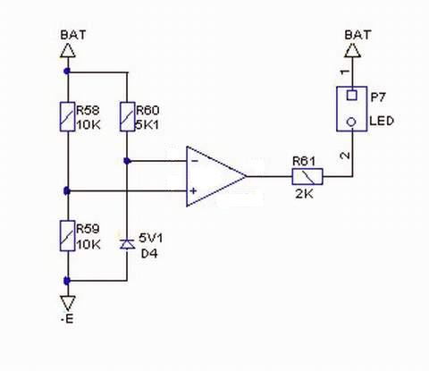

            • "...Also on simpler way to disable inputs on unused u107b I mentioned previously?..."
              For example it may be used as battery monitor. Or...it may be "neutralised" simply as on pic...
                -SB
                Thanks for answers.

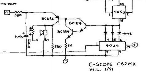

                I don't want to bother you, but can you check the CScope schematic? Because it really looks like the collector and emitter should be interchanged, according to normal circuits.
                I could not find any circuit (common base, common collector, common emitter) where the emitter points to the +V supply like that -- just looks like mistake ?

                  Ok, I think I see problem.
                  BD140 is drawn on schematic as NPN transistor, but is really PNP, right?
                  I'll fix schematic and upload if you think that is correct.
                  -SB
                  • BD140 is PNP, yes. Did i used wrong symbol there!????
                    Let me see.....YES I DID!?!?
                    Sorrrrrryyyyyy! My mistake!

                      I thought it was obvious from where i took that part..
                        Thanks, that explains it -- I knew circuit worked, but couldn't see why!
                        Thanks also for posting original circuit, it's useful to see it.
                        I will update the ".sch" ExpressPCB file that I uploaded before and upload it again with the PNP style transistor.
                        Cheers,
                        -SB
                        • Updated TGSL Final schematic with BD140 PNP
                          Here is updated schematic for the record.
                          Changes: TR3 BD140 transistor changed to PNP (was NPN).
                          -SB

                              Max.
                              So,TX sin is ok, p-p is ok.
                              You can see here TX/RX.Is this ok?
                              The coil disc good.Only sensitivity is poor.Why?Where I have to look for problems?
