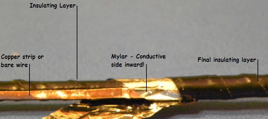

                      With my latest coils ive been using mylar cut from camping covers conductive side up so i can wrap directly onto the well varnished windings then a thin single copper core wire wraped widely around the top of the mylar all the way around for the earth connection, then insulated.
                      Don, what are you using for shielding and how are you connecting to it, by any chance do you have a pick of that last coil before you pot it?

                          Well impressed Don, as said considering your next to a steel garage door as well its remarkable, and gives us a good insight to how are machines should perform.

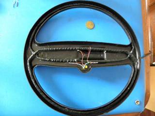

                          I don't have a picture of that "exact" coil but the one pictured below was made the same way. I quit using this coil because it's noisy in wet grass (grounded per TGSL coil making). I was using copper tape for my first few coils (like this one) but subsequent tests showed that copper tape was not the best choice. I since settled on the mylar survival blanket idea.

                            Could you explain what the problem is with copper tape as shielding material? Reduced sensitivity? Instability? I haven't used it but I would have expected it to be similar to aluminium foil (except that you can solder to it) which seems to be widely used.
                              I will have to scope it out to see what the null looks like but pretty sure it's not right.
                              Nice job Don
                              Are you putting the mylar shield directly onto the windings conductive side upwards then connection wraped on as I do, or the origonal way of insulation tape then shield connection wire then mylar wrap conductive side down.
                                Nice job Don
                                I have been running a thing stip of copper foil around the coil and then a layer of mylar conductive side inward. That way, I have something to solder to.
                                Sensitivity is noticably reduced using copper or aluminum foil tape. I first noticed this when I made a couple of HH coils. One with Mylar was more sensitive.
