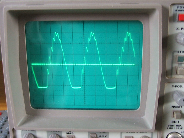

      Hello Ivica.
      Made a testboard, giving me also some problems. If I pas my hand over the print it wil give an echo..... can be becorse of the long connections.?!
      Can also be a problem in the desing from the print.......?!
      If I pul out the zener 4v3 I got the same signal at 353-1 that you have, look at the screenshot.The transmitsignal has so also some effect.
      The first board is working fine, it is the test board that gives problems, wel wil check and test tings, if answers are there I let you know.

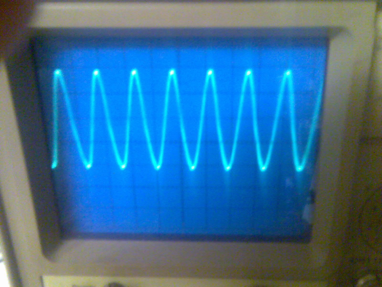

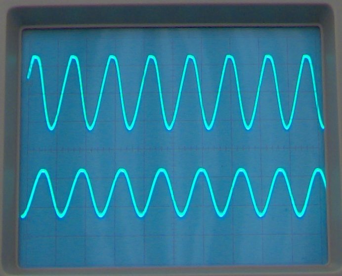

      • Hi. I traced the signal at pin1 of LF353 and it is a perfect sinus signal. No square and without any anomalies. But when i put the sens at max (>7) "at manual mode" i have a lot of erratic signals ( i connected the 1M resistor). At disc mode that i disconnect the resistor i can work with full?? sens(9...9.5/10).
        Generally at disc mode it is more stable but i think that it dont work good. So when i put the pot right then don't detect any coin but the same for the soldering cream can that it is from iron. I will try it more.....

            • I found the cable
              Yes i found the cable so i attach here the "signal at pin1 of LF353 " at my scope.

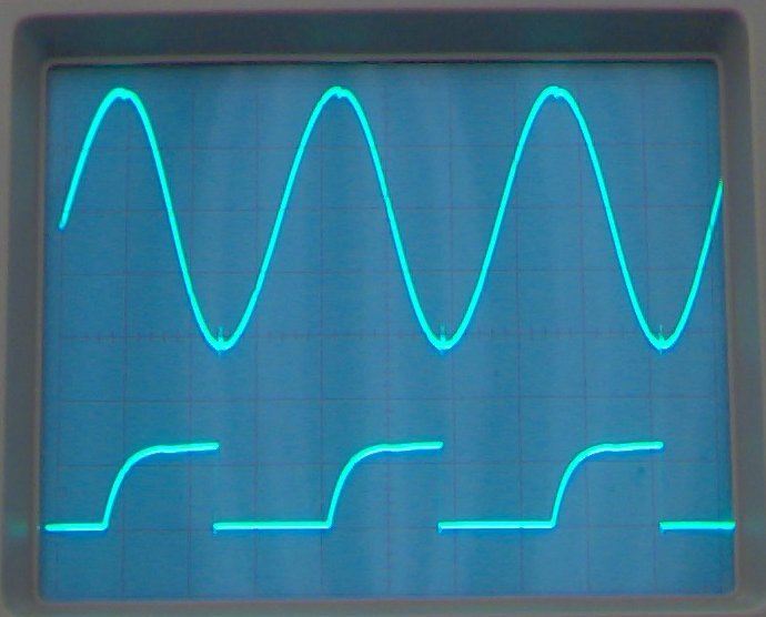

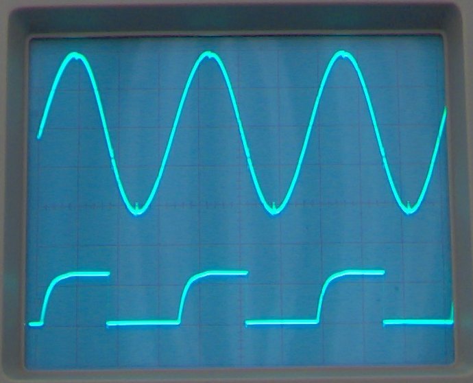

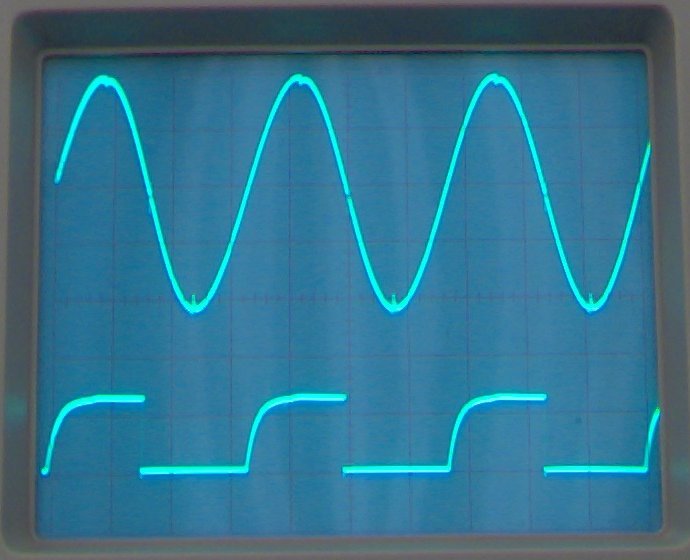

                  • ApBerg,Geo...it is strange? I replaced LF353 with; TL082,TL072,TL062,TLC272.....Every one gave me same oscigramm at pin 1. Same as i posted above??? It is not about LF353.
                    Come to suspect either to osciloscope either to method i am scoping pin 1.
                    Read this: gnd probe i do connect on gnd or -pole of accu, signal probe i put on pin 1. ...isnt that right?
                    So aleays i gain same oscigramm....and TGSL is working rally PERFECT. No difference between LF353 and TL082...2cm coin detect at 36cm in the air. No false signals,beeps, chatters - nothing. Stabile as stone. Same in All Metal mode, very stabile! I dont use 1M any more. Yes sound is weak, but as TikTak stated; you can always use headphones...until we make some audio mod...
                    And one more thing: i am usin 8 ohms speaker WITHOUT extra resistance any more! Now i have more elegant solution which affects overall performances in positive way; instead that 2K2 at last LM358 (on some schematics noted as 33K) i put 10K. Why? Simplyi founded it by experiment. Actually 8K2 is suited more but i took 10k...to have some reserve in audio on more mineralized terrains...If you interested play with it. You will see yourself.
                    One more thing; i think my oscilogramm (i posted here) is most accurate and that is the way it should be. To understand this you have to scope pin 2. of LM393 - input from Disc stage. You have to see and follow signal behavior from point where Disc is lowest to point where Disc is highest - adjusting Disc pot from minimum to maximum while scoping pin 2.

                      At the end it showed that oscillogramms i posted here (latest one)are accurate-no mistakes at all...

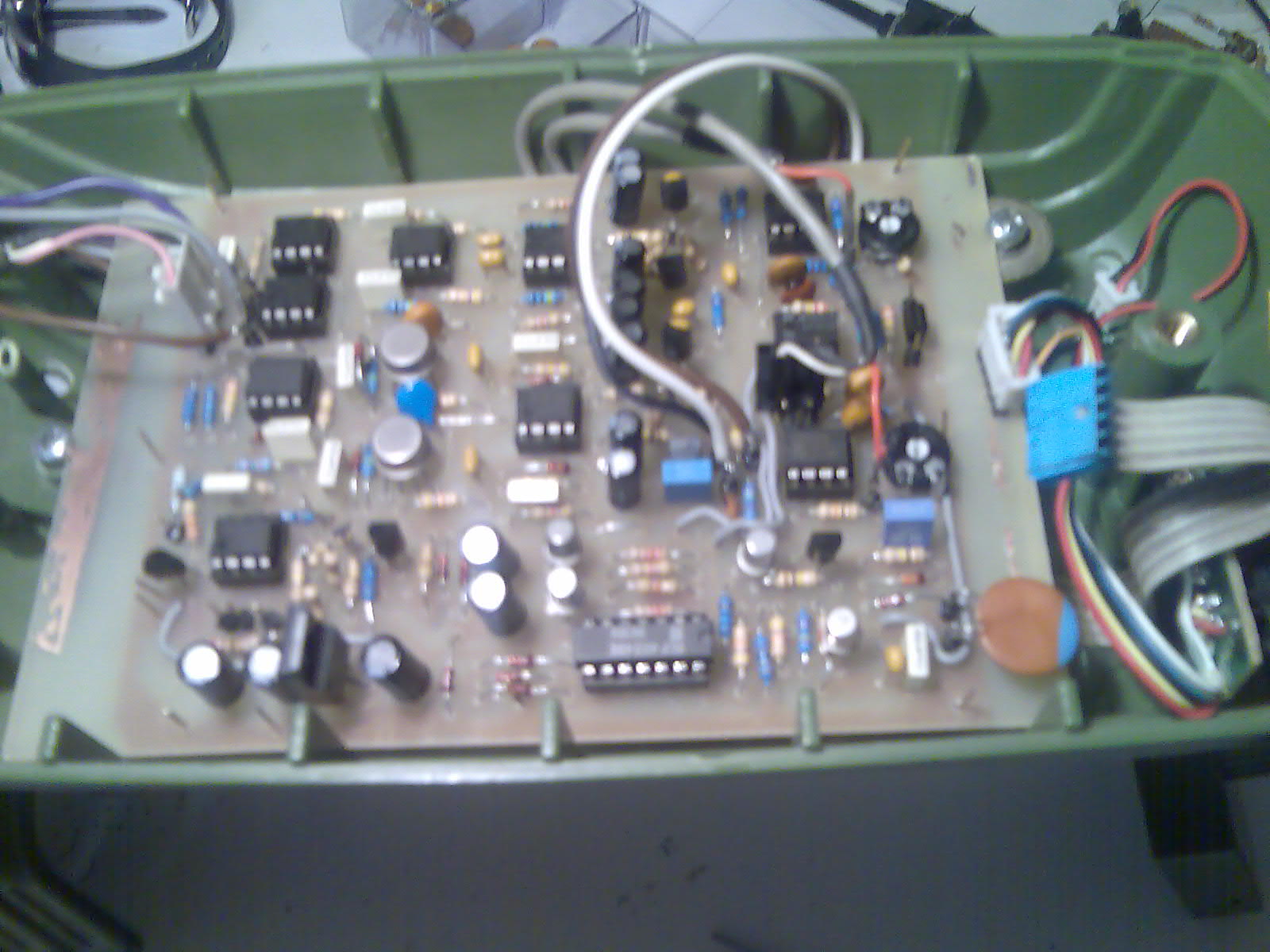

                          Hi Ap. I have a problem like your........
                          Sometimes when i touch the pcb or the coil housing or any wire i have erratic signals (beep...beep...etc). Other times it works ok. I think that it must be shielding problem. If i will find it i"ll write you. I must go out to test it (when rain stops) because i am afraid that at my Lab there are a lot of parasitic signals.
                          When the box with the pcb is at a position with the potentiometers to look the roof then i can put the sens to "7"position". But if i rotate the box with pcb 90degrees then i can put the sens at maximun.
                          What to say???

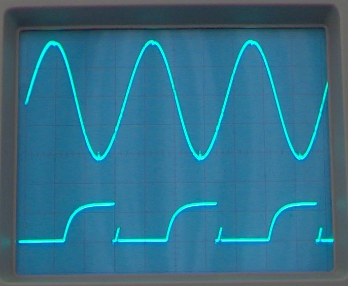

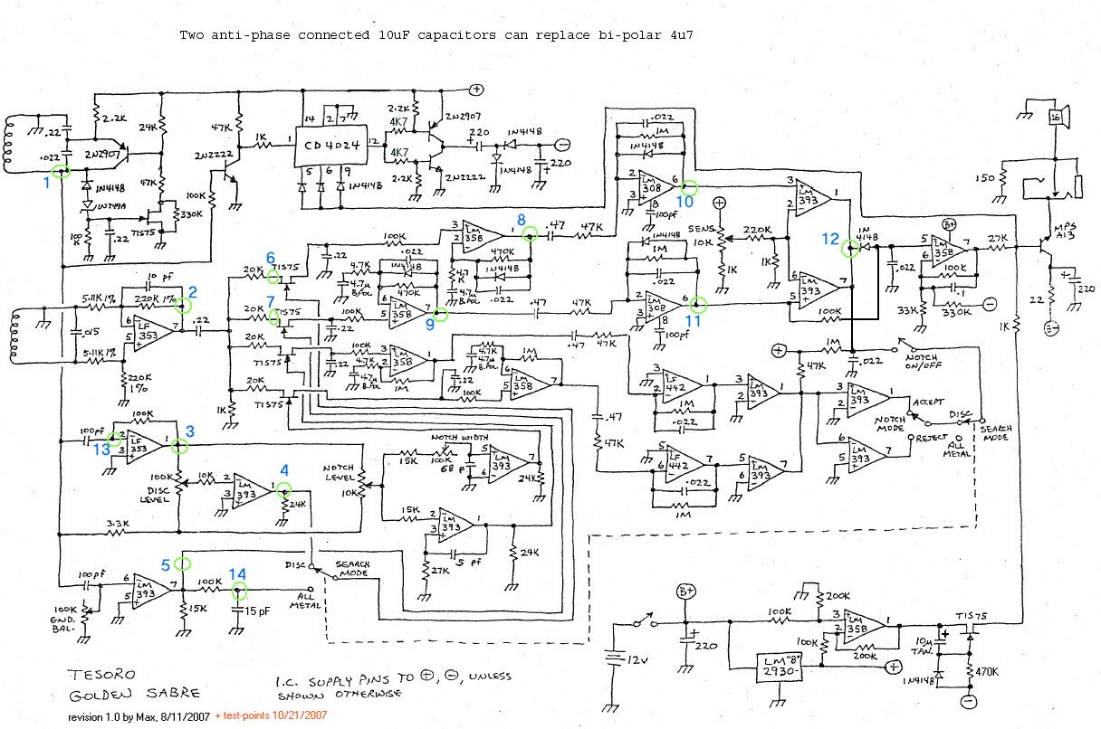

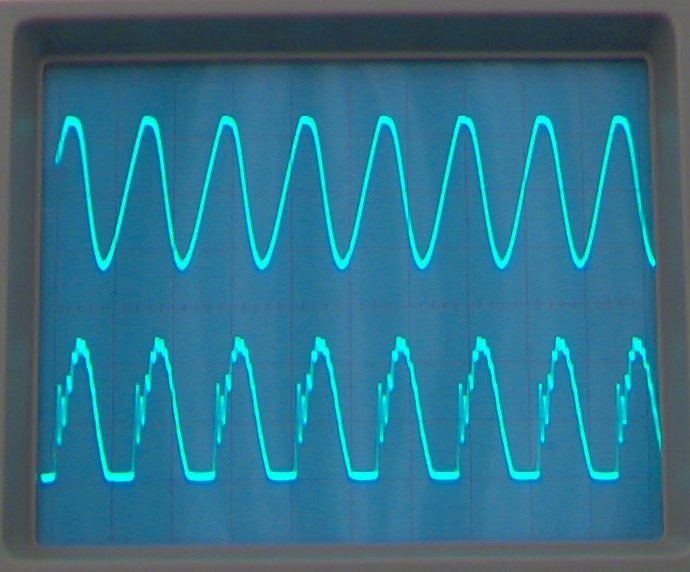

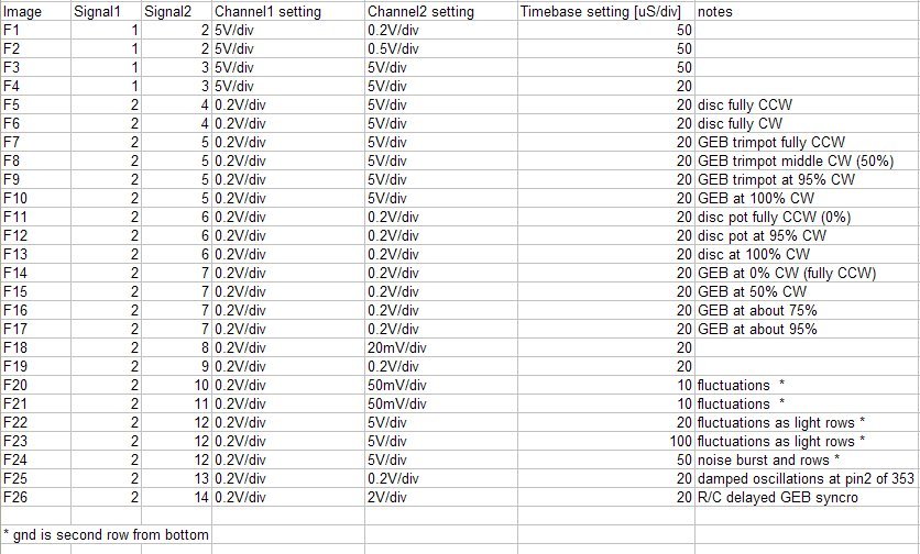

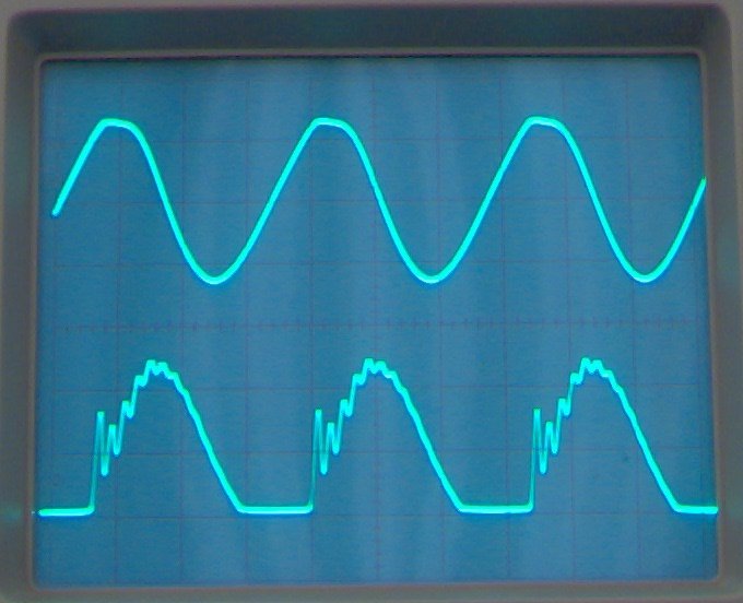

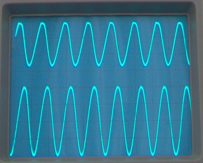

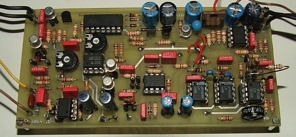

                              • Hi all,
                                early this morning I've made all the stuff... test-points map and pictures... very hard work cause I had to dismantle board... and I need in next few days... so now I have to reassemble again...
                                anyway, here we are ! A full set of traced signals from TGS.
                                I still have the problem at LF353... but cause Geo and Ap haven't in some of their measures I strongly suspect problem is related to my LF353 cause came from an old stock of parts, thought it's new and never used before.
                                You can see that problem occourrs just on pin2 of 353... where are dumped oscillations you can see clear in one picture.
                                I hope that's enough... cause otherwise I have to dismantle again and that's not so funny!
                                In the map you can see where test-points are an index for each signals, in the list you can see explaination of figures and references to measured signals.
