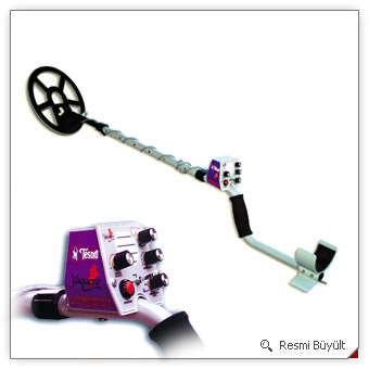

                        That is good new about the Tesoro coils, I bought a Vaquero yesterday

                          So you bought Vaquero!
                          Nice!
                          I have two friends with Vaquero's, those are very happy with it.
                          Which one you bought? "Germania" or "USA" ?
                          We noticed that those two are a bit different in behavior.
                          Now, since you have it, you must obtain coil connector for IGSL , to use Vaquero coil with it.
                          If you face some problems when using that coil with IGSL - pay attention on RX cap and try to adjust it a bit. Adding or subtracting from 15nF will tune up RX coil to match exactly.
                          As i recall... it will need a bit less capacitance than 15nF to match exactly the phase. Something between 14nF to 14.7nF.
                          Use Quiaozhi's calculator, it is accurate.
                          With TX part you will not have problems at all.

                                I got the slightly iffy "purple" one
                                I hope to be out with it Sunday, wish me luck !
