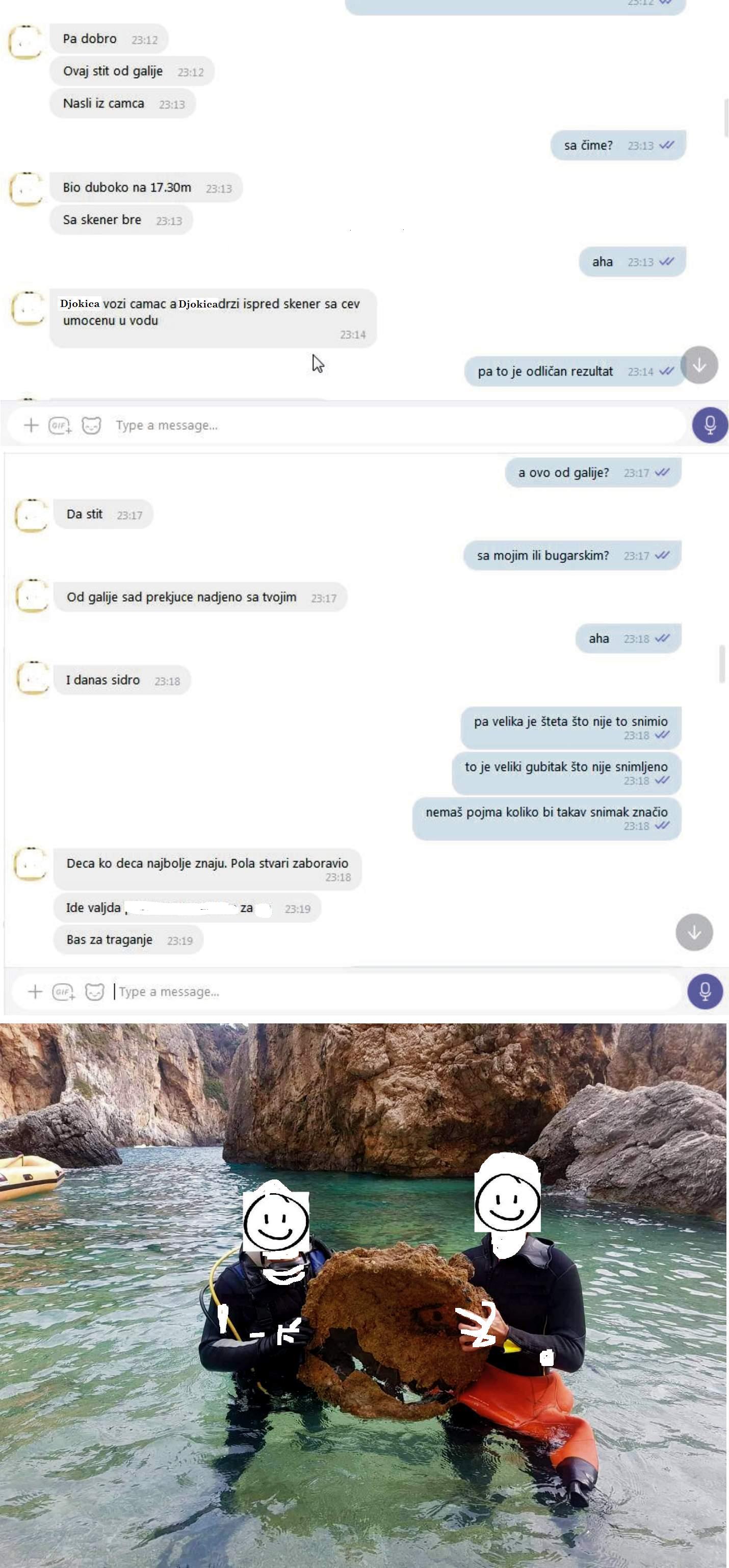

          I can write here numerous examples about some achieved results with such magnetometer. But it would be pointless. Because each example is a story on it's own.
          Some of the results are modest. Some of the results are unbelievable. I bet none of the readers will truly accept some results as true.
          For example, 17.3 meters in water on this:

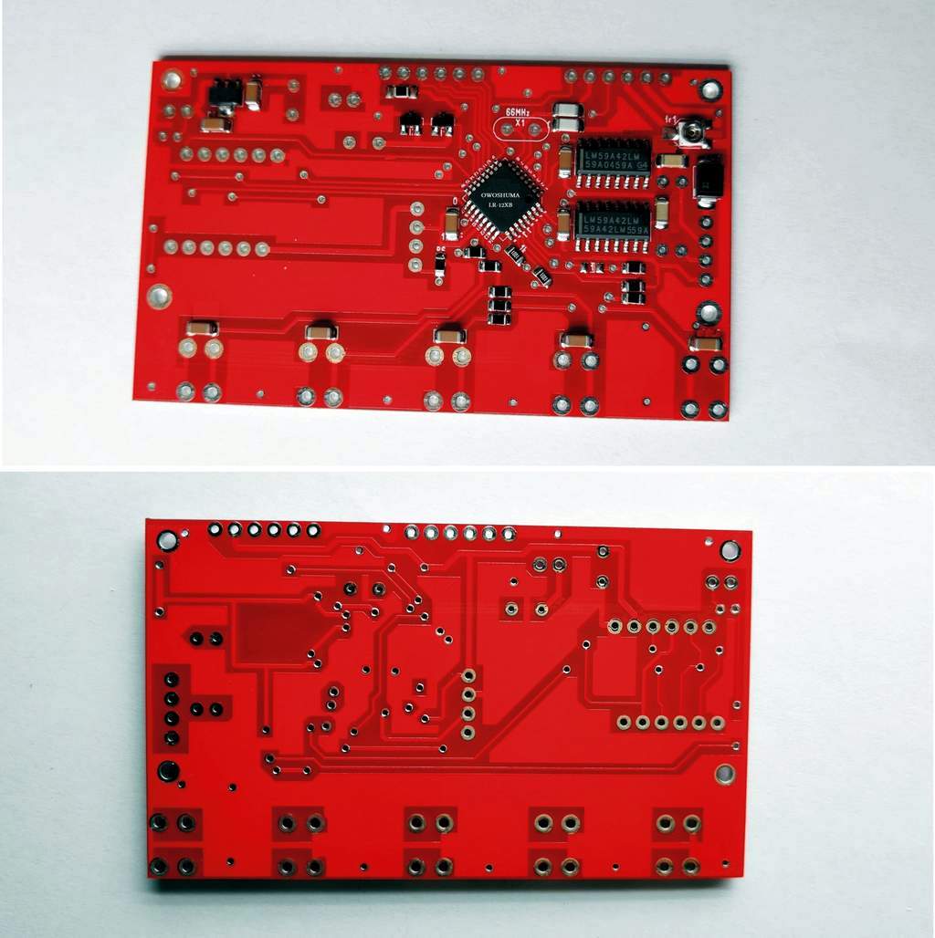

              • Soon to come.

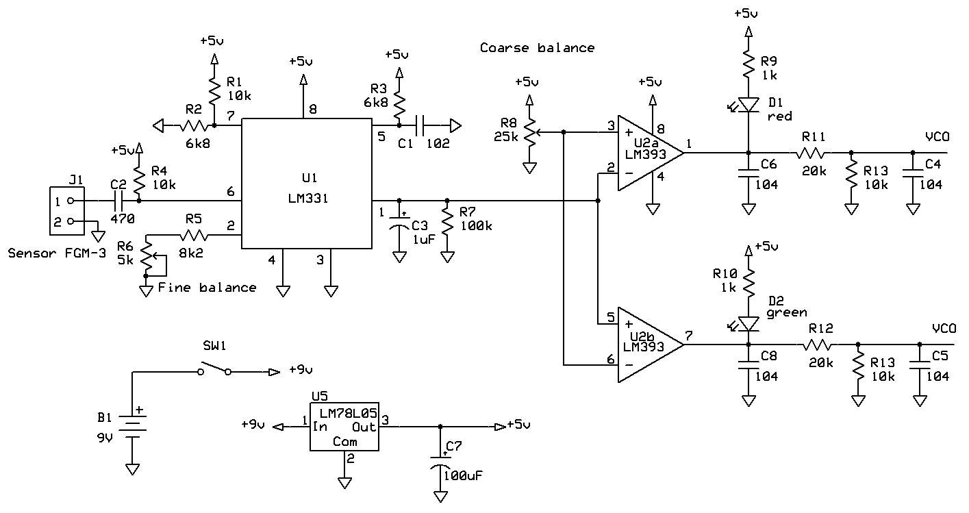

                • Any code-schematic to play with it //// Ι have 3d printer and an FGM-3H sensor.... any way to put sound buzzer to use it as the magnetic signal changes?
                  • Originally posted by LUPENGR29` View Post
                    Obviously i can not share the code because i take this as commercial attempt.
                    But if you have good will and interest; very soon i will offer SMD kits by affordable prices.
                    Will be available over ebay soon. I will post the news when it happens.
                    In meantime you can do lot other similar things on this subject.
                    You can use John Becker's approach, instead Microchip PIC; you can use simple comparator.
                    To be able to know when the magnetic changes happen; you have to establish reference.
                    For example; on single button press to take current value and use it as reference to compare with incoming readings.
                    Simple voltage comparator will do the job just fine. Before that you'll have to figure out how to convert frequency from sensor to voltage.
                    Simplest and cheapest would be use of LM331. Look up for datasheet.
                    Here is the example:
                    LEDs lit on polarity change, accordingly.
                    Further you can feed the output to some audio vco.
