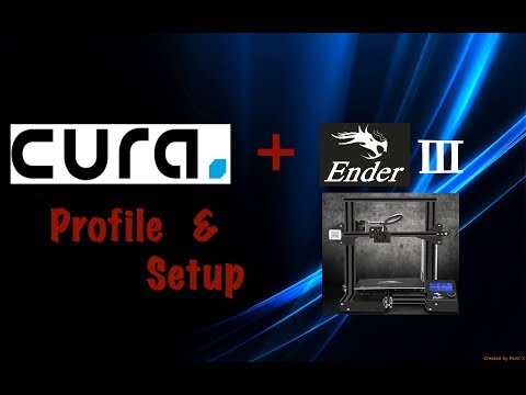

                    Be prepared to sacrifice quite a lot of filament during experimentation. Getting the nozzle and bed temperatures correct is important, and particularly the gap between the nozzle and bed. What surprised me was how little filament is actually used to create a model, and how long it takes to print. Printing from SD card is the most reliable.
                    Repetier-Host software can be used to slice the stl file, and shows how long the printing will take and how much filament is required. You can also adjust the printer settings from there.
                    Again on this...
                    Correct. I got 2kg filament, 2 colors.
                    I started several attempts and wasted ~50gr of material so far.
                    Than i changed my mind and stop printing those, because it was obvious that it is going messy from a start.
                    Than i start adjusting the finest details.
                    Very nice thing about Cura (i guess at other similar software too) is that you can set the printing "Profile" with all the details on settings included.
                    So step by step i made first good profile and saved it on disk.
                    Than i looked up for how other people did it.
                    And there is also another nice thing; you can export profiles and exchange with people over the net.
                    So i founded several helping demonstrations also offering printing profiles.
                    This is really good for a novice!
                    Saves lot of time and head scratching.
                    We can simply exchange profiles for different kinds of works.

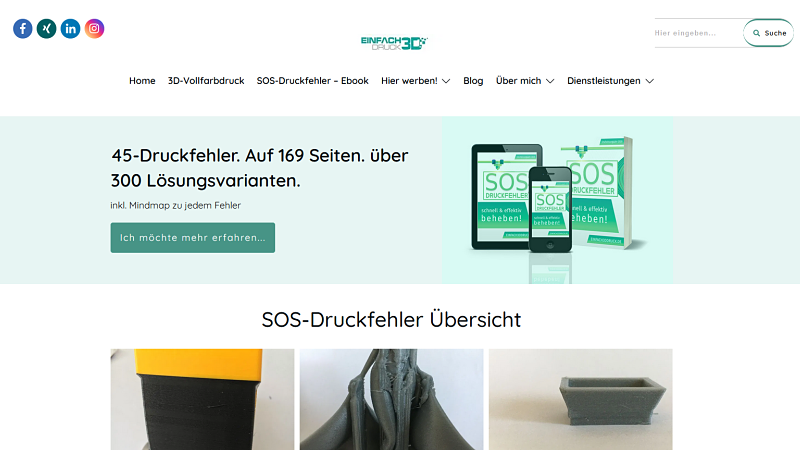

                        in german but i think it can help too
                        the most failures and what to do
                        https://einfach3ddruck.de/sos-druckf...ektiv-beheben/
                        last Weekend i got 1mm nozzle, printing is very quick now
                        for example for a 1mm wall the Printer drives only one time on the layer, with 0,4mm you Need 3 times (with a bit overlapping)

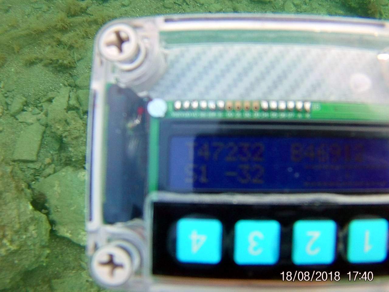

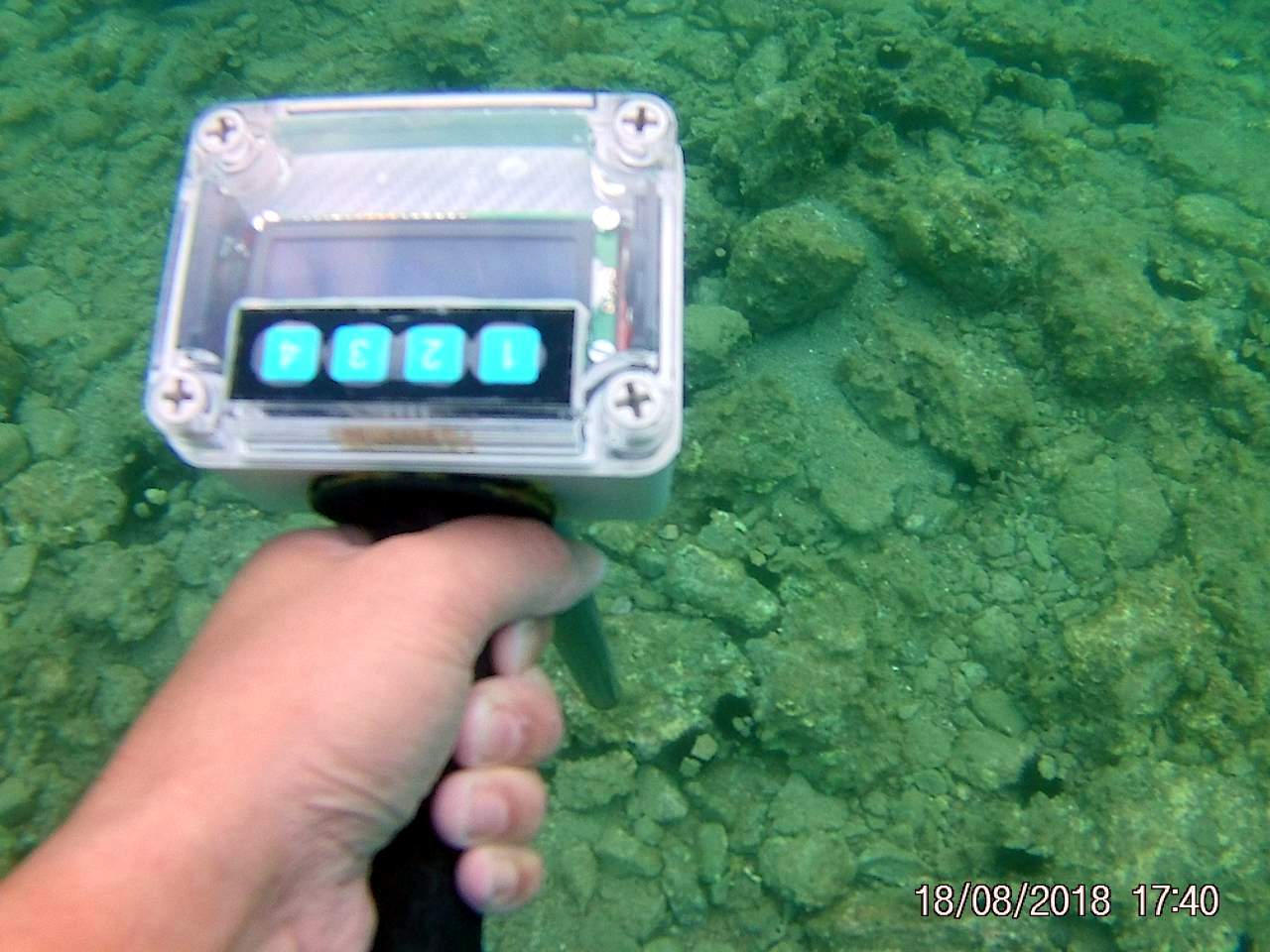

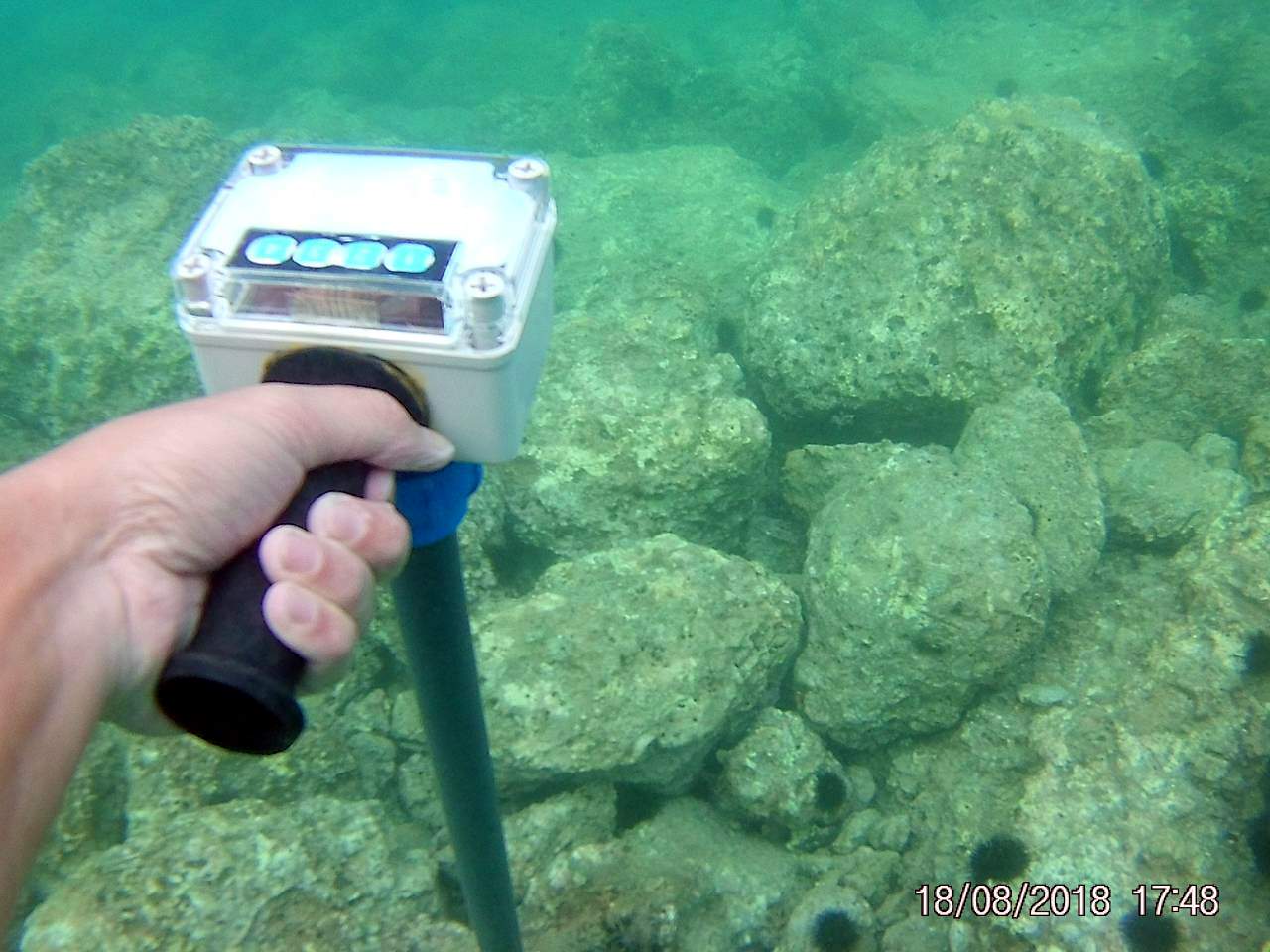

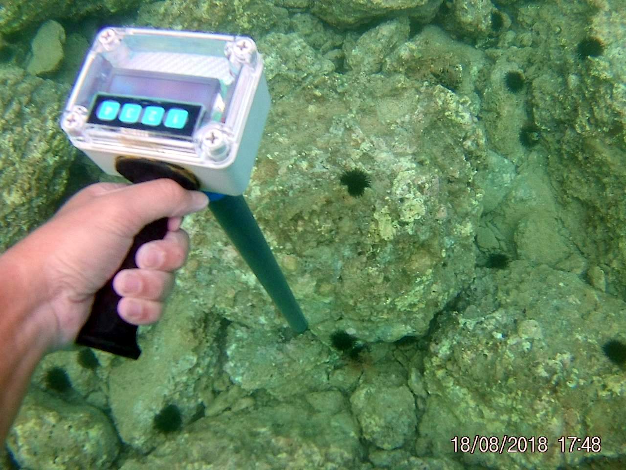

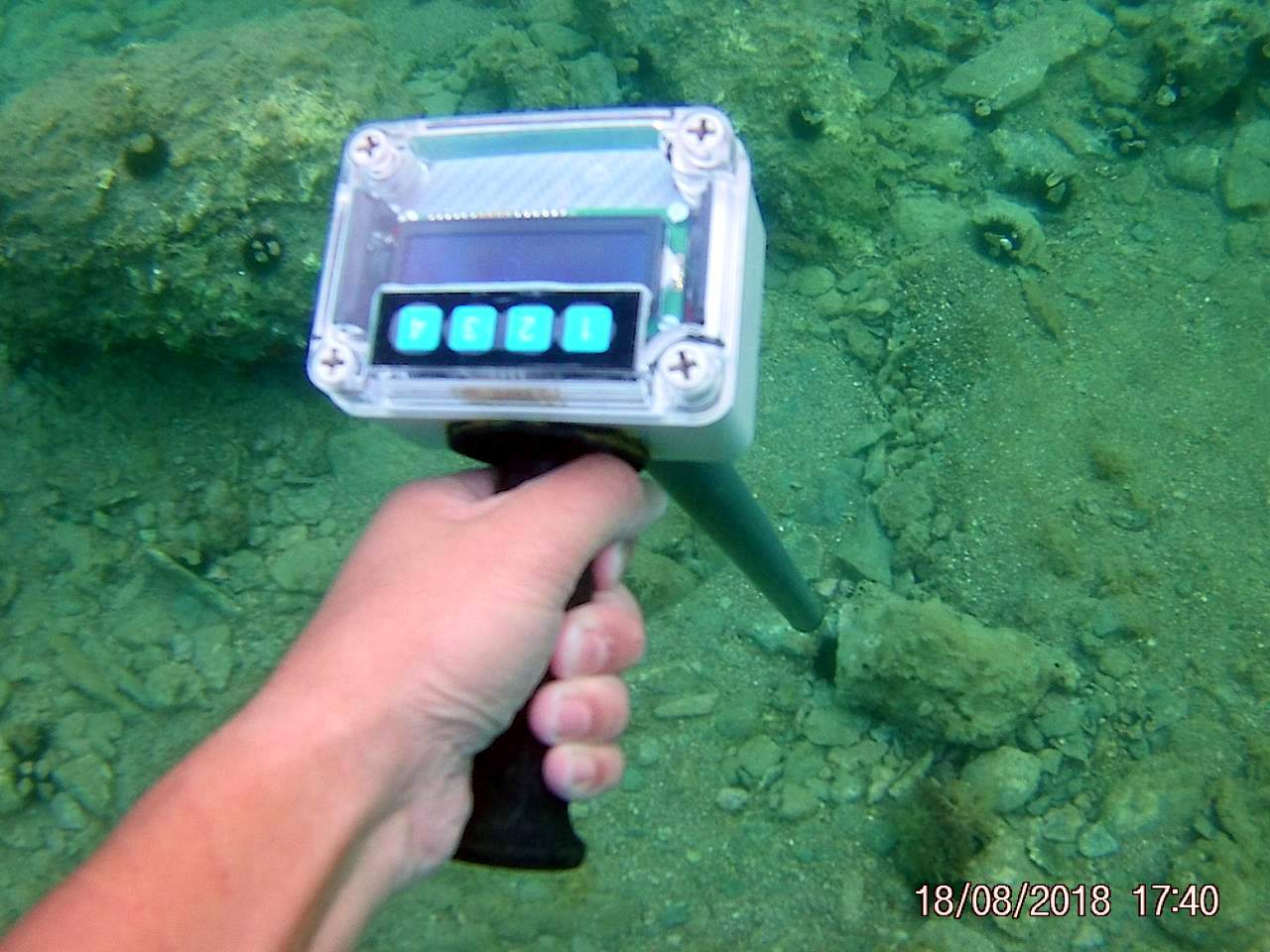

                          Prototype in action... already!

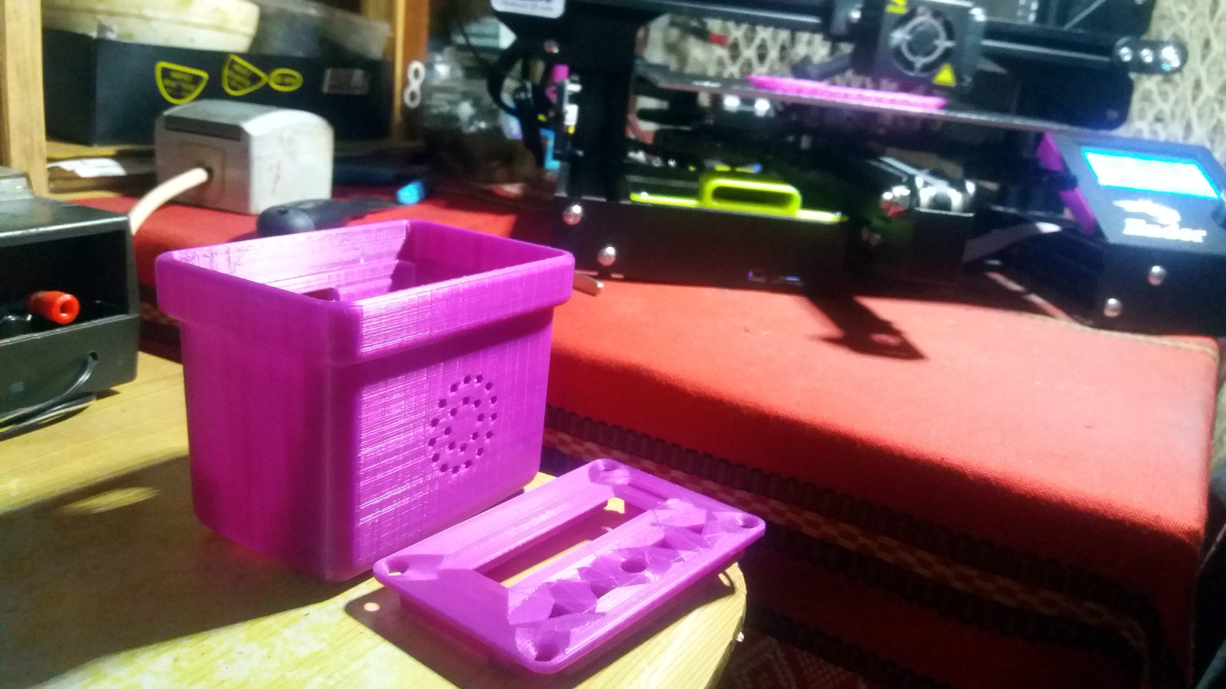

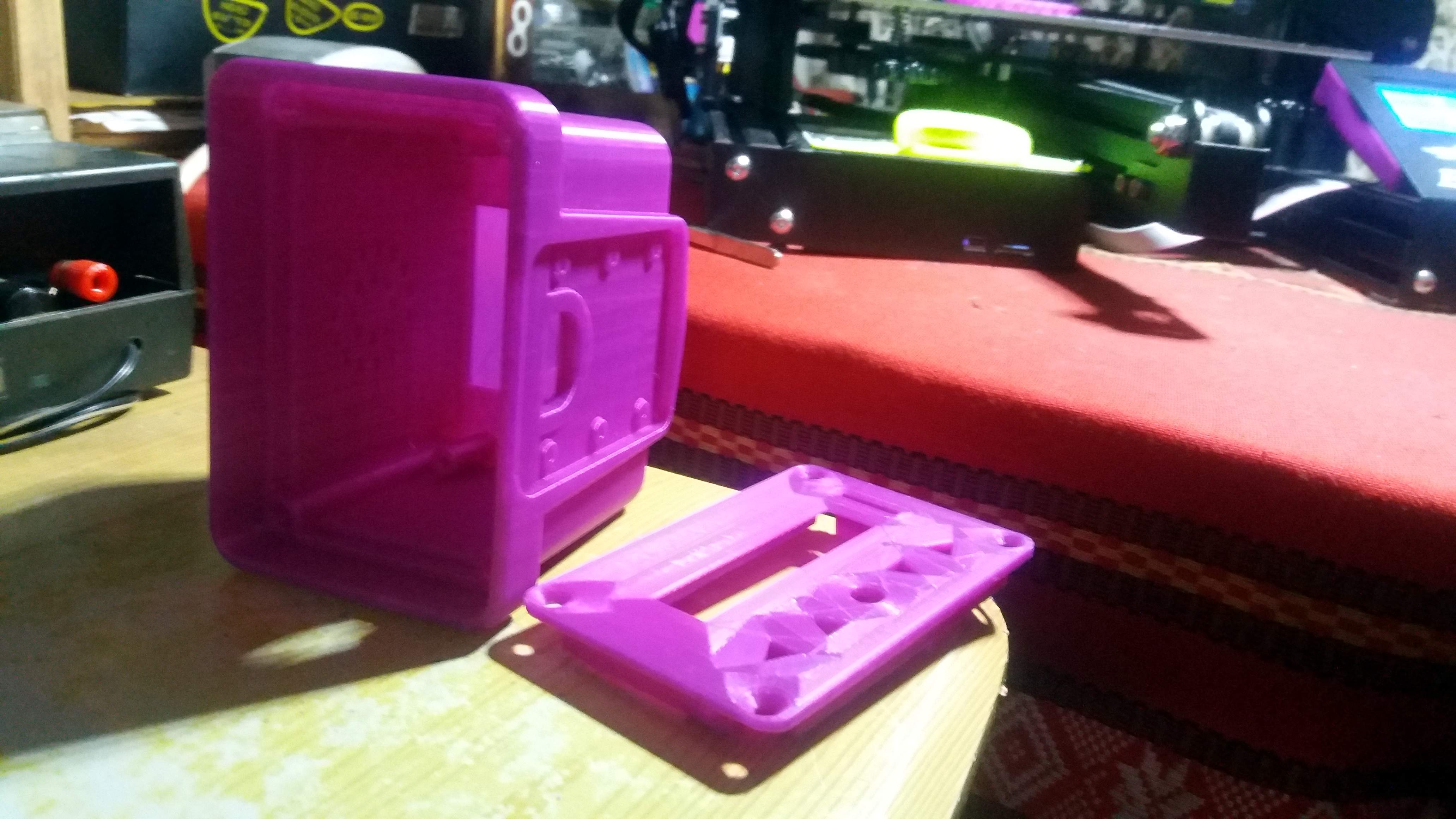

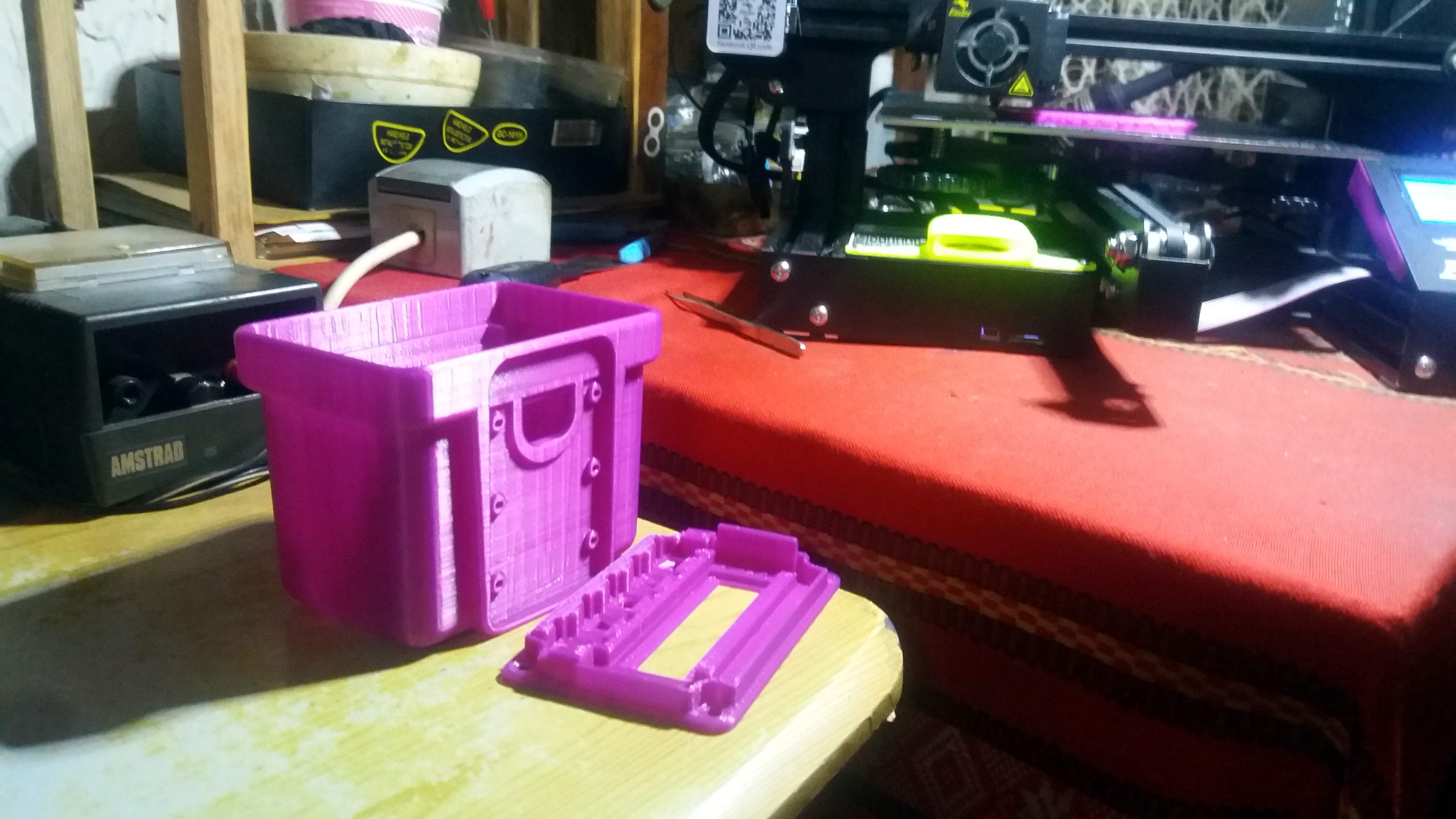

                                Trying to make "perfect" enclosure for this.
                                This was first attempt from the other day.
                                Now i am printing improved one, with some modifications and additions.
