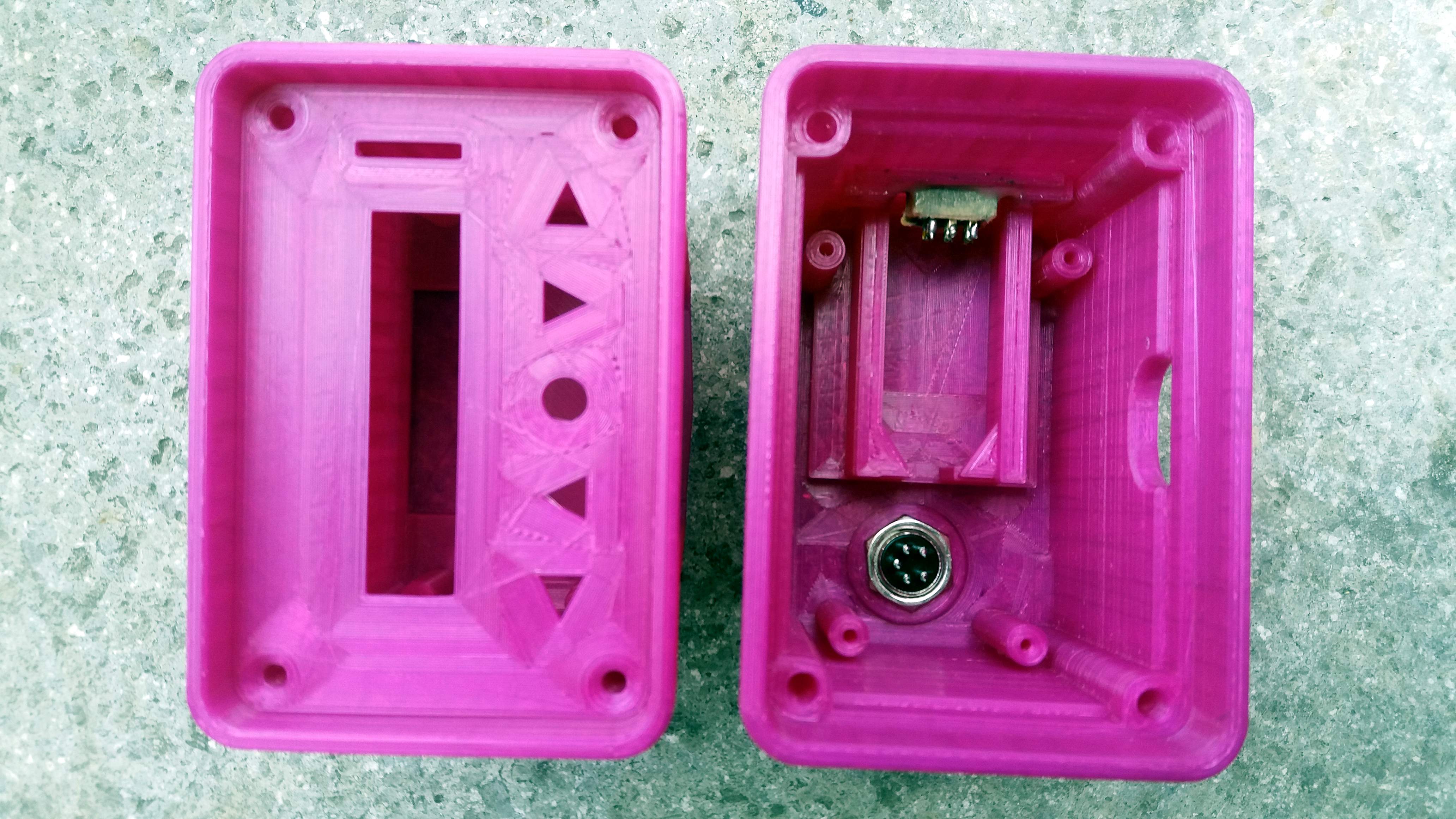

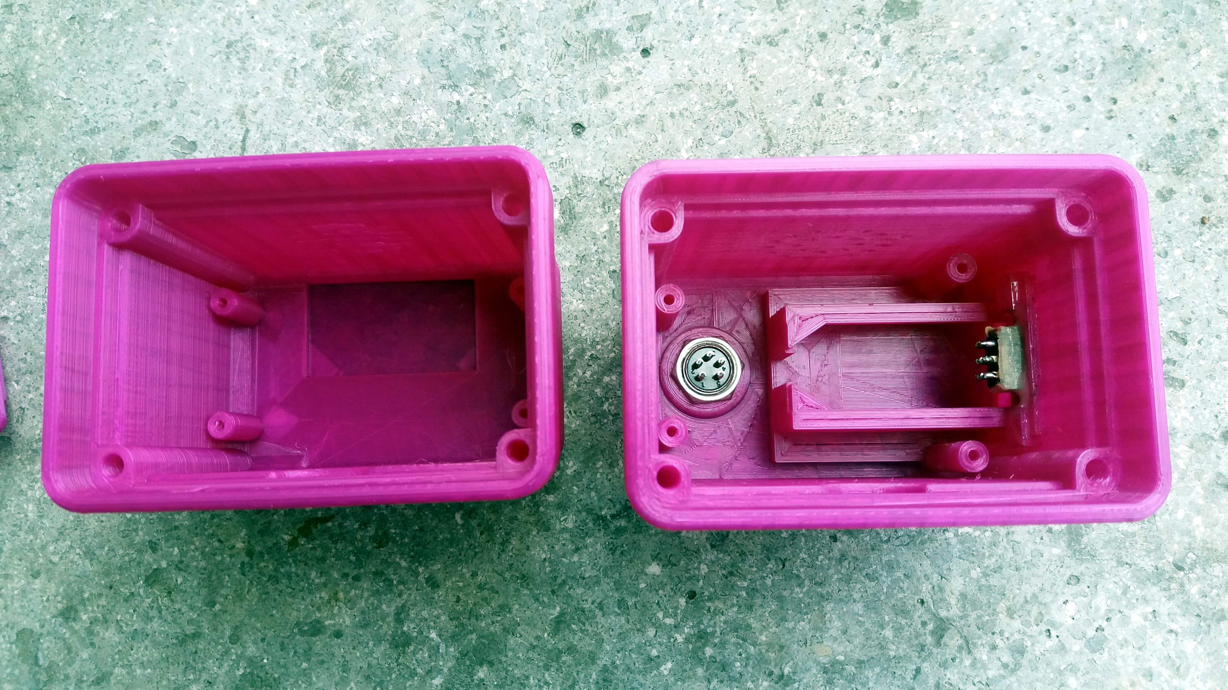

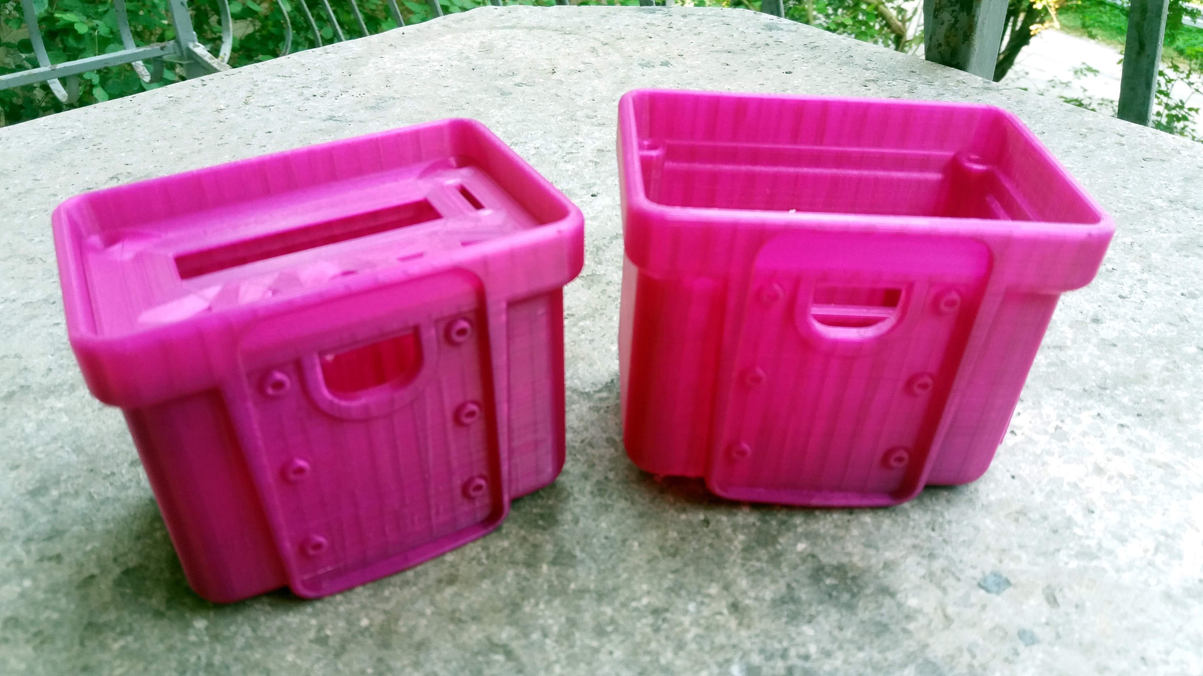

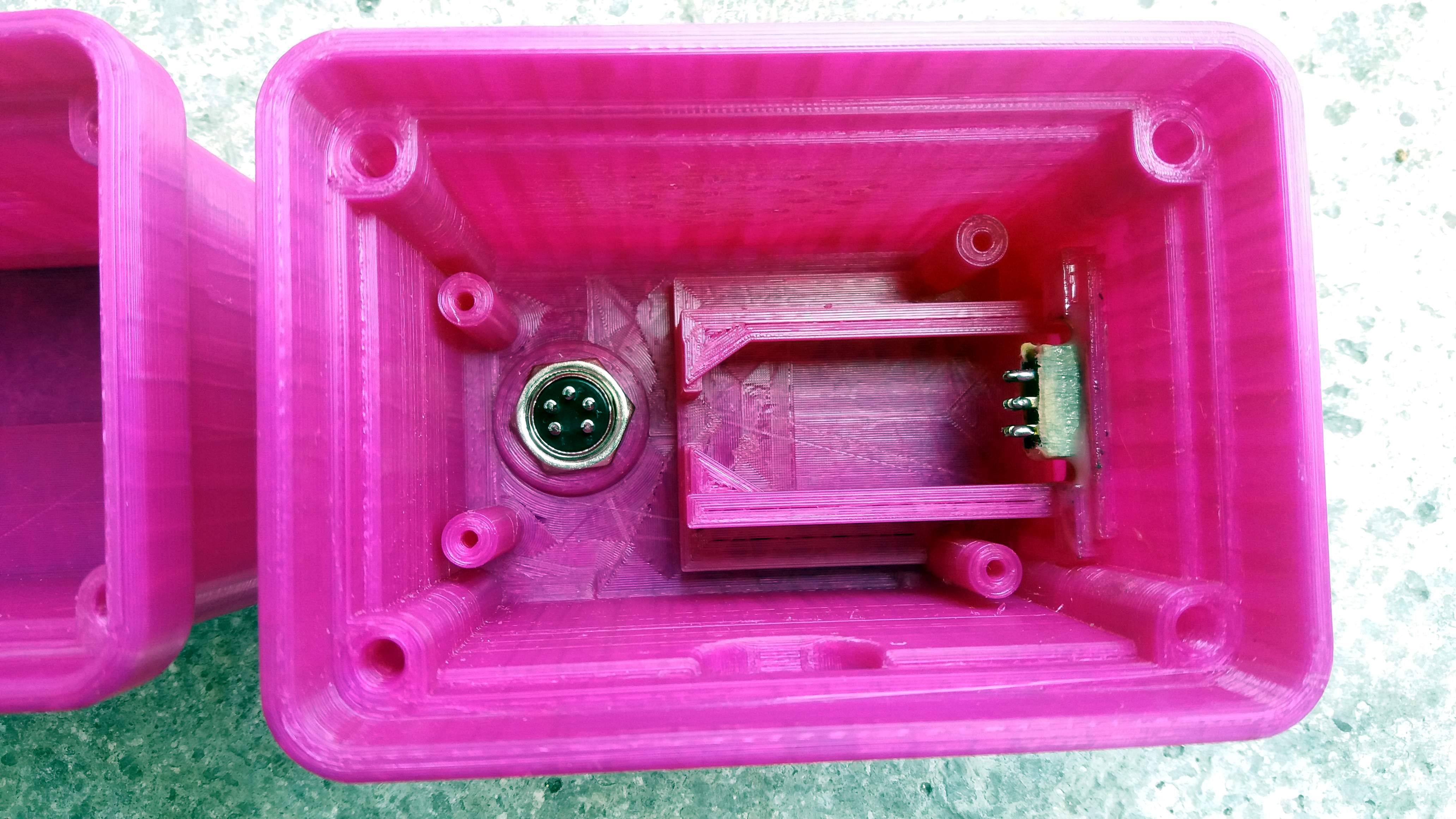

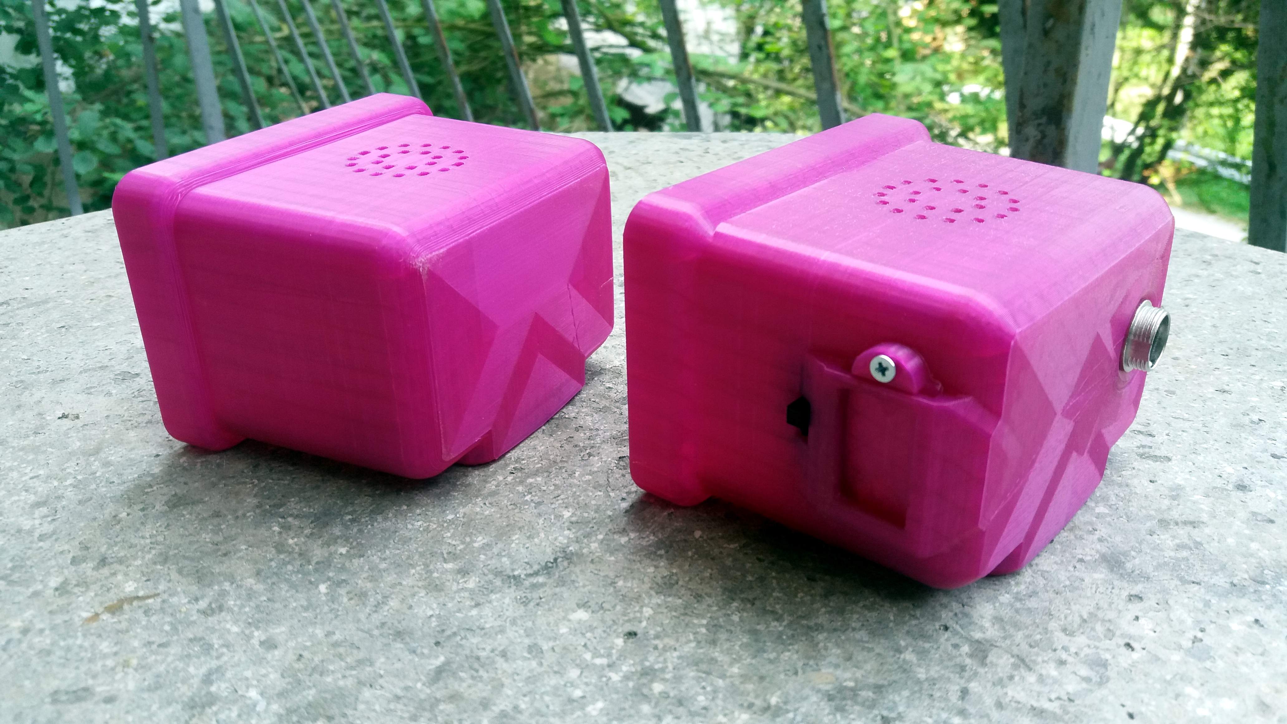

                    • #85
                      • #86
                        Nice, now obvious question, can this design be mass produced by extrusion mold or some other means, or is it unique for only printing. Maybe is dummy question, please forgive my ignorance on the subject.
                        • #87
                          I was having something similar on my mind.
                          If this thing with magnetometer/gradiometer attracts enough number of customers; i was thinking to make 3D files for each part, than 3D print them, than make steel molds for each part and than to mass produce by extrusion from ABS.
                          Later on just to add complete enclosure to kits with magnetometer.
                          But for such purpose; 3D models should be slightly modified. I don't think it will present a problem.
                          But for now; idea is to make prototype like this and to record several video demonstrations for Youtube.
                          I can also offer complete 3D files for 3D printing along with kits. So those customers who can 3D print them; to be able to print them on their own.
                          • #88
                            So i implemented BT module in device design too, so as i wrote additional code to support and run BT with device.
                            Than i tested power consumption of whole setup. Interesting thing happened and i don't have a clue about it?!
                            With BT "ON" but not paired yet with outer world; whole device, magnetometer, is consuming ~50mA.
                            But when i pair BT on magnetometer with my laptop; than power drain drops to ~30mA !???
                            How come!?
                            Crazy!
                            That's why i added for 9V battery inner sort of enclosure (holder) with sliding (up and down) "door" and a screw.
                            On second purple enclosure on the photos you may see it.
                            With consumption ~50mA and when paired even ~30mA; one quality alkaline 9V battery should do just fine, right?
